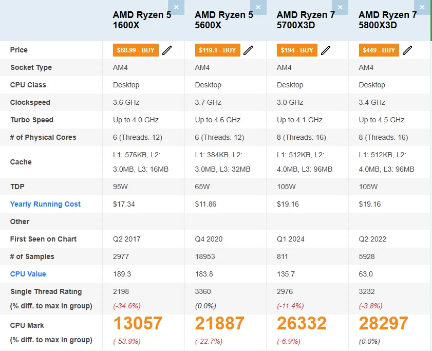

I’d not bother oc’ing a first gen Ryzen 1600x - you’re not going to see much in the way of improvements for your efforts.
Exactly this, at best you'll gain a couple of hundred mhz, for a tiny performance increase.
Better to drop in either a 5700X3D or if money is really tight a 5600X. Both will deliver huge increases in Single Threaded and Multi Threaded Performance.
(5800X3D is also a good option, but the price is normally not attractive enough for a "dead end" chip vs AM5)
