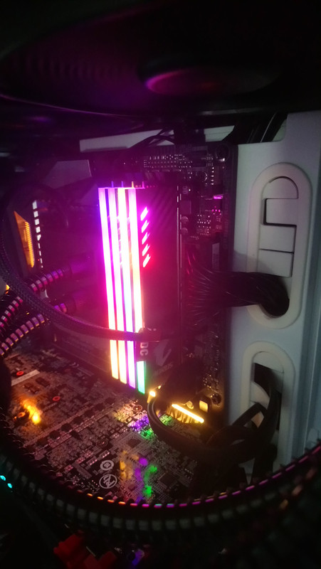

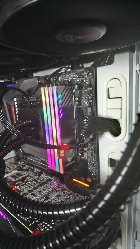

no worries, have you got a pic of the RAM? actually havent seen them in the flesh and unsure whether to use in a Build for samsung coming up for xmas display
have you overclocked yet ? quick why is just to enable M.C.E if you dont want to do the manual way and will force all cores to roughly 4.9/5ghz - temps might rise there but should hold
Here you go mate, sorry they're not particularly great pictures only have my potato phone.
