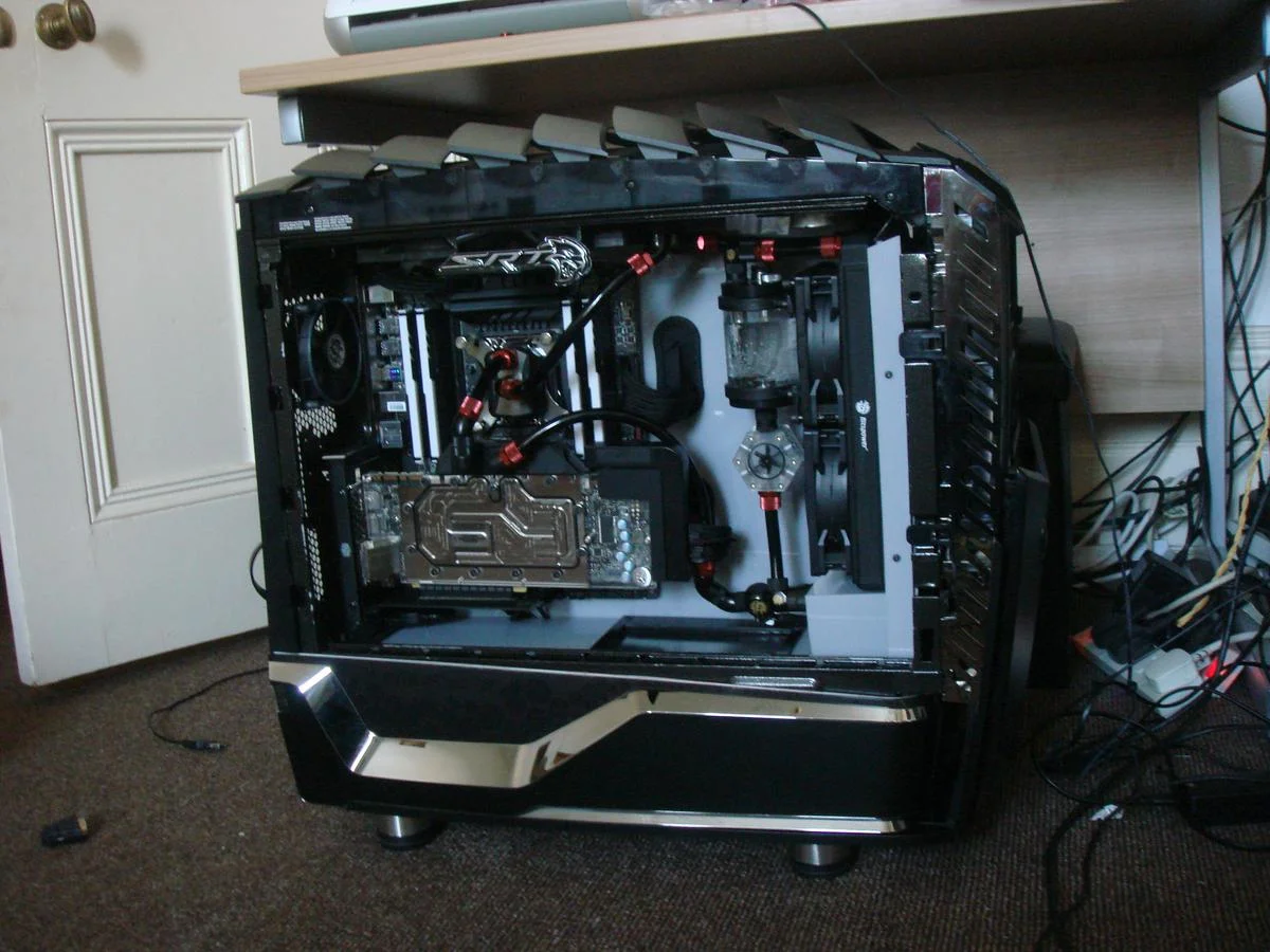

Changed to an actual camera. Still work to do, so not ordered lights and backdrop yet.

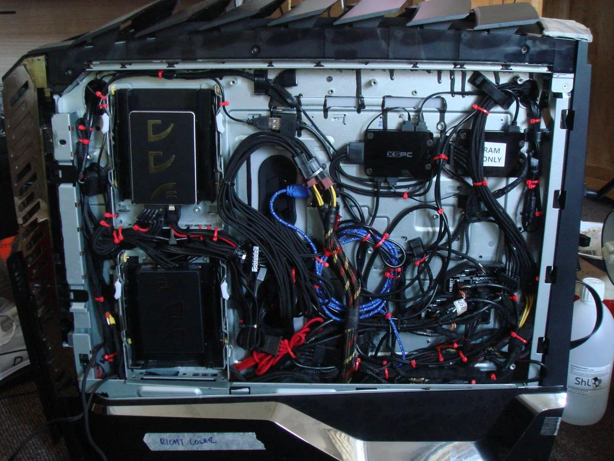

Sadly when I pulled the masking it took off some paint. I was really mad, then realised I had loads of touching up to do any way in areas I missed etc.
Still very annoying though. Wiring is now pretty much finished.

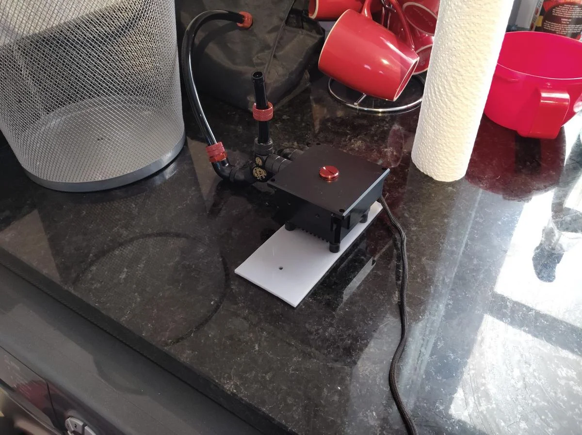

Leak testing last night.

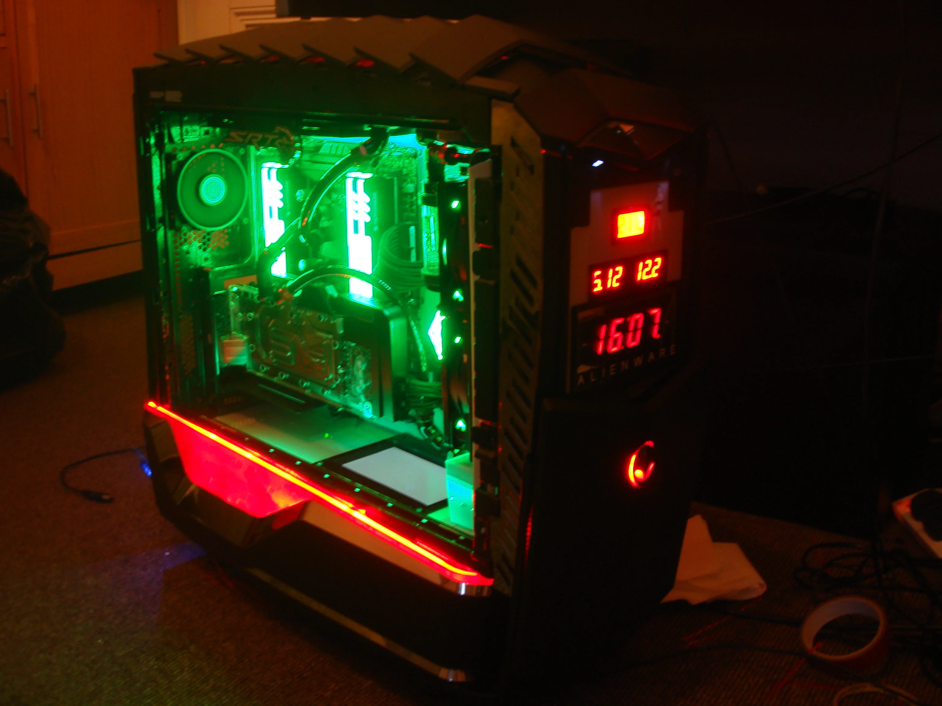

Screen is working but can't run rig on DP atm as it's on the floor. Once I get it up on the desk I can hook everything up.
Merry Christmas :D

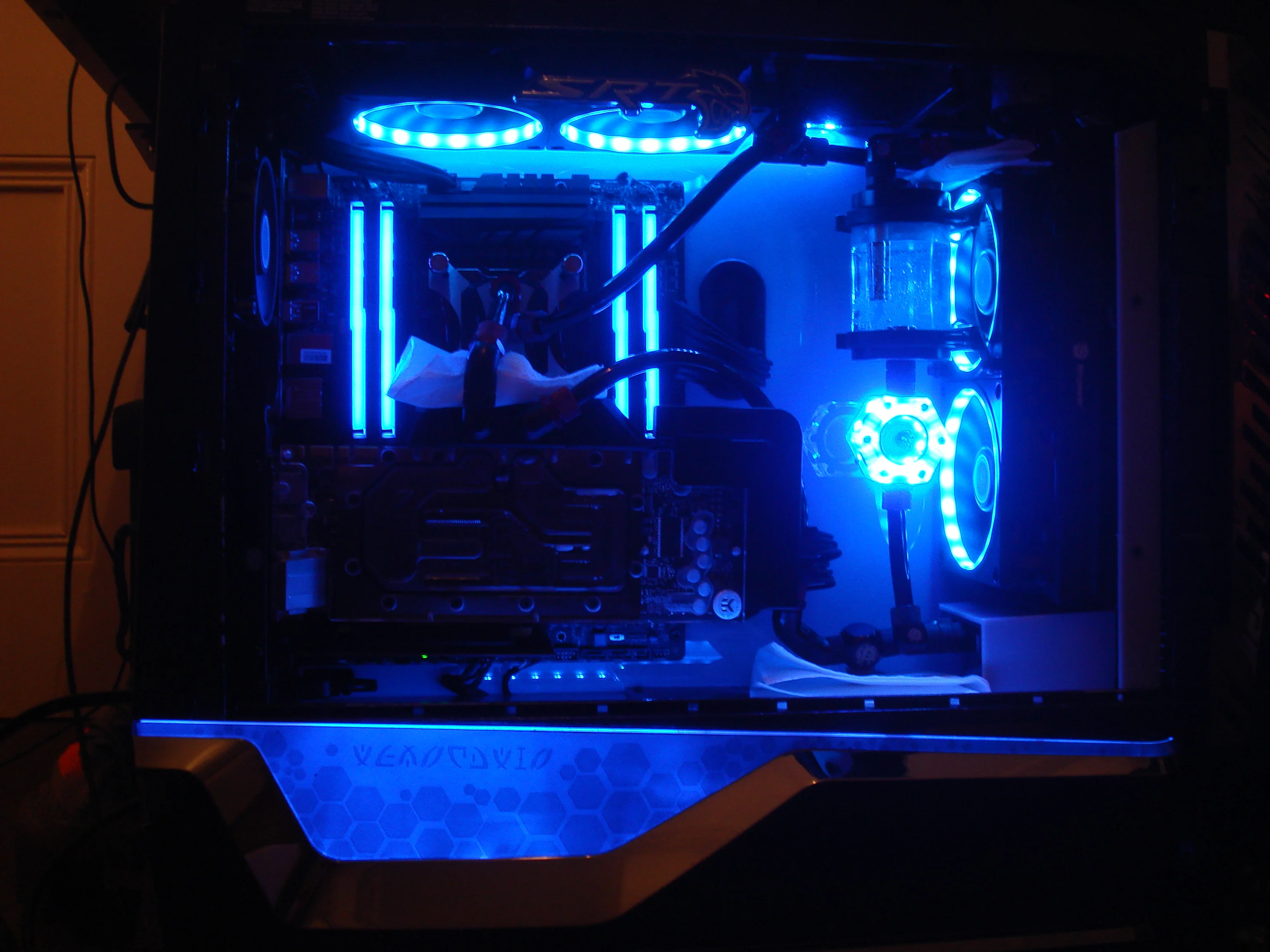

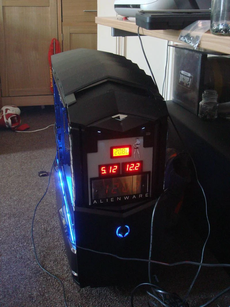

So earlier I fixed a problem I didn't even realise I had. If you look back to when I made the clock and had it running out of the PC it was about five times brighter. I figured it was dim because it was now closed in, but I had this nagging feeling that something wasn't right. I can no longer remove the front, but popped it away from the chassis and stuck my torch in there. All of a sudden the clock got much brighter.. WTF? it turns out after much prodding with my torch that the clock dims itself at night, and when it sees light it gets much brighter. I fixed that by putting a white LED strip behind it and closing it back up.
Just some paint touch ups now, then I can get stuck into the awfully expensive box of peripherals I have amassed over the last three months lol. Three months ! can't believe it !

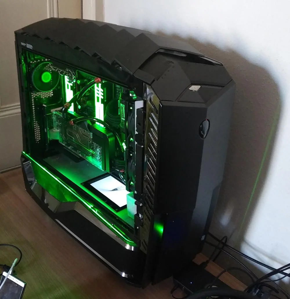

Paint finished. One of the reasons I used hammered is because if it ever needs touching up it's easy to hide. Had that been flat paint I would have been in all sorts of trouble.
I've also made a flat black IO shield, and want to make two small grey ones later today.

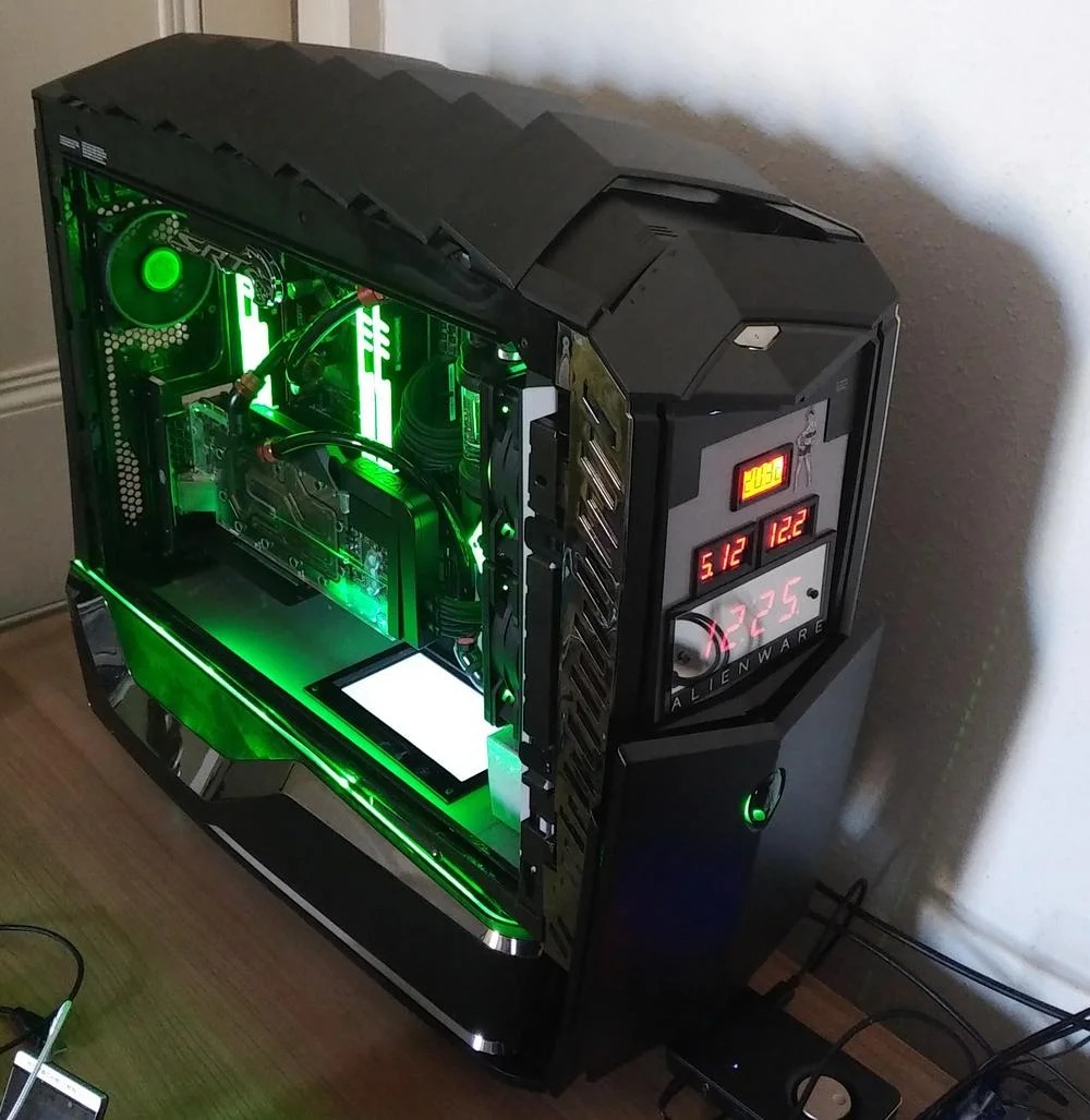

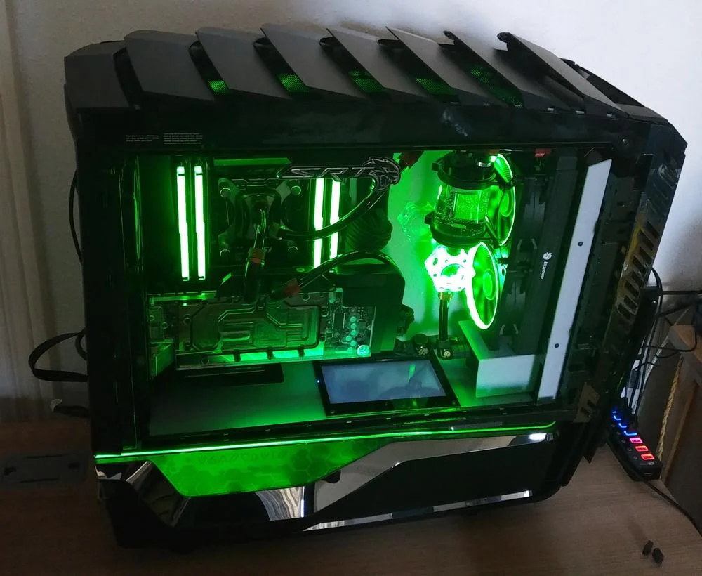

It's finished. I've also taken some photos (and a video) with a half decent camera, capable of transferring how the build looks in person into photos (almost, we all know it's actually close to impossible)

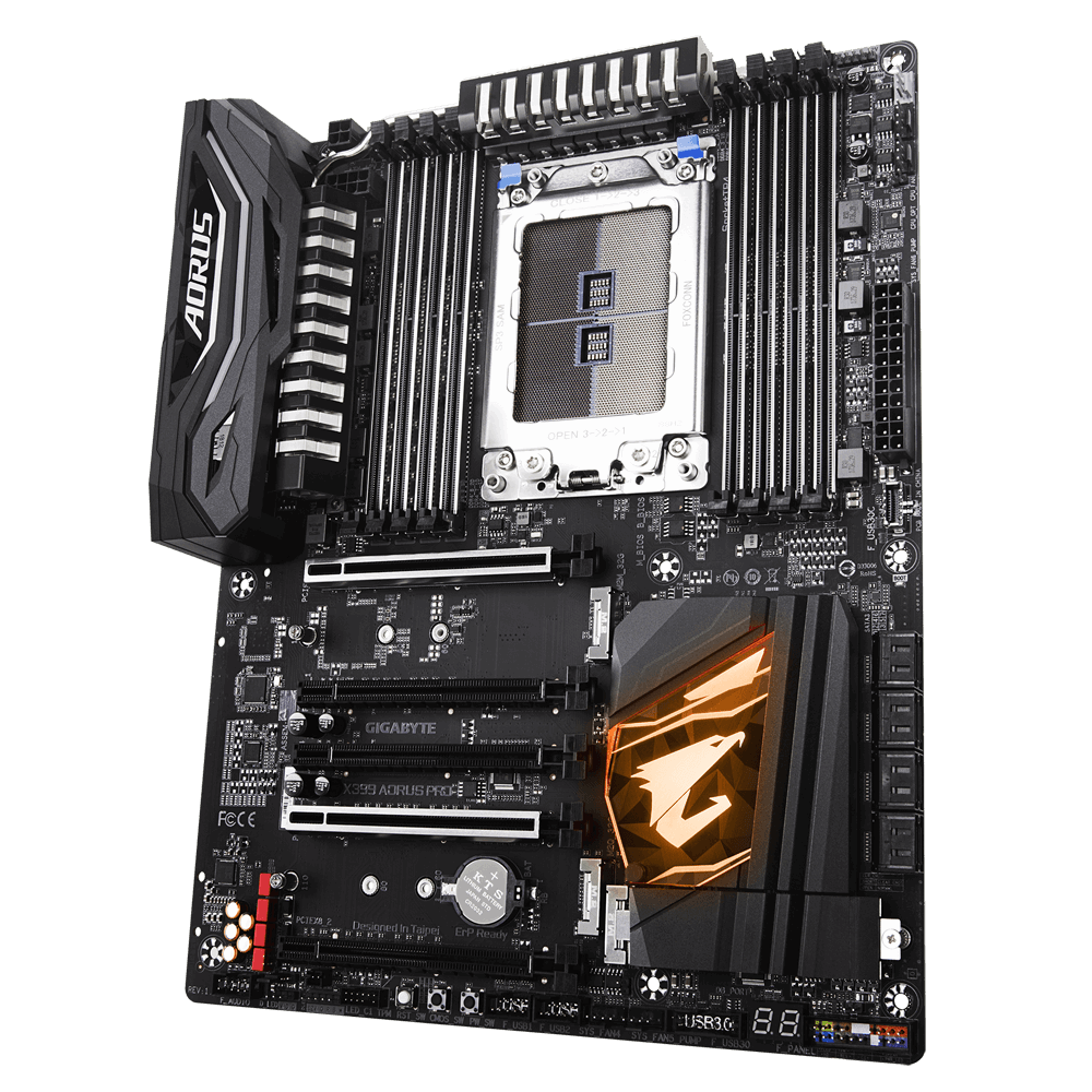

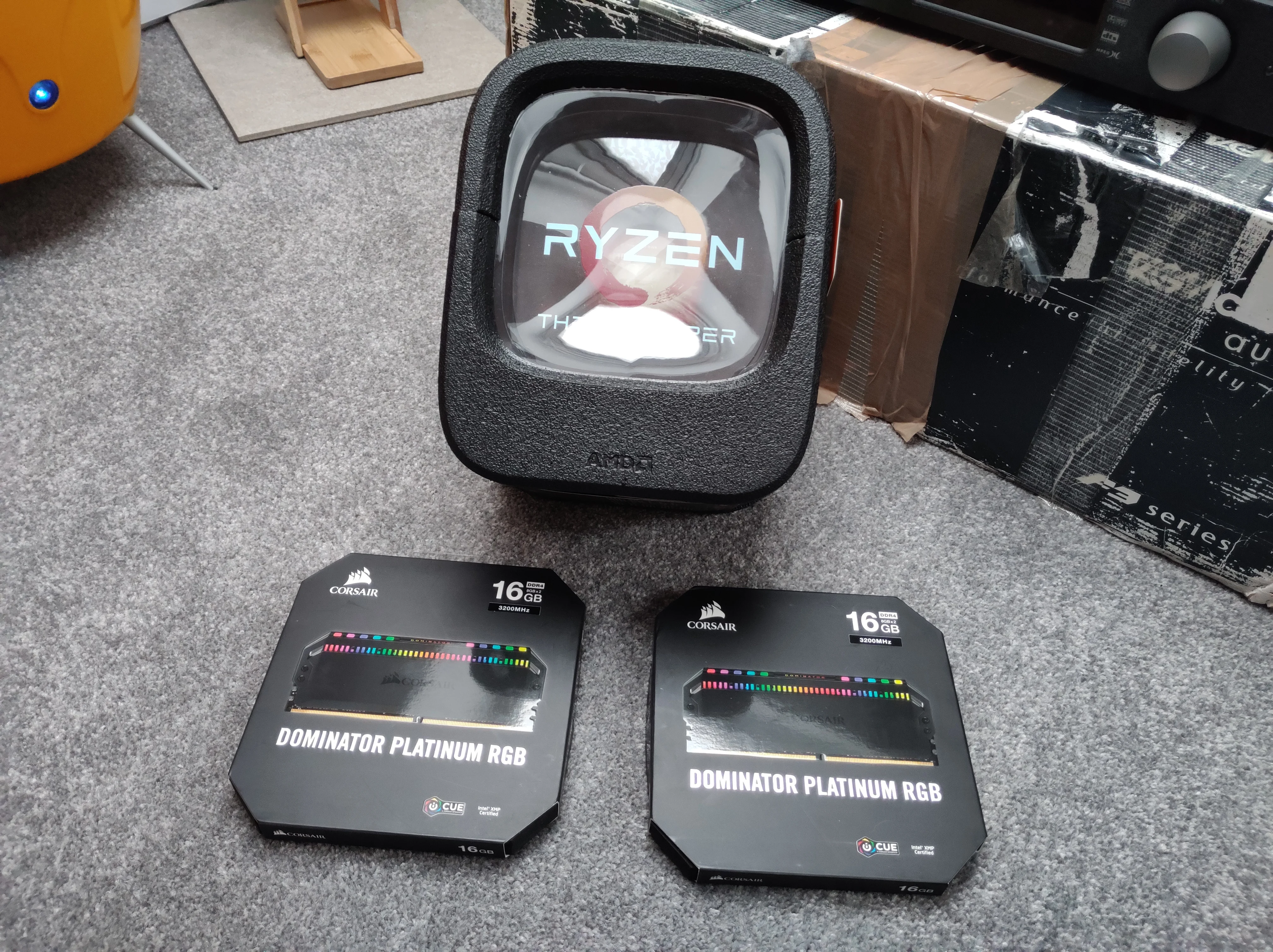

After having the board, CPU and RAM for coming up to three years (dang, it's really been that long !) it was time for an upgrade. With the TR1 prices being what they are I had to get one. £230 for a 1920x. Board stung a bit (£260) but hey, it's HEDT.
I've also ordered the memory, now that the prices are agreeable.

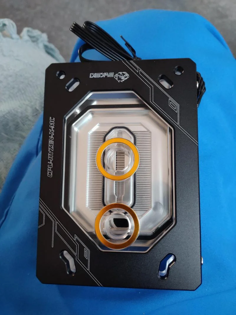

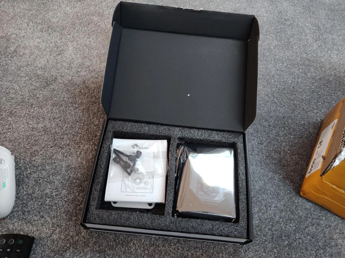

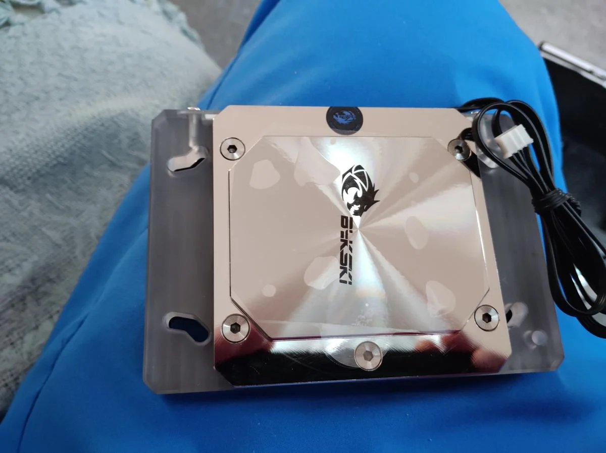

Cenedd? Cened? AKA Gareth lol was going to help me adapt my block to fit TR. But after looking at it and thinking it over I decided to stump up the cash for a block. A proper TR block. This was annoying, as if I were careless I would smash all of the value out of the 1920x by over spending on a board and block. After weeks of searching I ordered this.
Those of you that know me know that I am not a brand hooer. I simply buy what's cheap, looks presentable and works. So at £35 inc it was quite the bargain.

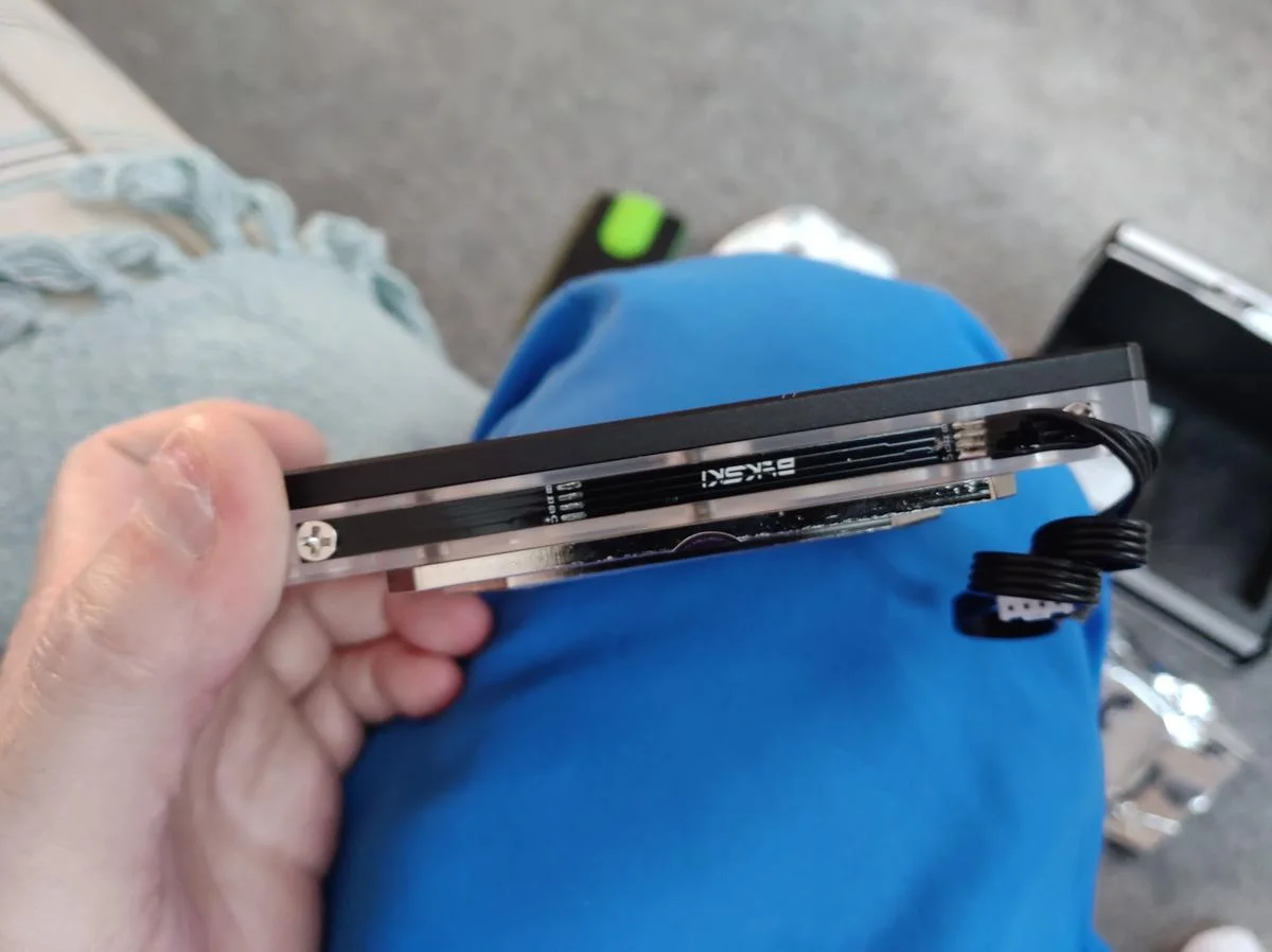

OK, so it's sorta a Bitspower rip off, but that's fine with me. The best block for X399 is the Raystorm apparently and there's a 4c difference and a £90+ price difference. Which when you think about it makes no sense as Ryzen isn't really thermal limited, especially first gen.

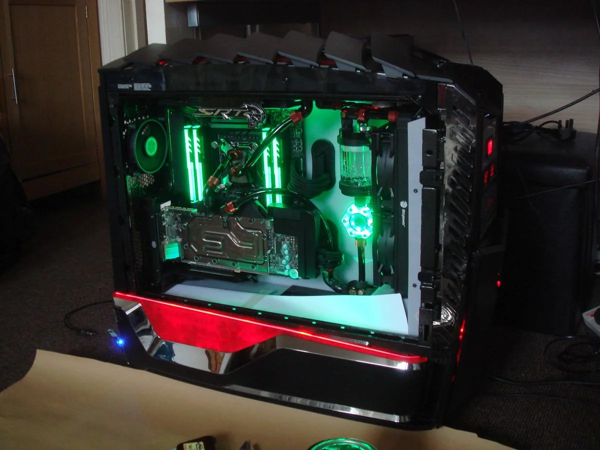

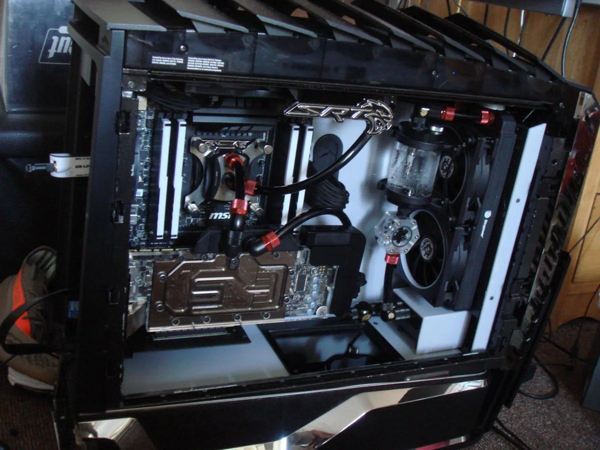

I drained out the coolant the other day and sold off the old parts.
It was a sod to build and it's a sod to take apart. It all has to be done in absolutely one order, or nothing fits. Main floor, pump board, motherboard. To get it out? reverse. The motherboard and pump have to come out before the floor can come out.
Normally I would have designed it otherwise, but tbh it's not been apart since I built it. Not even once. I have other rigs I constantly meddle with, this isn't one.

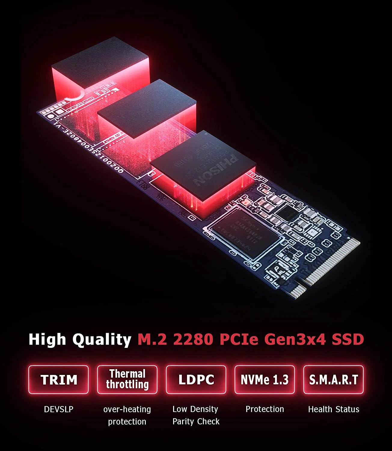

Wanted some more game storage, so bought two of these.
256gb. I am hoping to RAID them, in which case I can use them as the boot drive and my 1tb Intel as game storage. Either or, doesn't matter. It's only for my cross platform Xbox titles.

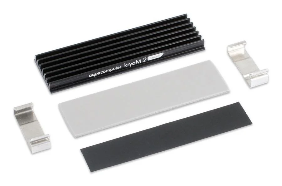

And this. The board has one built into the south bridge cooler, my Intel has an EK so this is for the other Phison.

NVME raid on TR is free (yay) but has no TRIM (what you talking bout Willis?). It's also a nightmare to get it booting, as you have to install windows first then set it up there and then it should boot. It's not bios driven it's driver driven in windows.
No trim means no os drive. So I'll raid it for the speed Lols then use it to hold the three cross platform Xbox games I play a lot.

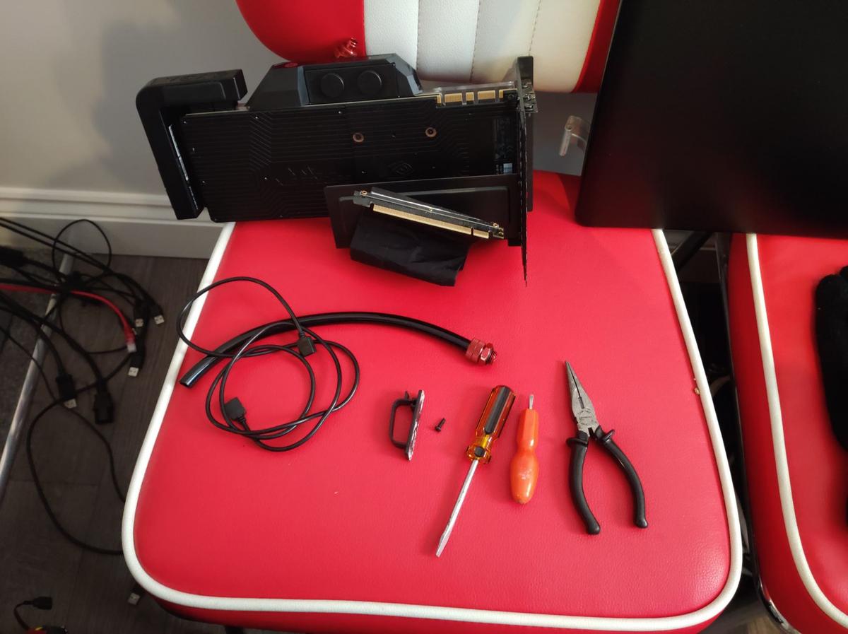

A guy from another forum came over Saturday to buy the board ram etc. I put a towel down in the rig and put a jug under the GPU rotary and removed it. Didn't spill a drop so I removed a cap from the res to release the pressure so the lower loop could drain. Went very well.
I then opened up the other side of the GPU and inserted my blow pipe. It's on the chair in the pic there. I blew info it *hard*. This was with one pipe in the jug and the other half in my mouth.
Sprrrrrrp. Only some div had forgotten to put the cap back in the res and so I was treated to a fountain and free facial. What a Wally.
That's why the screen is all apart, as it all ended up right in there. What a clever place for me to have put that. I noticed some coolant had gotten between the 3mm clear sheet and screen surface so I took it apart and left it all drying.

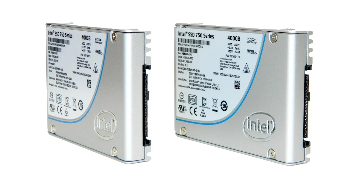

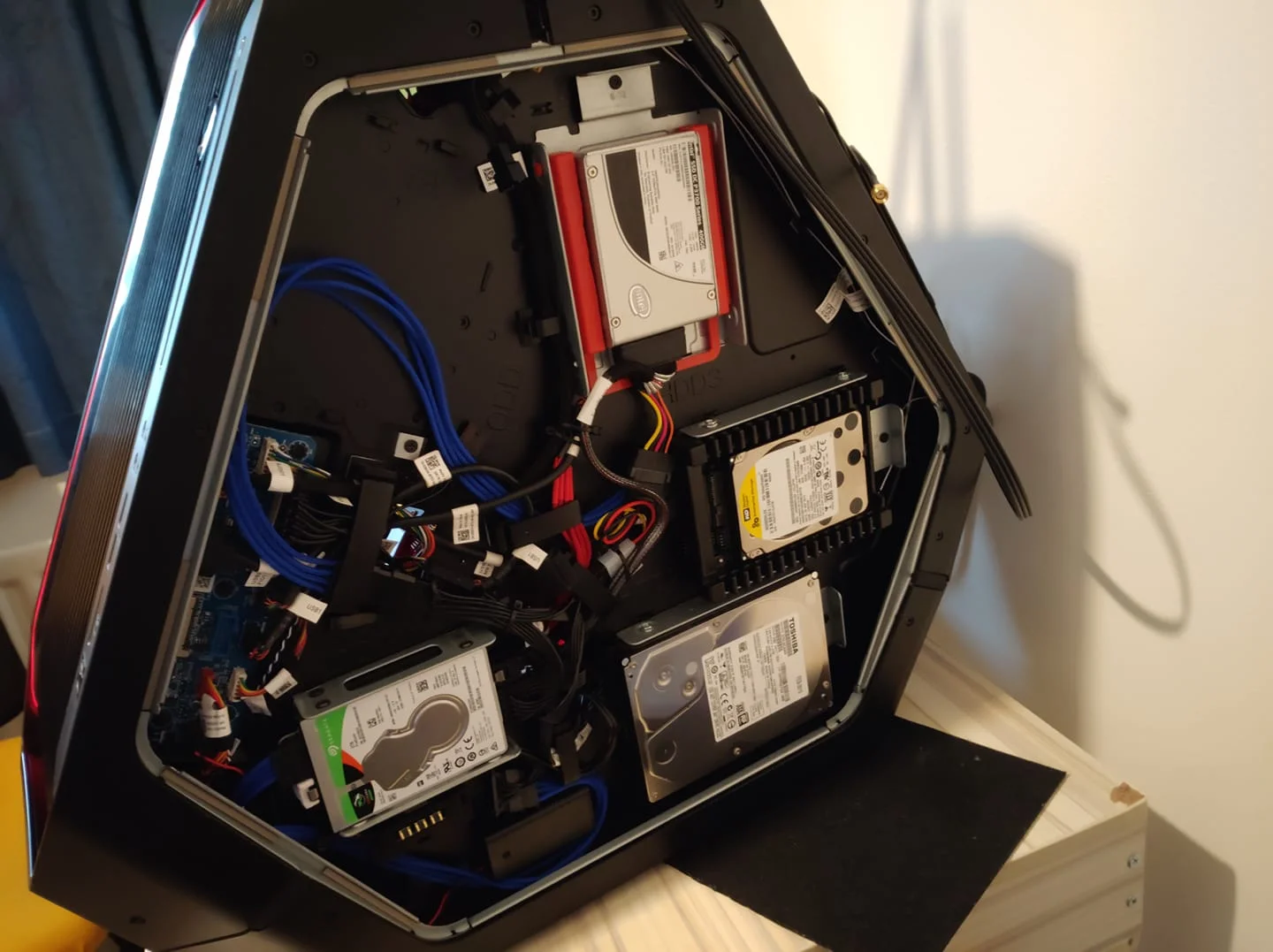

What I am doing, though, is at some point bringing my Intel U2 device to the party.
It's 400gb, 3500 RW and what I didn't know was that they are basically the most reliable drives on earth bar none. That's the sorta drive I want for my OS tbh.

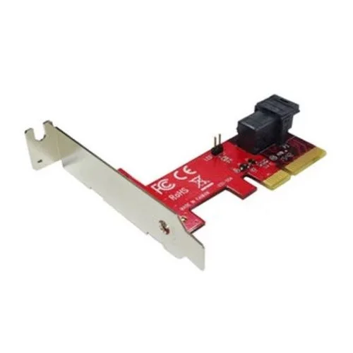

My M.2 card is out, as they'll all be full however once I make a confirmation there's a £20 pcie card that can make use of it. If it's the right one of course. It also uses four lanes, but when you have over 60 who cares right?

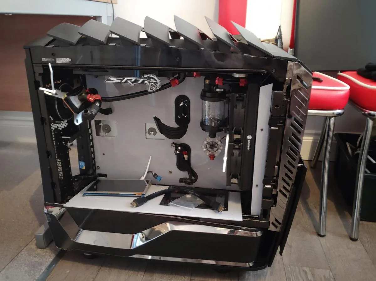

Won't fit. Vertical GPU.
I'd get away with the card I'm thinking of because it's low profile and I have a spare riser ribbon.
Remember, U.2 are x4 pcie but connect via a weird cable. They're sata SSD shaped but have a huge alu body like a heatsink.
I'll pop up and upload some pics in a minute.

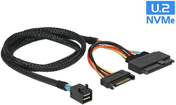

OK this is the drive I have.
It's not a SATA connector. You use this cable.

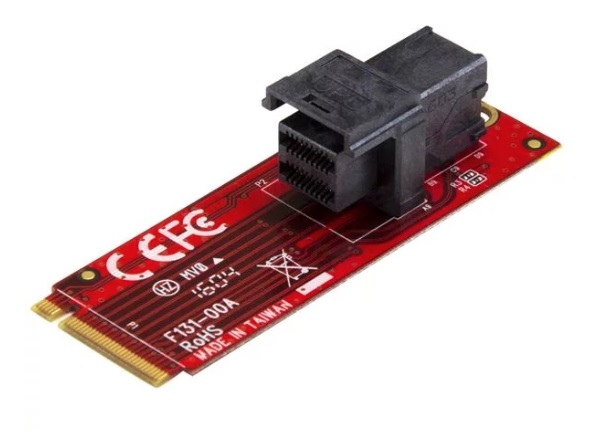

Which I am hoping is mini SAS. Then you connect that to this.
And put it in an M.2 on your board. Problem is mine will be full. I am hoping this is the correct thingermejig.
'cause it's only twenty quid. It says what I need it to say, but I want to just check 100% before I go ahead and order. The U.2 is currently in my triad rig (I'm literally typing this from it) but so is a 240gb RAID 0 SATA SSD stripe that's more than good enough for the OS on this PC. So I wanna pop it out and put it in Time Sync (well, the hell cat).
There you go, that's it there. Being an ES I picked it up really cheap, but man alive it's fast. I got lucky too, 'cause those cables are £45, and the M.2 adapter is £35. I had the adapter with the MSI X99 Godlike (thank god !) and the guy who I bought the drive from sold me a cable for £15 which was a blessing.
