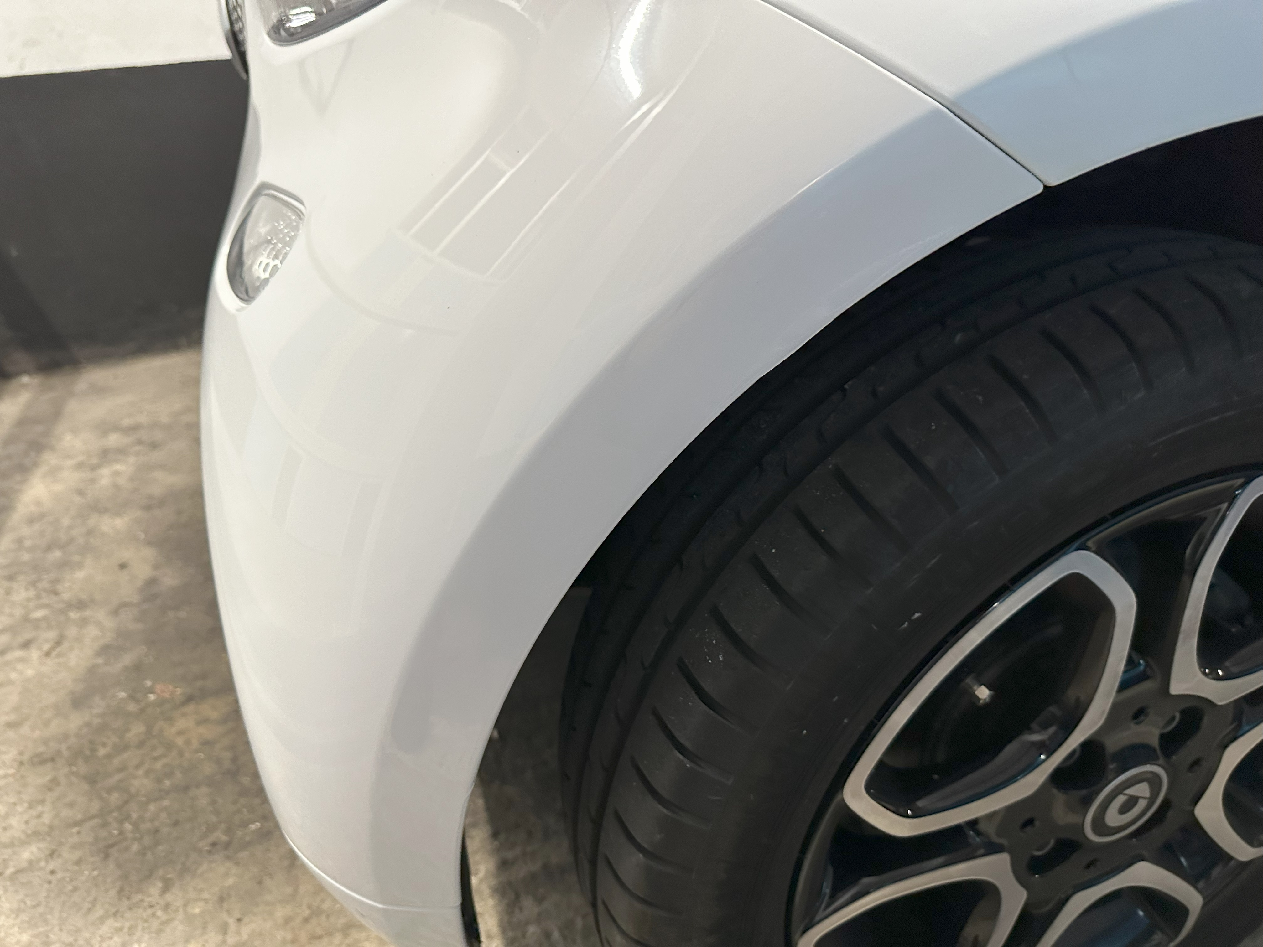

Here's mine so as not to disappoint.
Before...
Smart repaired and £120 later...
Under trays, before...
Repaired and £344.12 later...
