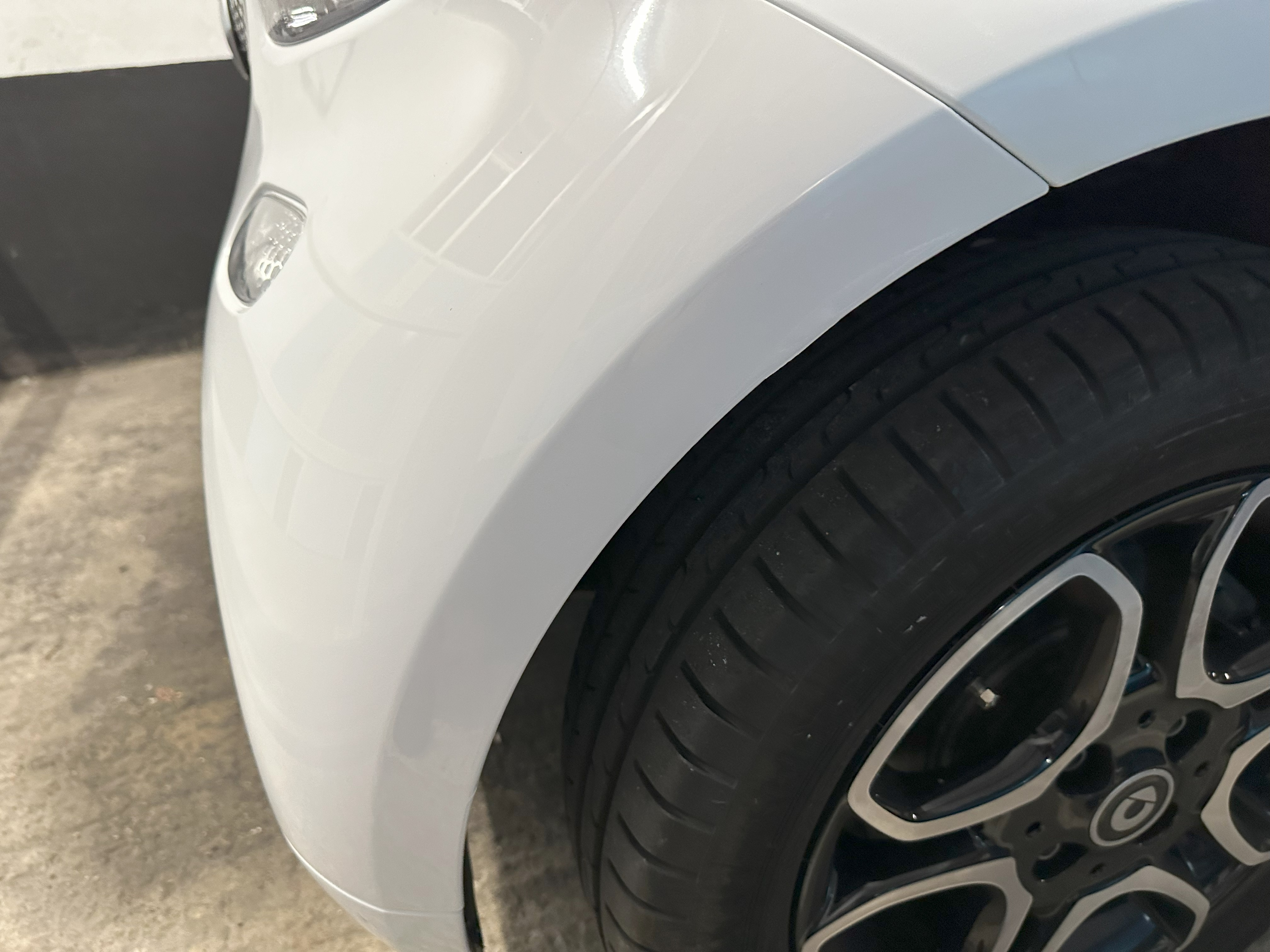

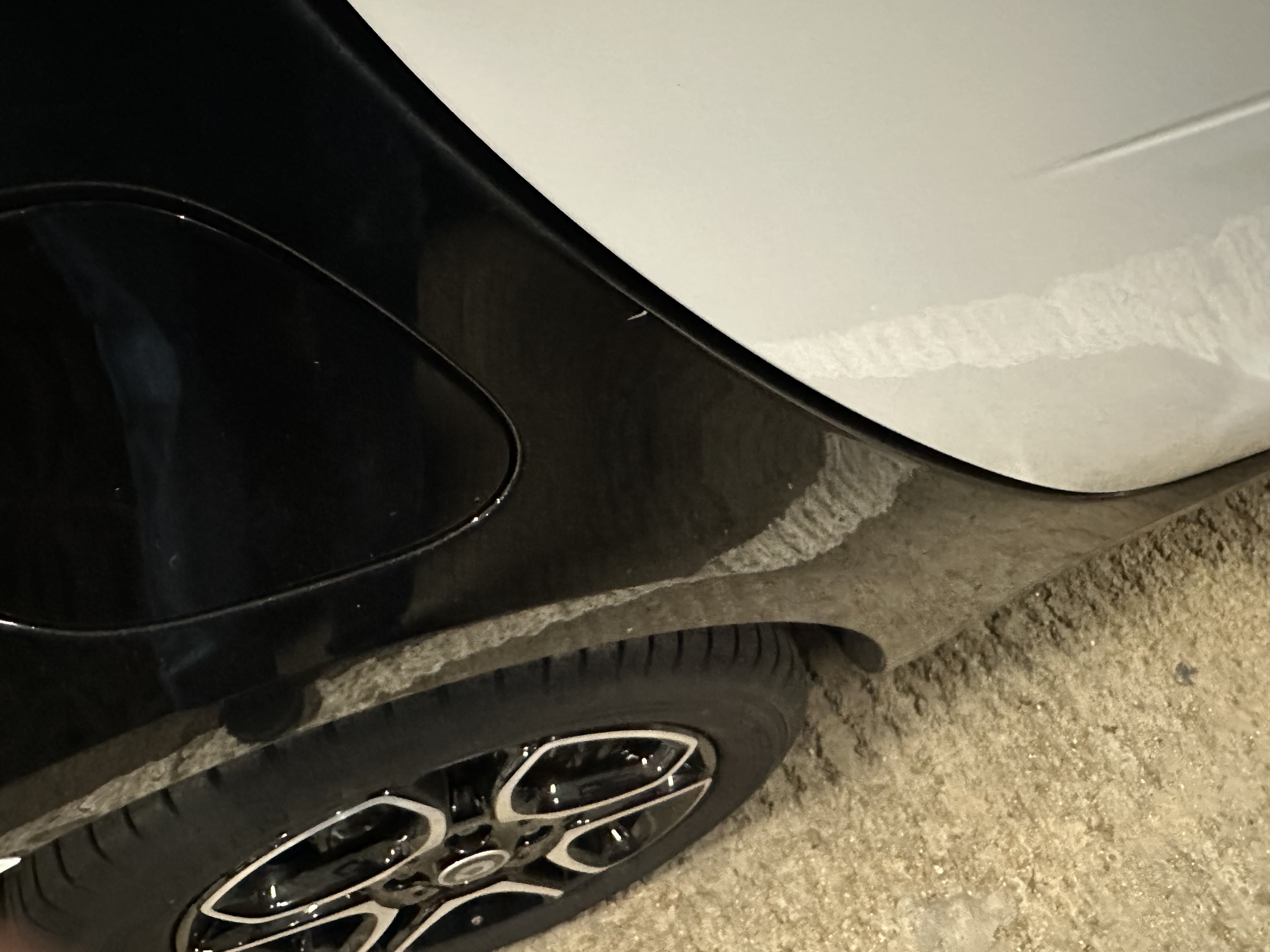

Here's mine so as not to disappoint.
Before...
Smart repaired and £120 later...
I can see why it was £120 :P

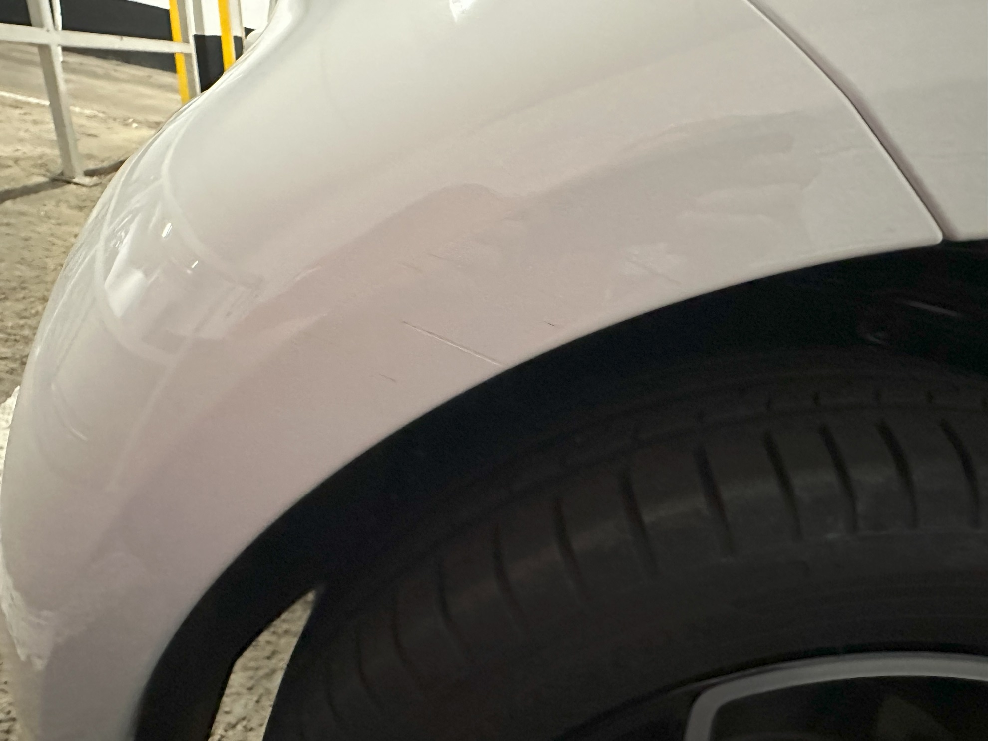

I was happy with it. Today just noticed a new 1cm scratch which has appeared overnight when I haven’t driven the vehicle since Sunday. Must have been one of my neighbors and I hope not deliberately.
