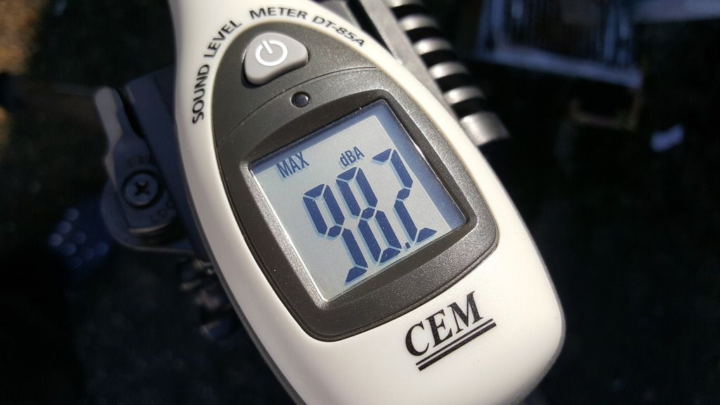

I've tried Googling, the problem is, many Mustangs have many different exhausts and different setups generally. From what I can see it will be floating around the 100-105db mark.
I do have a sound meter, I'll try at 1m (that's what I'm hearing from others) and a 45 degree angle and see what I score. Right by the pipe was 115db. Thought this might be just inaccurate. Didn't realise they did it from a distance.

Looks like setting it up 1m away, 45 degree angle means I am more inclined to believe my sound meter and perhaps I'm worrying over nothing.
Twice at around 5,300rpm.
Go to your nearest track and ask them nicely to test it for you. Don't even bother trying to use a phone they are hideously inaccurate.
edit. Just seen you have a meter of your own, nothing to worry about then. They do tend to measure at the same height as the pipe at an angle if that makes a difference though.
