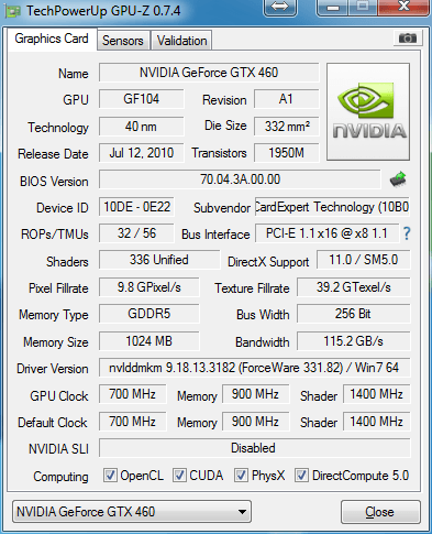

GPU-Z 460: http://gpuz.techpowerup.com/13/11/27/2dn.png

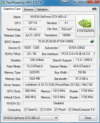

GPU-Z 460 v2: http://gpuz.techpowerup.com/13/11/27/b97.png
The GPU's are at different speeds so I wonder if this is the cause. I would prefer not flashing them but if this was to work

It looks like your cards are not compatible, one is GF104 and the other is GF114
Using Coolbits may help
I may be out of my depth here but, this is the only thing I could come up with
Like whyscotty said:
GTX460 V2 GF114 = 192bit bus
GTX 460 GF104 = 256bit bus
And therefore you can't sli them.
