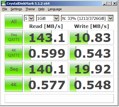

I have run some benchmarks to show the difference, and the sequential transfer is equal to copying large files. It takes days to populate a 4TB hard disk.
Unencrypted WD Red 4TB on LSI9207 controller
Encrypted WD Red 4TB in lsi9207

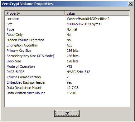

These is the benchmark to prove AES is enabled.
And here are the settings for the encrypted volume
Has anyone else had a similar problem, I must have ruled out hardware as drives and motherboard / CPU have all been changed. So there either must be something I am doing wrong or this is normal for TC / VC. I have tried formatting the drives with different cluster sizes, and have tried whole disk and container volumes, the speed is always impacted like this.
