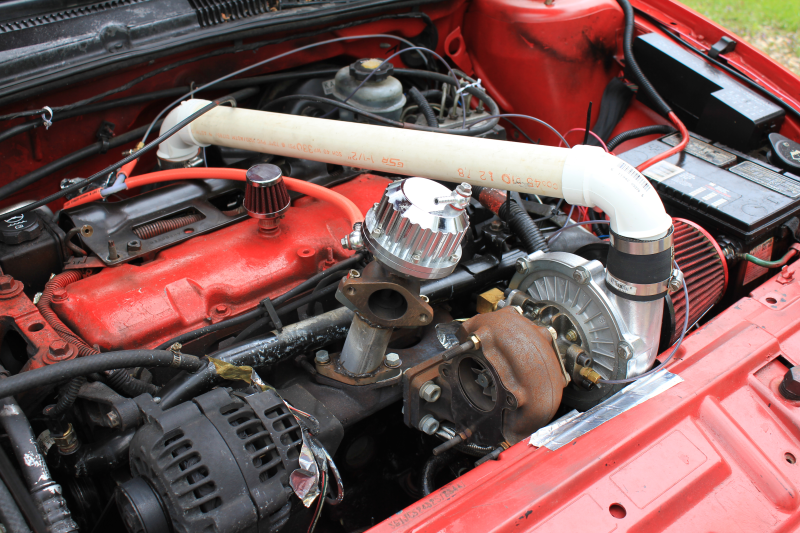

So I happened upon this post from ls1tech forums... :eek:
There are no words to describe....
I...uh...
...I know this person.
I've been trying to guide him through his turbo kit install so he does it properly and doesn't blow up his engine. Obviously he didn't listen.
This is on stock fuel, stock tuning, nothing is changed.
He's running something around 8psi on an eBay 50trim. I can't believe it hasn't thrown a rod yet.
The exhaust is melting the alternator wires.
Yes, he drives around like that.
Yes, that is the turbo oil return line going into the dipstick hole...
:eek::eek:
Talk about ghetto, the is no downpipe on the exhaust, the turbo to intercooler (think I may be being optimistic by assuming the is an intercooler involved here) pipe is plastic drainpipe. The is a hole cut out the bonnet so everything fits (would be illegal to drive round like that in this country). And most surprising of all he used one of those cheap china ebay turbos and it works lol.
I'm amazed that a) PVC drain pipe is capable of withstanding 8PSI at high temperature, and b) It's not running so weak that it simply misfires as soon as it comes on boost.
He even has the core mounted 90 degrees out for good measure. Oh well, it'll likely be a burnt out shell soon enough.
3" PVC (hur hur) can endure up to about 100psi at 80-odd degrees C (and higher temps at lower pressures, etc), so it'll probably last. Depends on the thickness, though.
I read through the thread and it seems it has already melted and been replaced with aluminium.
Standard PVC drain pipe gets very soft at 100 Celsius, IIRC it's not rated for use above 60 Celsius (and drain pipe is obviously not rated for any pressure applications).
Sorry dude I think it was me that refereed to it as drain pipe, its more like the stuff you get for hot water piping, like dishwashers/washing machines/sinks/etc.
Lol he actually tries to fix it later on ^^
