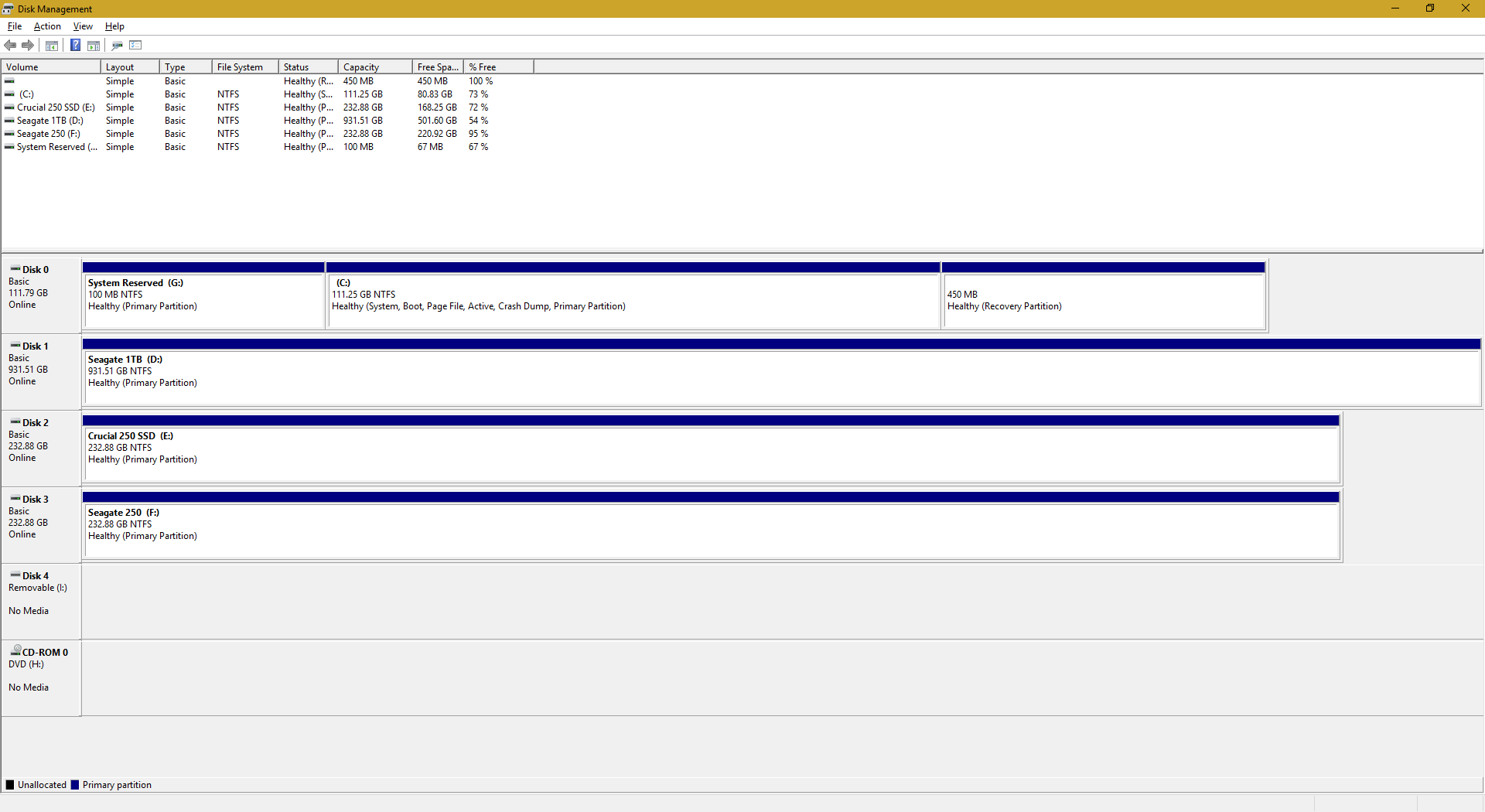

when i tryed the disk managment i clicked on the drive and it stoped responding and than i got this

Thanks for taking the pic Josh. Trouble is the window is not maximized so can only see the info for two of the disks. But from what can be seen, the Page File seems to be on the wrong disk (on Disk 1 D: instead of Disk 0 C:). Systems can usually happily function with the Page File on a disk that isn't the C: but it should be on the SSD really, unless you consciously moved it for some reason.
The other thing is that Disk 2 E: is RAW not NTFS which means it's corrupted/on its way out, unless there's another explanation.
