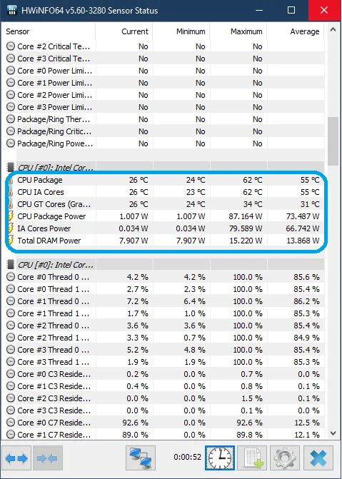

This is a Cinebench run with Windows Power Option Maximum processor state to lowest possible (800Mhz). Didn't fancy going into BIOS and changing anything right now.
https://imgur.com/ZvIOP88
And this is with 4300MHz:
https://imgur.com/Bm9nynz
Memory seems more of a power problem than CPU when in such low states. :)

When you add the IA Cores draw, it gives a more accurate idea, even though still software and not 100% trustworthy. Around 167W cpu package + ia cores combined does seem pretty realistic though.

Yes. 1.296v. It's not a great chip. Need around 1.345v for 4.4 stable, and 1.395 to pass a few benchmarks at 4.5 but isn't totally stable.
your 4770k seems to be a better sample than mine when running both full tilt and underclocked power draw wise. HWINFO is reporting an idle watt draw for package alone of around 17watts @800 core clock with a peak of around 27 watts full tilt in cinebench. This is with factory defaults in bios loaded and then every c state enabled. My ram however is apparently only draining less than 5 watts @ 1866mhz 9-10-9-27. Only difference is likely our boards and i can see you are using HWINFO 5.60 where im on 5.59. So gonna update and see if readings are different.
MSI Z87 MPower Max. Four sticks mem @ 2133MHz 9-11-10-27 1.65v. Balanced power plan. Adaptive voltages in BIOS. C states enabled (the default ones).

Could well be. Check LLC. As for memory, you have two sticks, right?
Oh, and my Cache voltage is Adaptive too (and frequency fluctuates from 0.8 to 4.2), that might also be a difference. I've messed with it a lot, Fixed/Adaptive, seems to make no difference in this instance, but could be pulling more power if Fixed.
