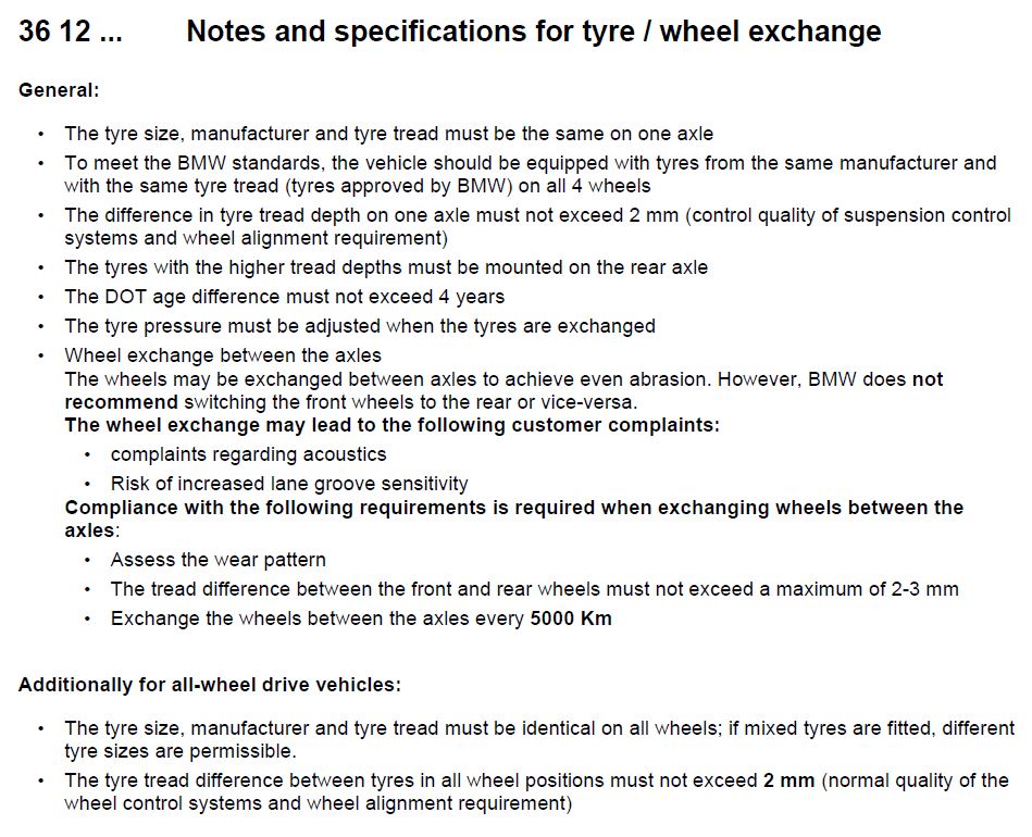

xDrive can be really fussy with different tyres in my experience - it wouldn’t phase me on any other brand of car I’ve driven with AWD/4WD.
Fussy how? They’re both star-marked PZ4s so the dealer will claim they’re fine.
I want matching tyres but not keen to pay £250-500 for the privilege..
If you believe the BMW advice then they sound like an absolute diva, but I can't imagine there are 1000s of owners throwing away part worn tyres and replacing all 4 every time they get a puncture (or even when 2 are due replacement)
I'm not sure if it works out any different to the 2mm quoted above but BMW often quote xDrive on rolling circumference tolerance (1%) rather than tread depth difference for some reason, at least the performance variants of it. I don't know at what point it becomes significant but BMW definitely state that if there is too much difference in tread or rolling resistance, etc. it will impact the lifespan of transmission components. To an extent the transmission does have to deal with mixed conditions across the different wheels anyhow but these kind of systems can be fussy.
