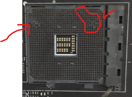

It does look like there's something going on with the socket in those areas.
@Vince What does that look like to you? Sorry for the tag! :p I'm not sure if that's something that could be feasibly fixed in some way assuming it is a problem.
It certainly doesnt look right does it. Although im not 100% what im looking at as i thought the AM4 cpu had pins and im struggling to work out... is that the socket?

Aye, AM4 socket.
OP tried replacing the CPU after damaging the old one by accident but it didn't work so thinks the motherboard is at fault, the good old cement-esque thermal paste ripping the CPU out with the HSF trick unfortunately.
I would have assumed that if there were CPU pins leftover in the socket that a different CPU wouldn't have fit at all, but it just looks off.

Yes that is the socket.
The CPU had several pins broke off...

Want the cpu fixed? Id be happy to swap some pins over :) Can you also give me a larger pic of the board so I can check the pinout against the socket? want to see what those 2 pins are.
Now I look at it, those holes don't look to be in the same place as the broken pin, but I am thinking I might of tried to put the CPU back in in the wrong position...
It's all a bit of a mess...
ok so I worked it out one of those dodgey looking pins is a data line for mem channel b and the other is a vss pin of which there are a ton of them so loads of redundency the only one at might cause a no boot is memory channel b pin. My guess is the board will boot.

That cpu is barely an issue :D most of it bends back and a few new ones needed. I did a load of pins on somebodies 5950x at some point and that worked out fine.
It's got what appears to be quite a bit of damage in the socket in quite a few areas:
Sometimes you get away with it others the damage in the socket is just too much.
