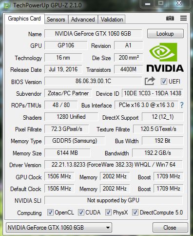

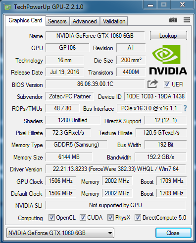

Before you do that, can you please download GPU-Z and take screenshots of the Graphics card tab, and also the Sensors tab (the latter while you are stressing the video card with a benchmark like Unigine Valley/Heaven - you can choose a smaller custom resolution for the bench, doesn't have to be fullscreen, will still stress the video card 100%). The info displayed there might help.
I've just updated the drivers for the motherboard with no noticeable differences whatsoever. I am just about to uninstall/install the intel and nvidia drivers after this message. Here are the stats that GPU-Z are providing -
Thanks for the pics.
GPU Load, Memory Controller Load and Power Consumption are spiking like crazy during the bench, from what I can tell. If it's not some driver issue or hardware issue with the card, it seems like a power delivery issue. It could be worth testing with the old PSU at some point, if easier things don't sort it first.

Going back to GPU-Z, please confirm that in the Bus Interface reading in the Graphics Card tab, the "PCIe x 16 3.0 @ x 16 1.1" changes to "PCIe x 16 3.0 @ x 16 3.0" when you stress the video card.
