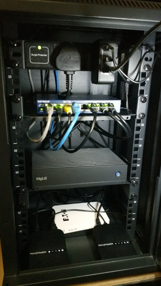

Man of Honour
13 Oct 2006
91,128
Setup where I'm using it:
Probably neaten it up and integrate into a rack mount at some point.
At some point will DIY a USB shutdown capability but it is more for smoothing over transient power events, which aren't entirely uncommon, in a rural location than to deal with power cuts which fortunately are more rare.
