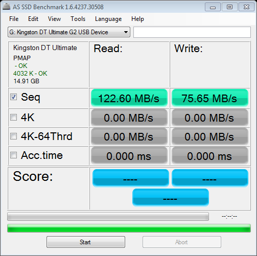

OcUK aren't showing the correct specs for the Kingston drive.
Here's how mine benches, run AS SSD yourself but only have the top box checked.
