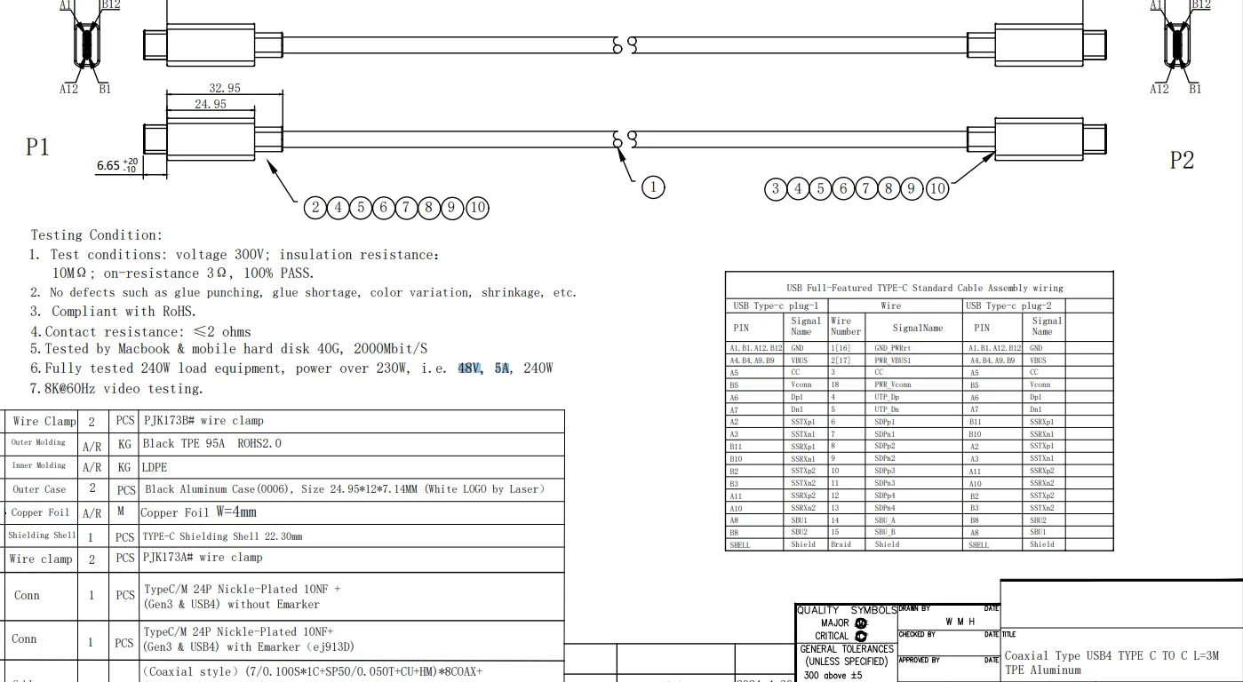

Schematics in this post.

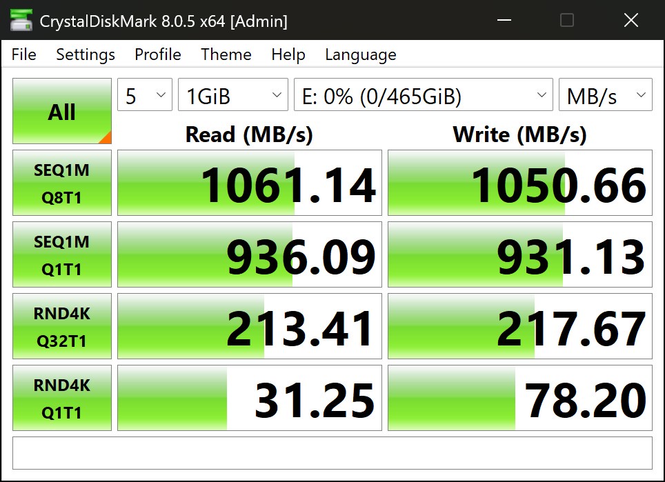

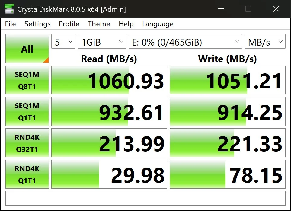

The cable connects nicely to my nvme caddy, and offered virtually the same performance as my Spigen cable when I ran a benchmark testing them both. But my caddies limitations are what hold both cables from reaching their true potential. And a quick google shows USB 4 caddies as a bit too expensive for my current usage.

Here are the screen shots from the CrystalDiskMark benchies:
SubbyTech:
Spigen ArcWire:
No info found there.
Most manufacturers or cable retailers will at least quote the wire guage, wire material, bend radius and temp range, even ones sold by Ali.
Failure to provide this info automatically takes you off my shopping list for cable providers

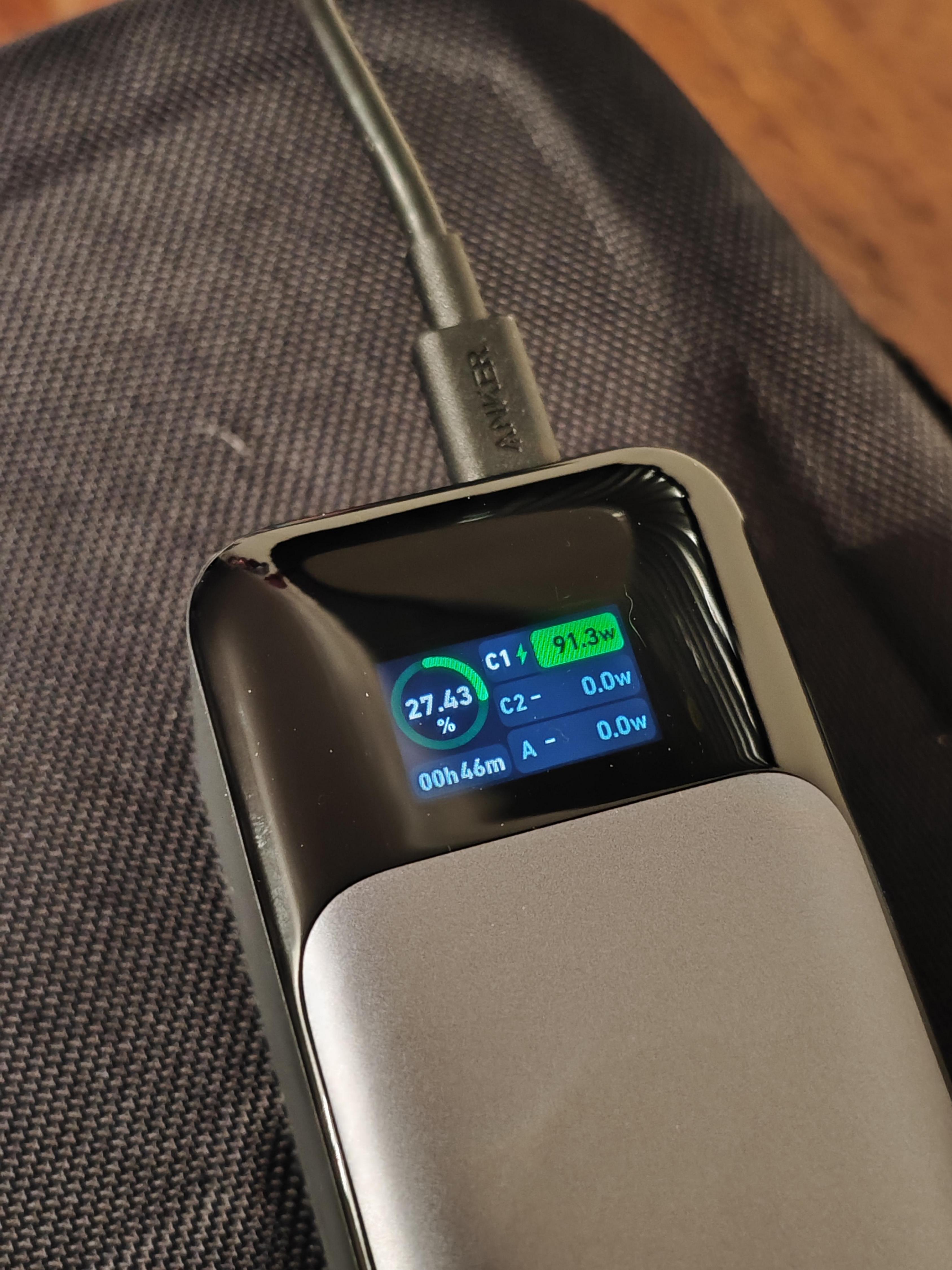

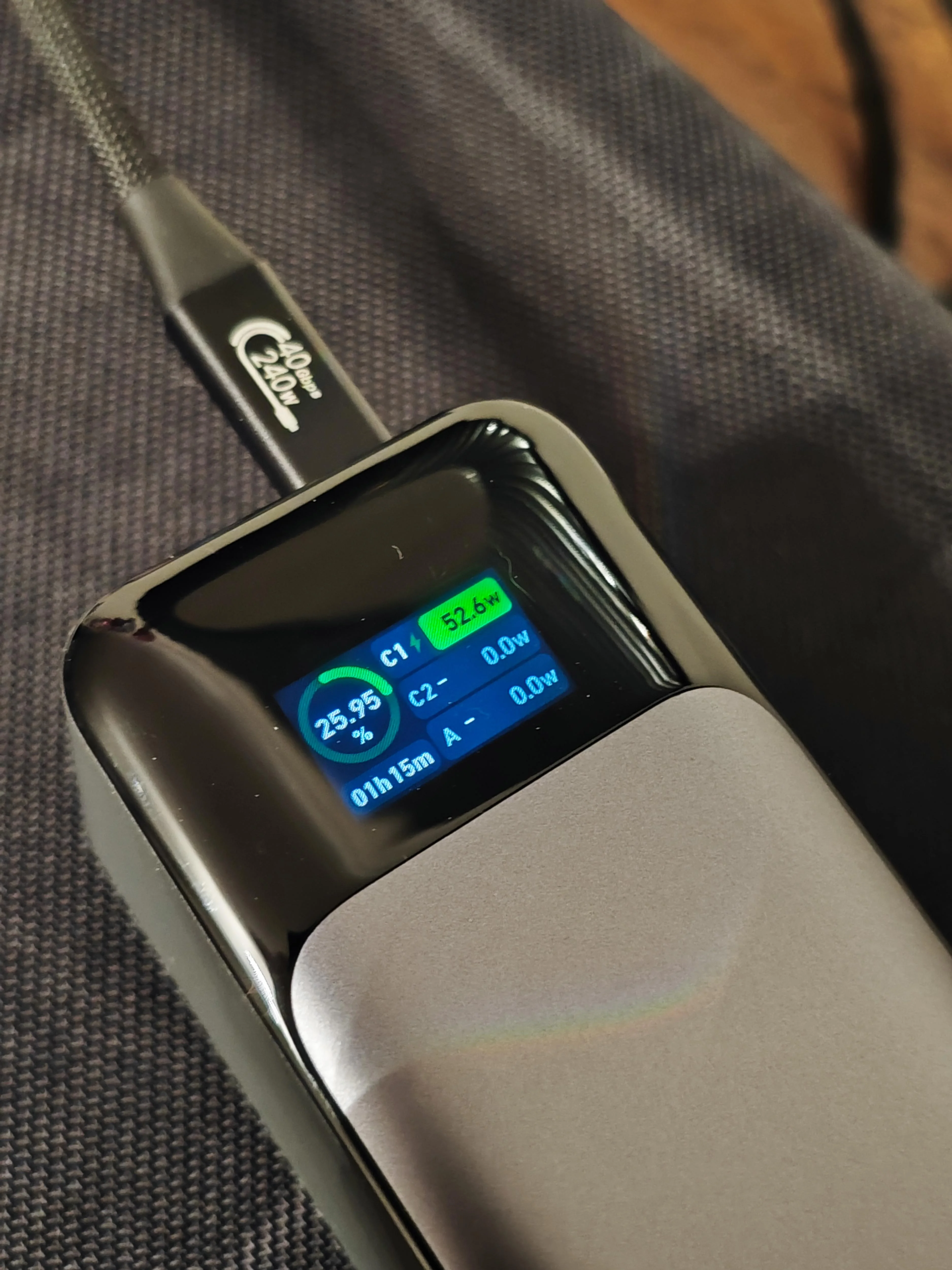

I managed to test the 2m cables charging ability on my Anker power bank. I'm not sure why it wasn't any faster but here are results m8.

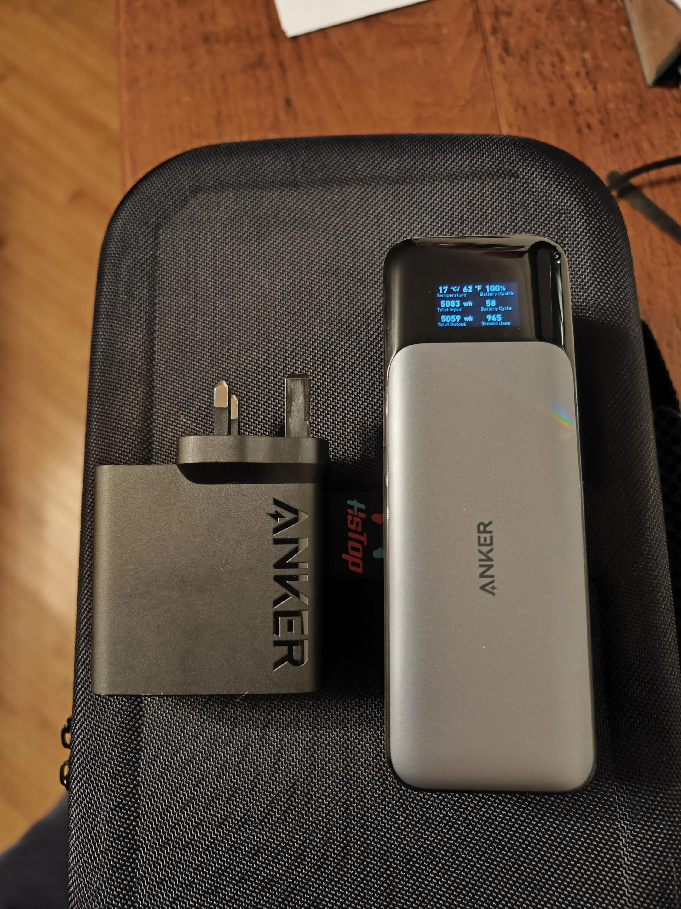

I've got a Anker 100W USB C charging brick, and an Anker 737 power core 140W.
The Subbytech 2m braided managed this charging speed: 52.6W
Ankers own 100W unbraided 2m cable managed: 91.3W
Regards
Mick
