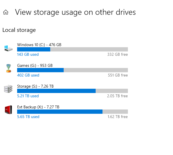

My OS and Games are also on SSD's but due to the quietness I gained I decided to go further.
I went from 4 Mech HDD's to 3x2TB SSD's then upgraded to 2x4TB SSD's for storage there is no real noise in my PC unlike before.
Putting large files on it and leaving them there will wear it less than using for OS where it has constant small writes going on (you can see this in software).
BUT! as always have a backup with any type of drive, I have Raid 10 Ext caddy with WD Red in it).
