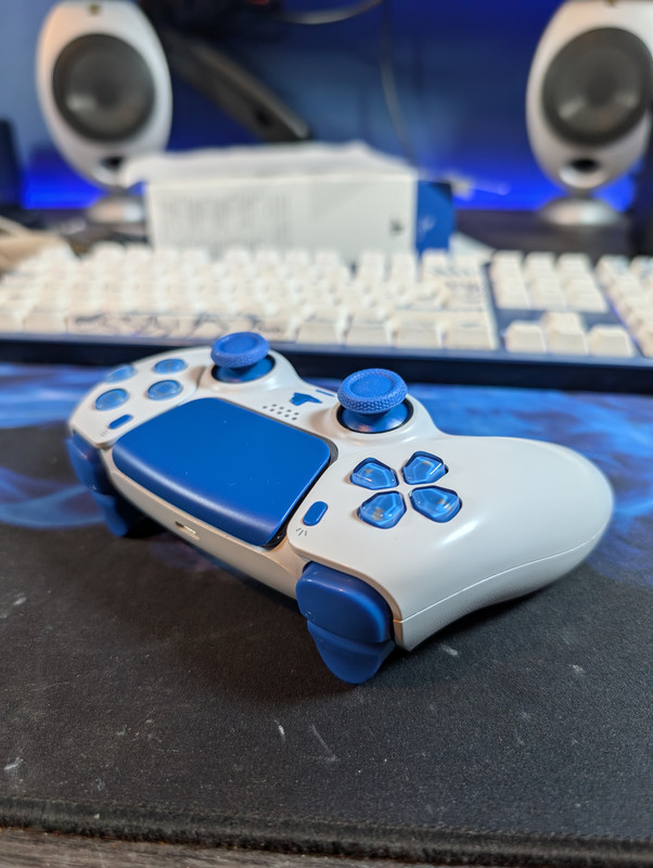

@Armageus pad is on the way back to him the original board wasn't a happy board so I just swapped the board rather than spend a lifetime looking for why it wasn't happy. Swapped in some halls and yea... Hopefully one happy camper.

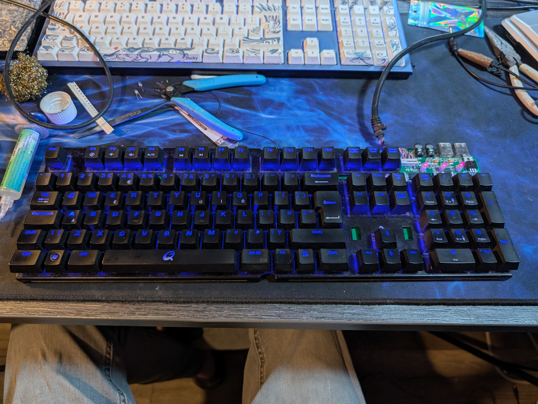

Then there is @jaybee keyboard... I've only started working on this last few nights, apologies my man.

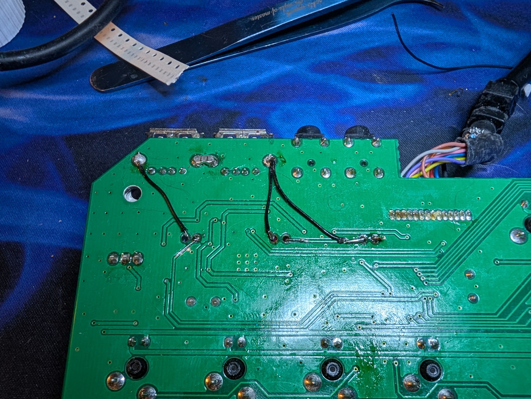

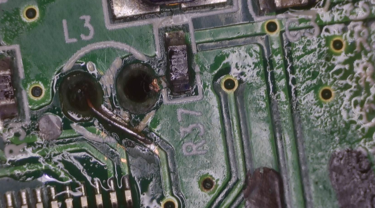

All of the visas for the LEDs are missing so we went ahead and did our own thing and sort of wired it all up and made it work. I connected the cathode side to ground for each led coming off the anchors for the USB ports, anode side I just rebuilt the original traces....
you can see from this image that the original LED's would have had a 1k resistor on the cathode which on these modern pink led's is totally pointless so instead we just wired them straight into common ground.
Interestingly with regards to the brighter keys that you took the LED's from less used area of the keyboard, this keyboard runs a full line of LED's in series so caps lock, a, s, d, f etc along a line are all on the same rails which means that you cant simply isolate voltage for a single LED without affecting all the others along that line as well, you could potentially isolate the annode side on just that led but to be honest its not worth doing.

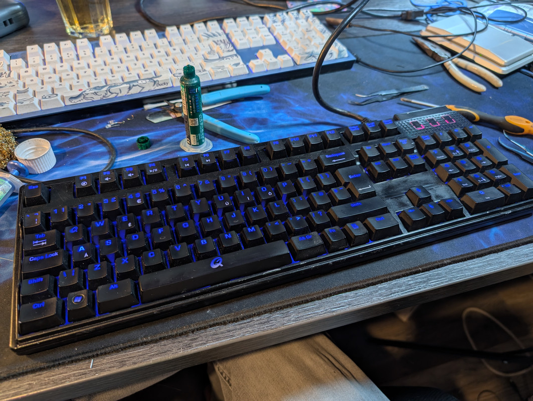

End result though all your caps lock, scroll lock and num lock led's are sorted and working. I masked it all up and threw it back together:

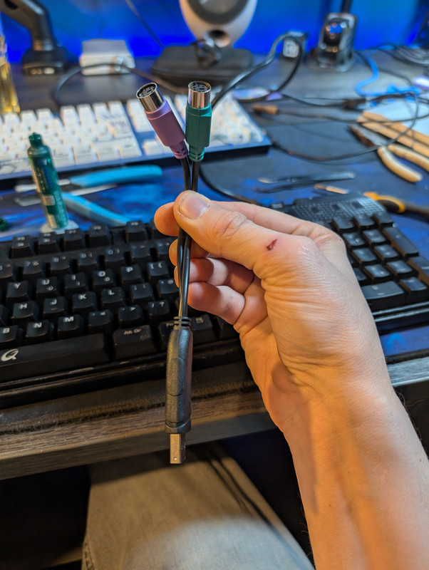

The old girl lives on. She's becoming like triggers broom! You know you loved the PS2 connector really. I mean...feel free to convert it to usb. :) Top work.
Also @jaybee do you want this adapter? I have no use for it anymore :cry: my work here is done...
I looked everywhere and couldn't find one in the package..
Looking much less sorry for itself now it has its sticks refitted :)
