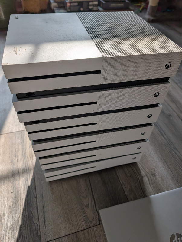

8 of these came... I normally don't grab one S but at 15 each for 500gb and 20 each for the 1tb models it's worth fixing em up. The cleaned up one was the first of the 8..
And yea the shells actually get steam cleaned because of the holes.
That's insane. Do you know what's wrong with them or just buy them as not working?
I dont get told up front each one is a little box of mystery :) - 4 are done! 4 to go!
3 of them are beep on beep off, one is no power at all! Should be interesting.

No power at all one was fun! Had to dig around loads but eventually found a little 5v regulator that had a short on an output. Swapped it out from a donor board and....
