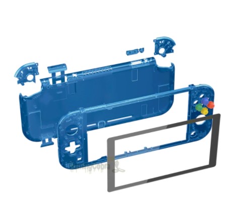

Parts are sstarting to turn up for my custom switch lite! I went with this case:

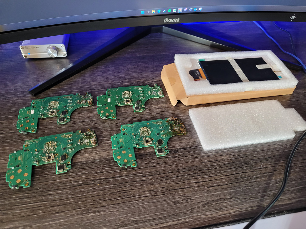

then a brand new LCD, and I need to decide which one of my donor boards I think can be fixed for it... I should be able to make at least one good one out of these when a few chips turn up this week!
I guess I'll just run over them again and see which one if any are salvageable.
