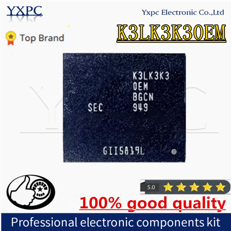

@Vince apparently some people in China installed/soldered 32gb ram in the Ally. Any idea where to buy from?
Yea man - how many IC's does she have? Ok i looked its got 4 x 4GB LPDDR5 modules from samsung. So you need 4x8gb modules.
£16 a module plus shipping for samsung modules and you need somebody that is comfortable with bga rework.
I have done this before, I doubled the memory capacity of a gpu. Oh and my oled, as you know my oled is made of different things :)
One thing is for sure its going to be a slow week this week! I am in the office most days so ability to just pick up a random repair when I am bored goes out of the window.
Very tempting, as soon as a few people have done it and there are no issues, I may give you a shout.
We can talk for sure :) - I mean as with work I've done before like this, so long as you know the risks. :) Given I've abused your devices before I know you get it!
