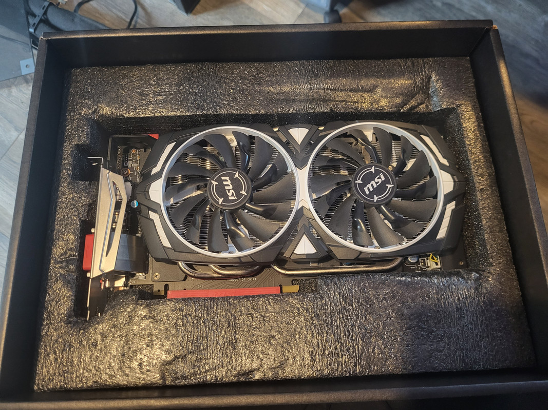

Ah yes I didn't send any info with it..
I did test it again after putting aircooler back on, it powers on but no display.

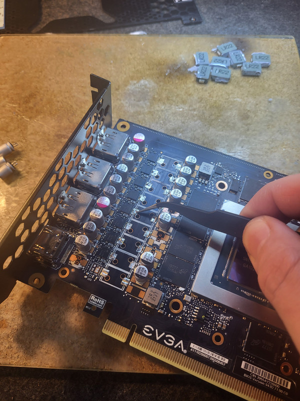

Been testing your card and found it has a rail that doesnt come up. So both 12v rails come up and we have 12v input at both pcie and the two 12v plugs but on boot vcore doesnt enable so we likely have a bad fet somewhere as we have a dead short on the output of vcore. I started pulling coils on the shorted line to see if we can find what fet is bad!
We know vcore isn't coming up because PEX never enables.
Well still not found what's causing it.. short is still core side of the power stage.

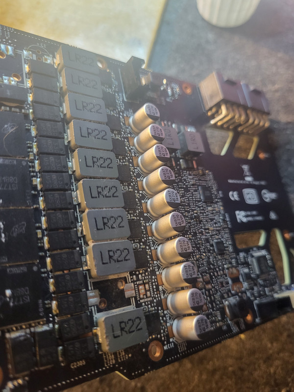

I'll just remove all the inductors one at a time and see if we can isolate it. - well this isnt fun :P i just tested it against a known working card and its 100% not getting any vcore voltage at all. But where is the issue?
I think I have found the issue :D problem is I don't know how much damage might be further down the line....

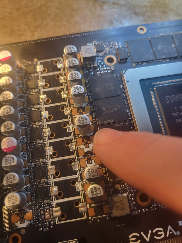

So I removed the power stage the other side of the gpu after putting the other side back together and I tested all the outputs of the fets... they all look fine... I did however notice that some of the caps were really not looking great and sitting proud of the board if you look at the power stage this side...

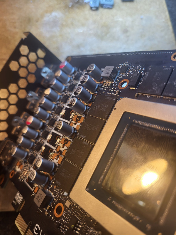

vs the other side...

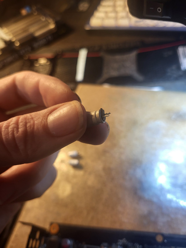

Look at this cap...this is reading OL...
At least all of these ones need replacing...
These 3 are massively out of spec...

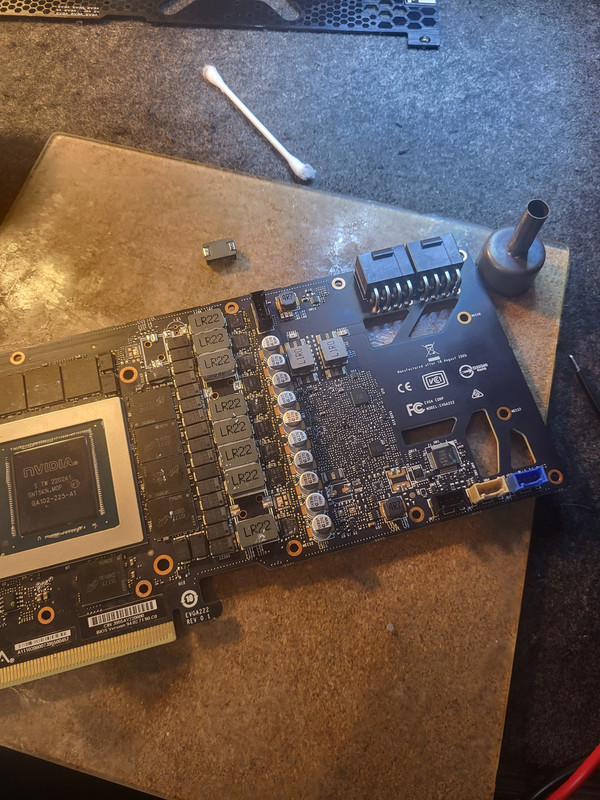

I dunno... think ill replace all of these and see if it boots.. one of them is damaged at least for sure lots of them look bulged so I guess it could just be these caps...
I bought a load of caps... lets see if its one of these I guess.
Think we just leave it here for now, but put it back together until some parts come in. I'm not massively hopeful for it but who knows.
@Finners - Spent another hour with this beast and a year later I still can't fix it :( all its rails are present but it just won't fire up. I think it's time I send it home.
I hope this is your one and my bits of paper haven't got mixed up at least.
