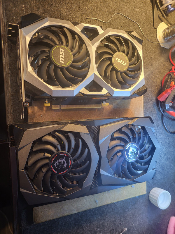

aye no worries, we will still try and fix it! Im just not sure why the power stages arent coming up. we will find out when we swap caps and then we can re-test it see if it's any different.
ok so both boot, and both have vram corruption :) I wonder if we can make one good out of 2 or we swap all their ram...
Yeah one of them gets very, very hot so not sure if it is actually VRAM, think it is the larger one, untouchably hot.

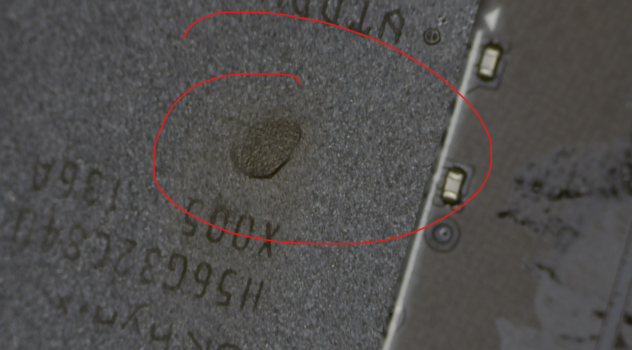

The fact its got actual holes in its vram may explain this:
Its got 4 chips that are seriously burnt / have holes in the same place....
Yeah, that's got to be a power delivery issue somewhere?
I think last time I bought some of the Micron IC's they were MT61K256M32JE-14:A but those look like SK Hynix ones, I paid about $7 each from Aliexpress that was a while ago though, you probably have better more up to date info. :)
Ive found them and 4 of them are 32 quid. I dont think the cards got delivery issue I recon somebody has clocked the nuts out of the memory for extended time... I wonder if it was a mining card?
Id probably replace them all looking at it tbh thats like 47 quid
Why it IC part number please? Can't see from that picture. :)
H56G32CS40-X005
but looks like that is interchangeable with H56G32CS4D-X005

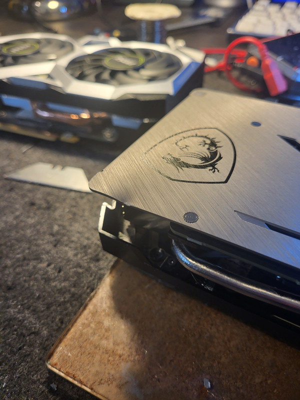

Thought I would check the other one... different mem chips on that one
