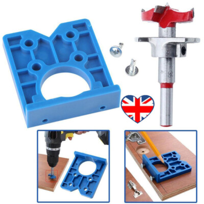

I see that there are these for drilling hinges, so maybe my custom madedoors would be pretty easy? Just cutting some mdf or ply to size then glueing some slat wall panels to it?
Example jig - any examples welcome.
I guess I could also just drill it (with a forstner bit) and/or router? I'm not very good /experienced with my trim router though

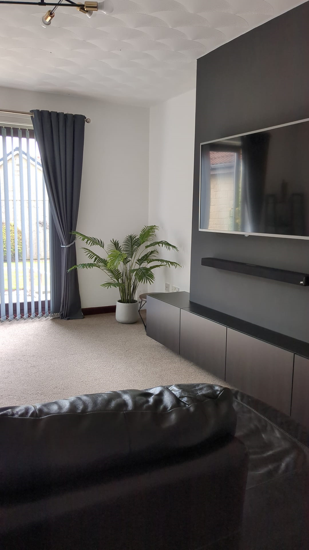

Used the Ikea floating cabinets for our chimney breast
Thanks for link, looks good
