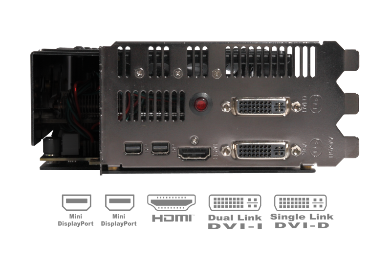

It says Bottom DVI port does not display, Question is... Is that the Dual link or the Single Link?
According to this picture of the same card:
The top DVI Port is labeled DVI-D and the bottom DVI port is labeled VCA.
Am i correct in assuming that the top is the DVI Dual link and in turn is working?

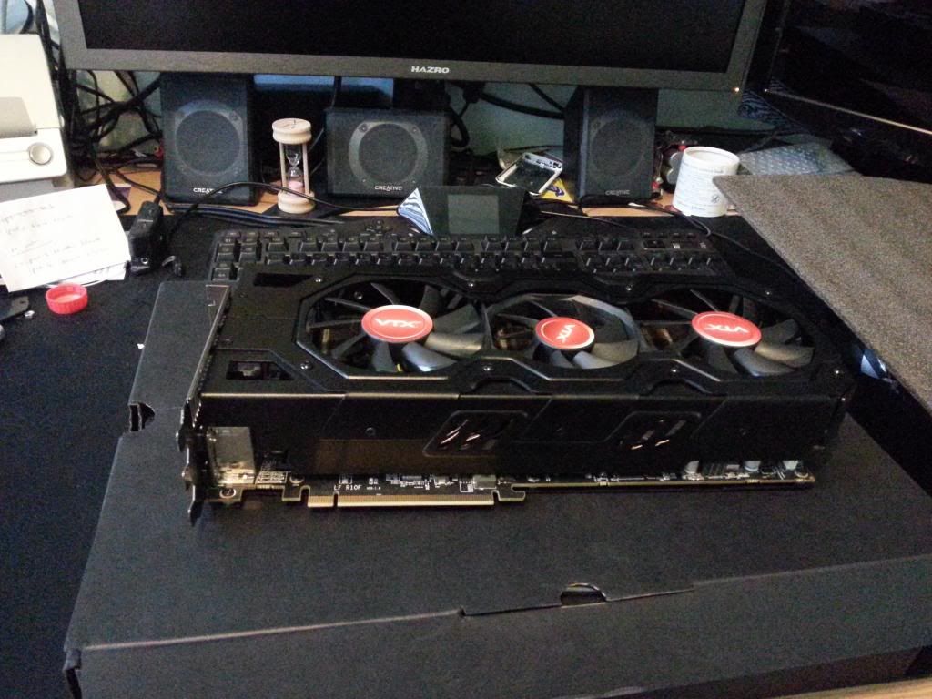

lets see the card
Looks in good condition, i see no finger prints or signs of use at all Though we know its been used as it was "tested"

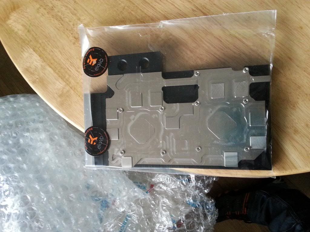

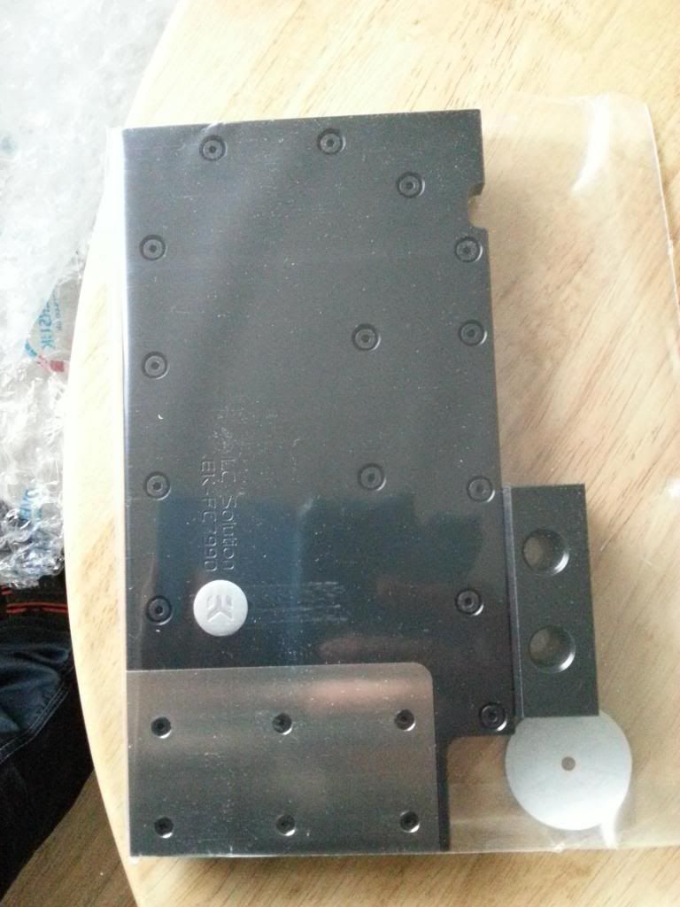

Oh look what else turned up
That is the BIGGEST Waterblock box i have ever seen!
One MAHOOSIVE Block

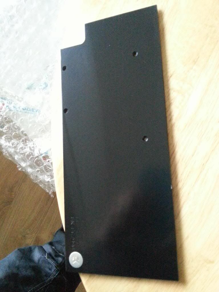

And the same can be said for the back plate
the underside

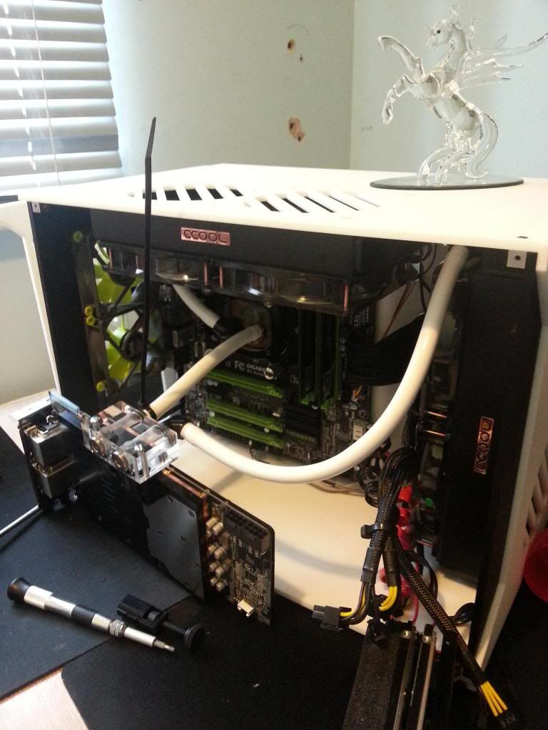

When i get the time i will test the card on air and if i can get it working via Display ports or DVI and both cores work and don't artifact or crash then i will watercool it ;)
EDIT: TESTED
So i got around to testing it. Was a right pain getting it into the case with the 7970 still attached. I didn't fancy draining any loops today.
Here are some random pics for the fun of it
Moved the 7970
In goes the 7990 ;)

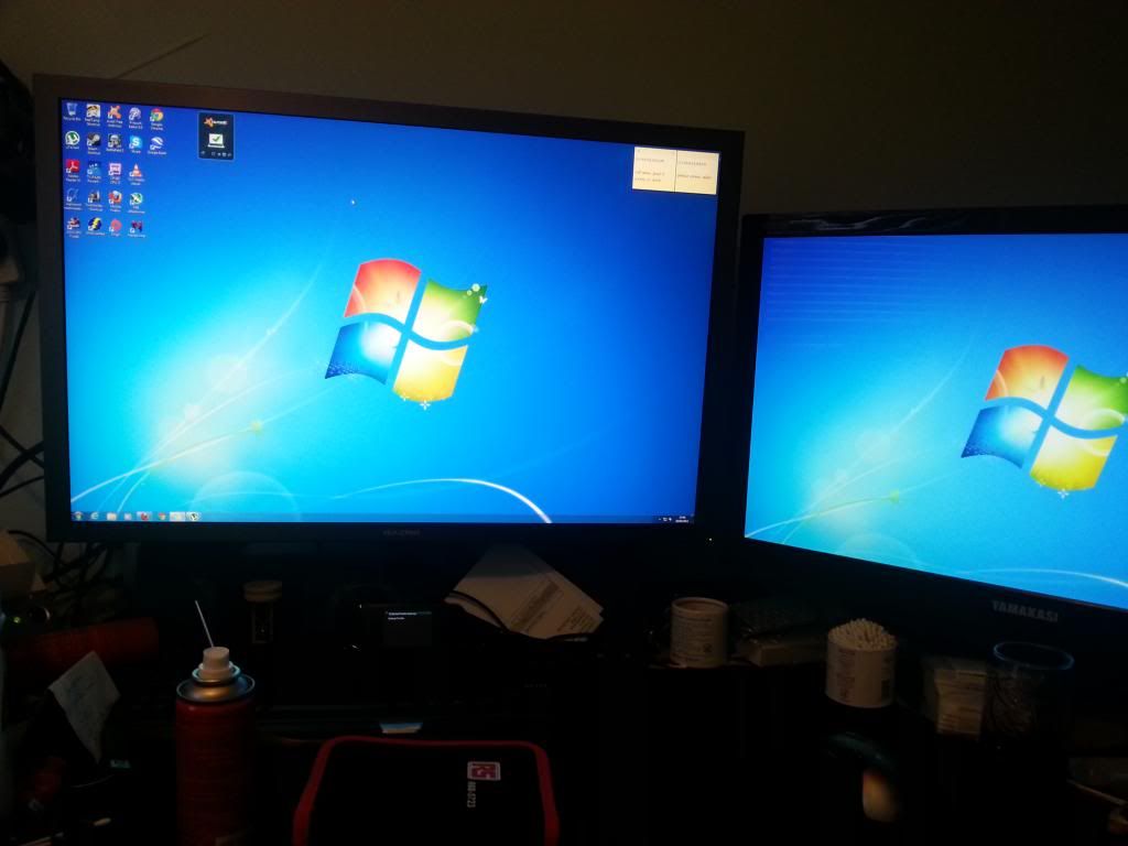

NOOO no display with the dvi with the hazro
Plugged the Hazro into a Dell Adapter and the Catleap into the DVI
And W00T!
