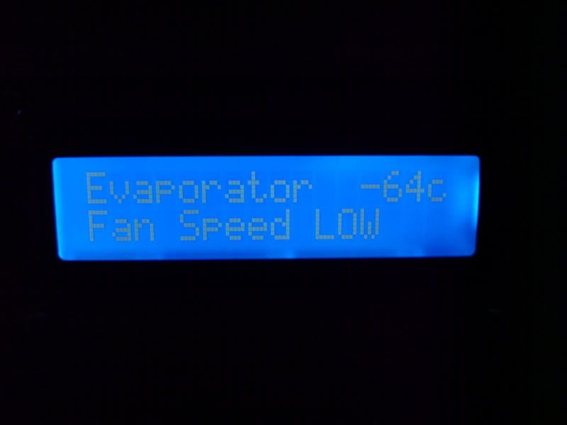

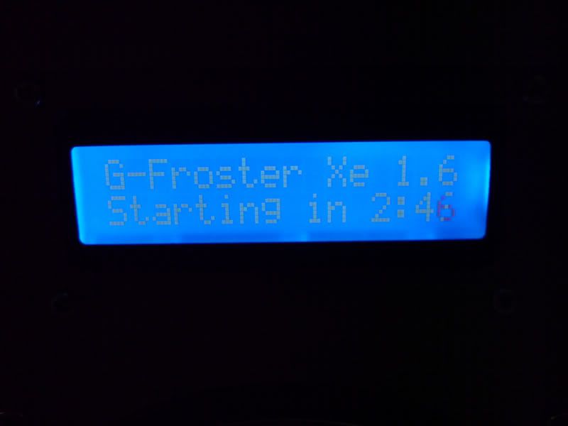

1 Thing i didnt realise is how long these units take to warm up and get going from when you hit the on button!!, The unit counts down 7 minutes to get itself ready then cools the Evaporator head down to -40 or so which takes another 5 minutes or so before it turns on the PC, then continues to about -60 -65c!

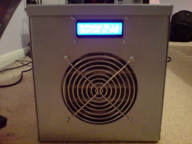

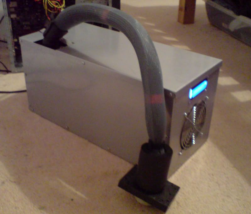

Ok here we go, sorry for the awful quality of the pics I used my phone cam :o
Heres the unit itself:
Front Panel:
This is what you get when its priming (7mins in total):
and when its reached operating temps:

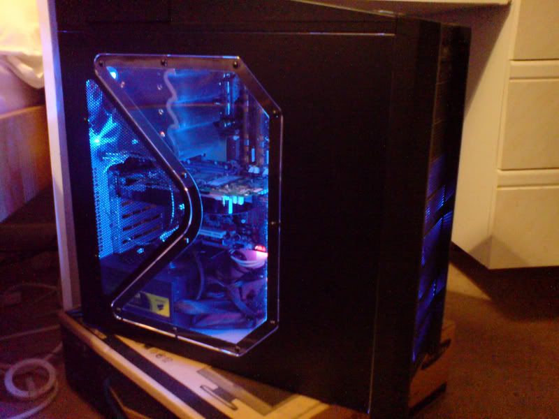

Heres the poor machine thats going to be subjected to it:

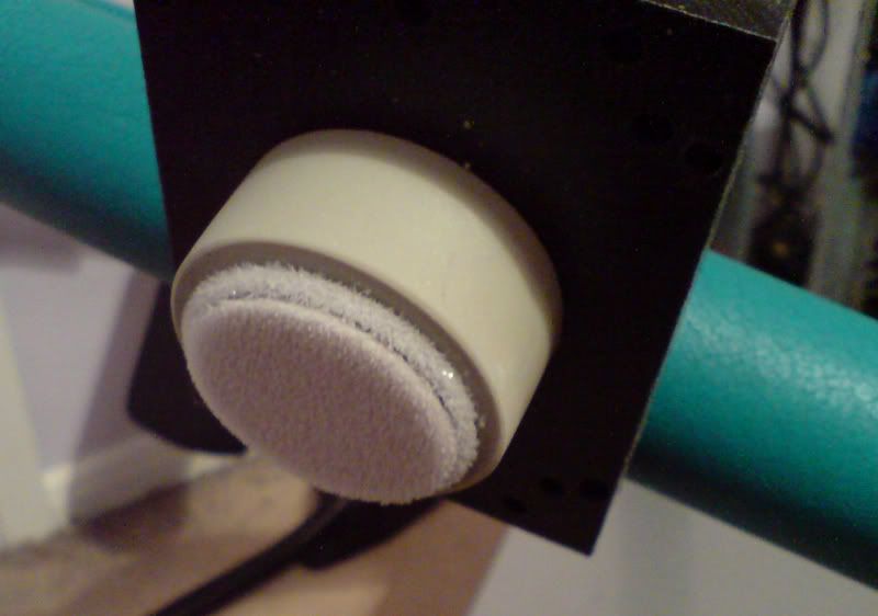

Finally I had to have a frost shot :D :
