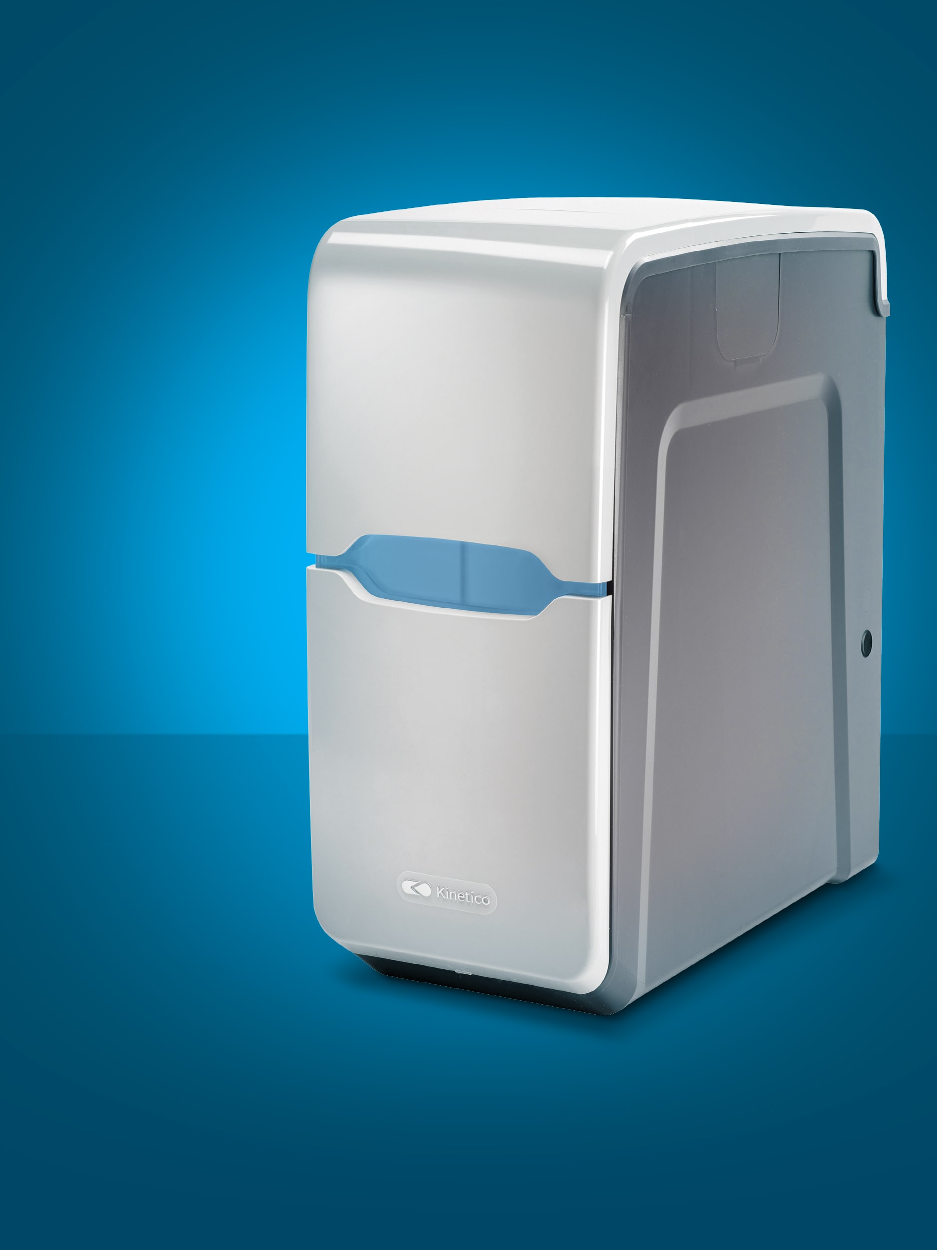

What sort of price are you looking at for a system like that installed? I'm assuming on the incoming feed to the whole house?
Is there much maintenance or consumables in the system?
It’s this one:
I paid around £1500 installed back in 2019 and that came with a load of bags of salt blocks.
No maintenance required. Just replenish the salt whenever it runs low. Currently going through a pair of salt blocks (1 bag at £9.50) every 3 weeks in a house of 4 people, 3 bathrooms. So £165ish per year to run and it easily saves that in maintenance, soap, cleaning products etc.
9 Mar 2003
14,246
Snap.
Just to add to my post, block salt is more expensive per KG than standard tablet salt. The only advantage of block salt is that it is faster to refill but really we are talking about seconds per month.
You can get 75-80% of a bag of tablet salt into that softener linked above and it lasts for weeks and weeks between fills so it’s not like you need to fill it regularly.
