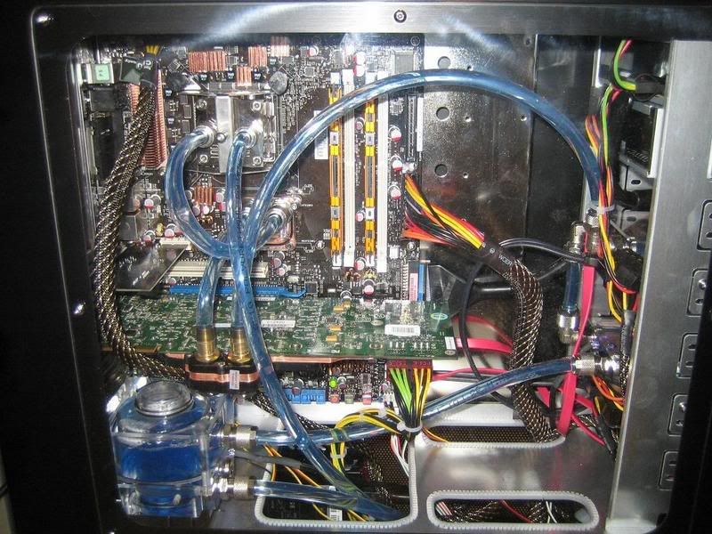

I goiing to be running pretty much the same system TJ07, Maximus SE, 4x1GB ram, 8800GTX. I am using a DDC pump with an Alphacool top/res. I am running 120.3 radiator in the bottom of the case and the E6600 runs about 55c under load at 3.6GHz. Here a pic before I replaced the Commando board with the P5WDH.
When my Maximus SE is fitted with Q6600 I will lose the water cooling to HDD Using 8/10mm tubing but will be changing to Tygon 8/11.2 as the tubing is far more flexible. Just need to change the compression nuts to suit the larger tube.
Nice setup, it is good to know you can run all that on 1 pump and rad. I am not going quad for a while, probably penryn so in theory cooler but I will just clock it more. ;) and a GT should be less than a GTX.
Does the rad fit down there easily, also do you think another maybe smaller one at the top would help temps?
Theres space in the bottom for a 120.2 as well or another 120.3 if you use a regular length PSU. There 2 x 120 fans at the top so another location for rads. Penryn will run cooler still so a single 120.3 should be fine. Running separate loops for the CPU/GPU may be benificial, but mine is already as cool and quiet as I need.
