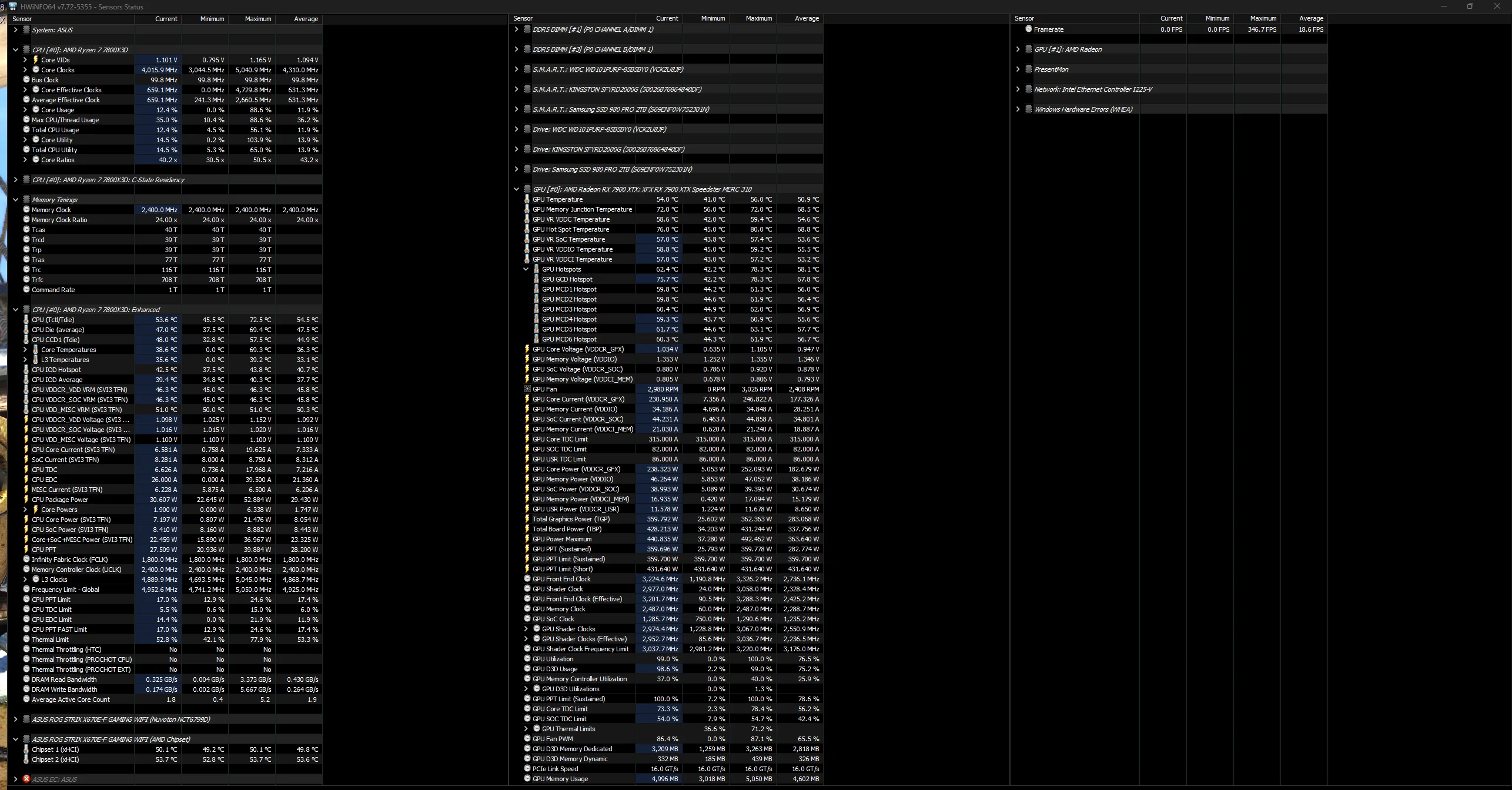

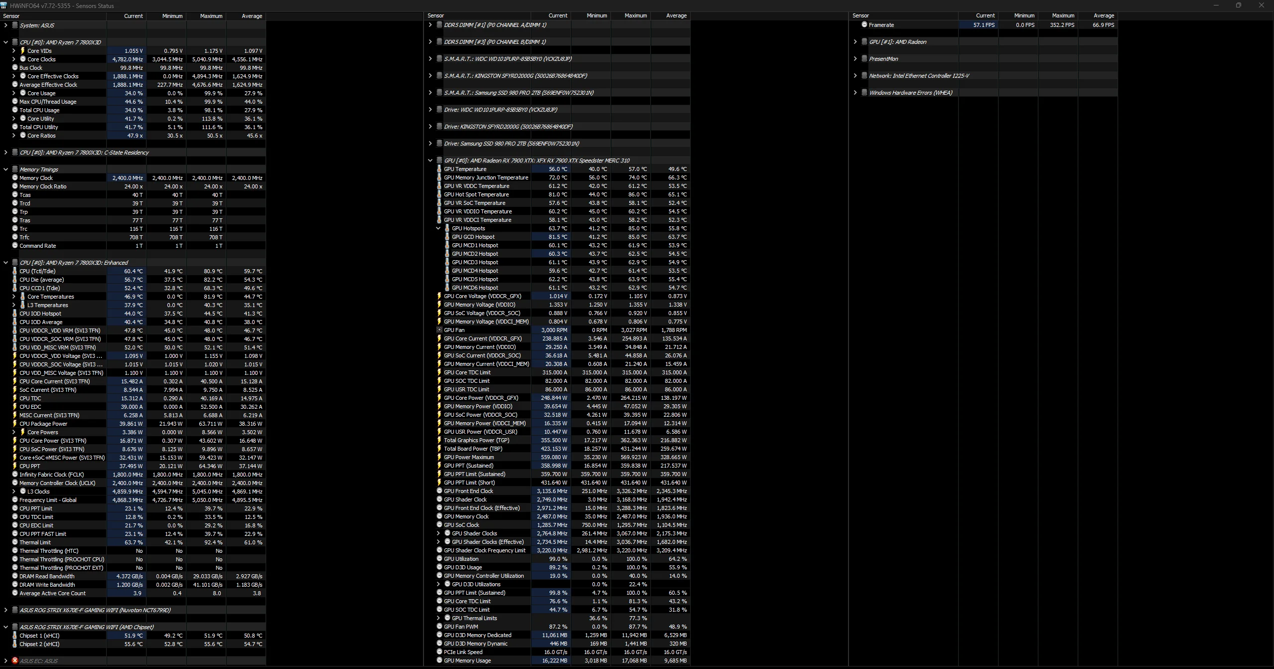

I do have the newest chipsest drivers too. I did also try that tonight through some other means, here's what I did:
Did a few tests, overclocked, underclocked, voltage up, voltage down in CP2077, and monitored my temp, here are the pics, the game ran fine, fully maxed settings and the pic was while in "rage" mode which is and adrenaline oc, ~45-50 fps. didn't notice anything out of the ordinary though the game is flashy and maybe if I played it for few hours something might have popped up.
First pic is while running haven for a while and 2nd cp2077.
