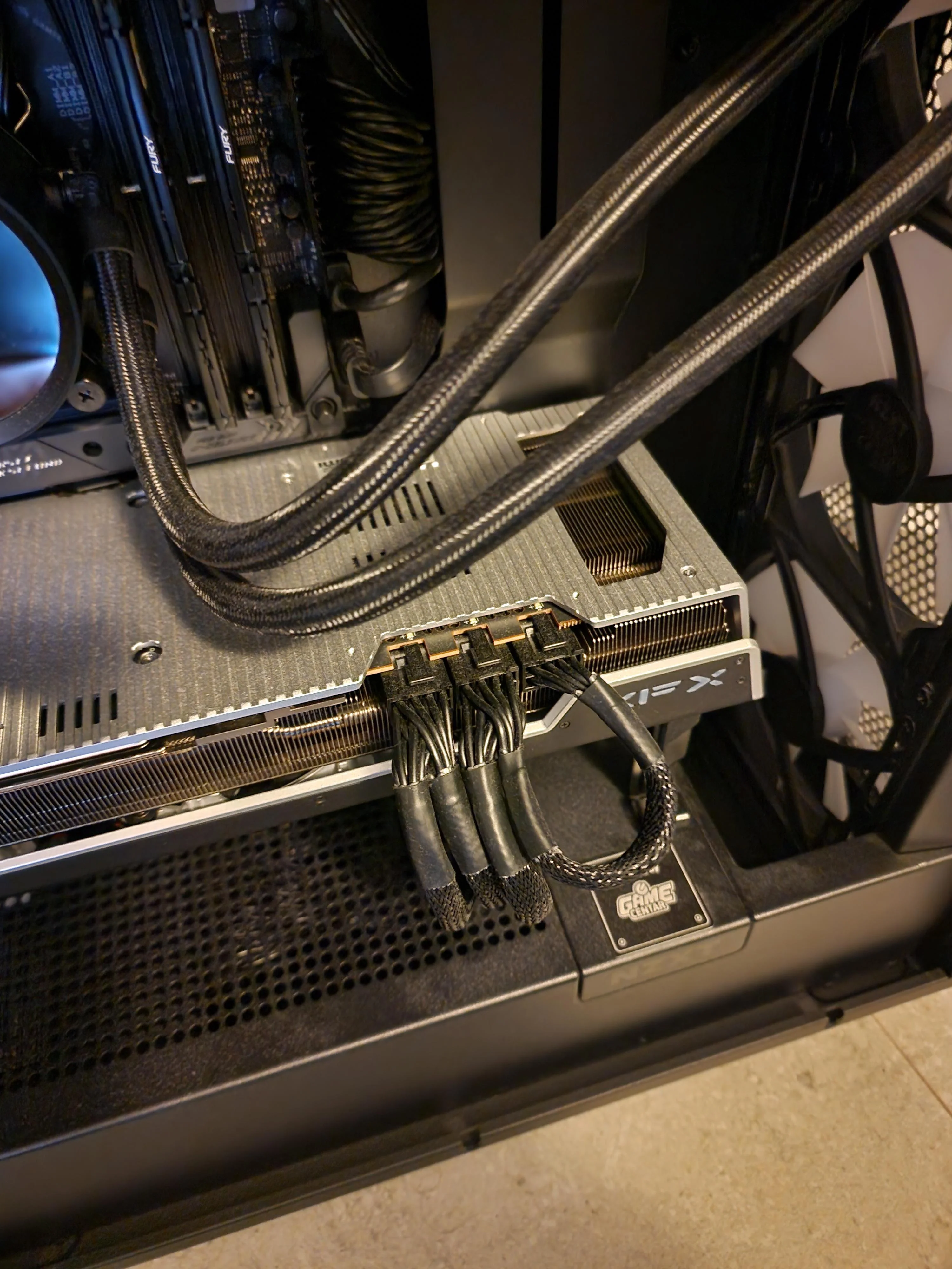

Oh and this is how the card is powered, it's not dusty or dirty the camera just went into night mode and messed up the colors.

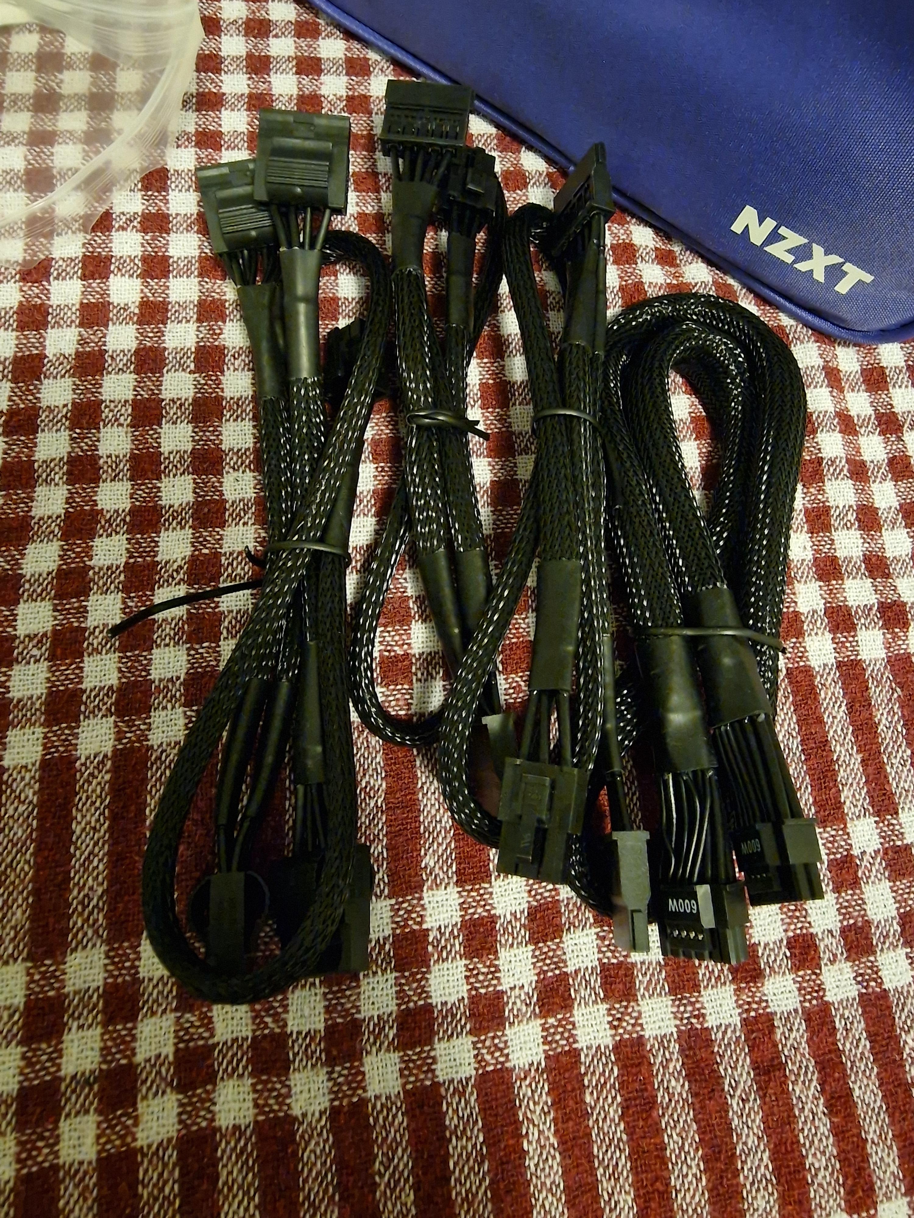

the picture of your gpu is a not really how you want to power the card, ideally there should be 3 seprate cables from the psu to the gpu, your using a pigtale cable to power the 3rd 8pin pcie plug, i would bet if you power limited your card you would be ok, but when it pulls more than 375w thats where the trouble starts.
check if you have a spare 8pin pcie cable and if you do install that and see what happens, just unplug that pigtale and plug a 3rd cable from the gpu to your psu and try again.
That's why I posted it, I wasn't sure. I can take pics but I really have no other place on psu or cables, the left one is single (not sure why it's double at the end) but yeah the 2nd one splits into 3rd as well. I'll try and rewire the whole thing, see where the other two cables are going and switch both of them with this one if I can, at least to try and see what will happen. It's pretty tight in there and cable management has been done well, gotta undo a large part of that now
from the picture you will have 2 cables running from the psu to the gpu but on the other end there will be 4 connectors, all modern gpu's require 2 or 3 plugs, pigtails were used on lower end gpu's that didnt require a lot of power, but when cards passed 250w mark its smart to use dedicated cables to your gpu, otherwise cables can heat up and power issues will arrise.
just checked your psu, with regard to cables you have the ability to run 3 cables to the gpu as long as you run 1 8 pin eps power to the cpu, a 7800x3d you have will run perfectly on 1 cable so you will have nothing to worry about. being a 1200w it should have the spare cables you need.
this is how i would run it

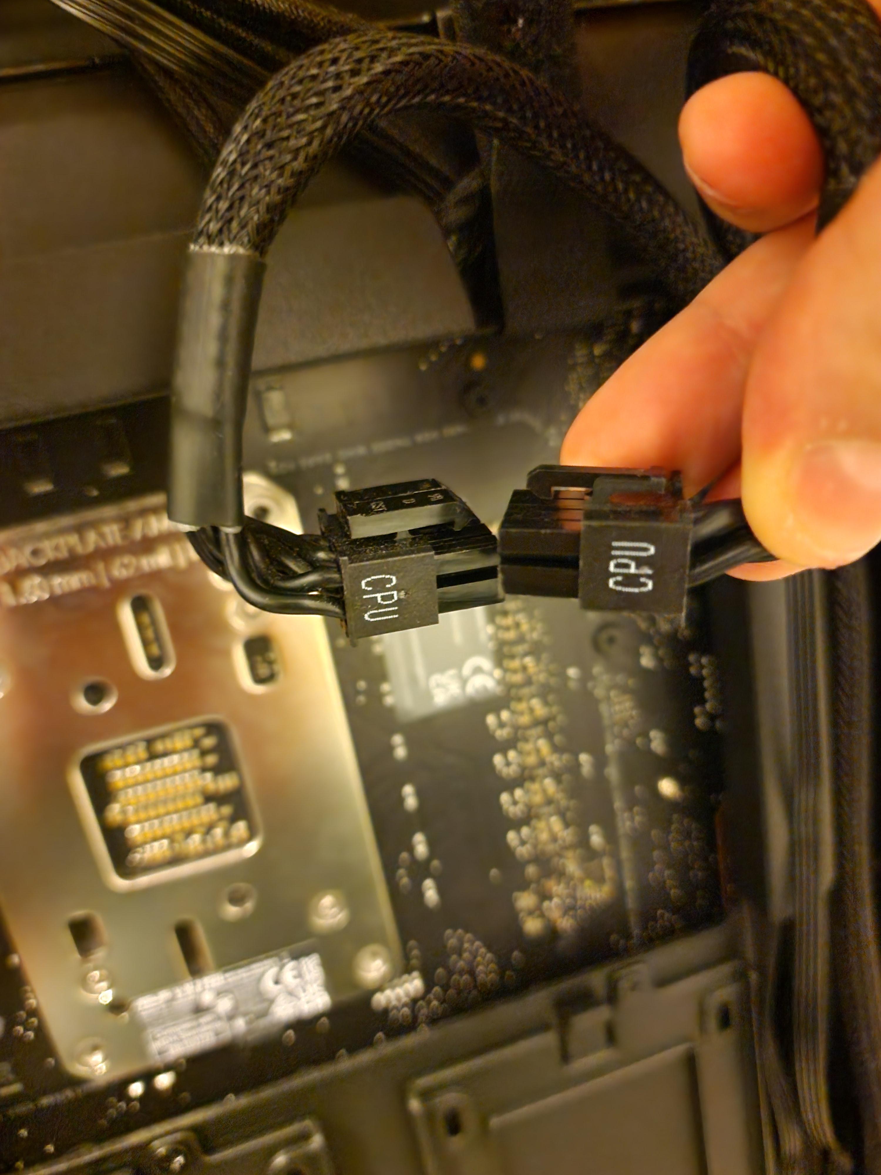

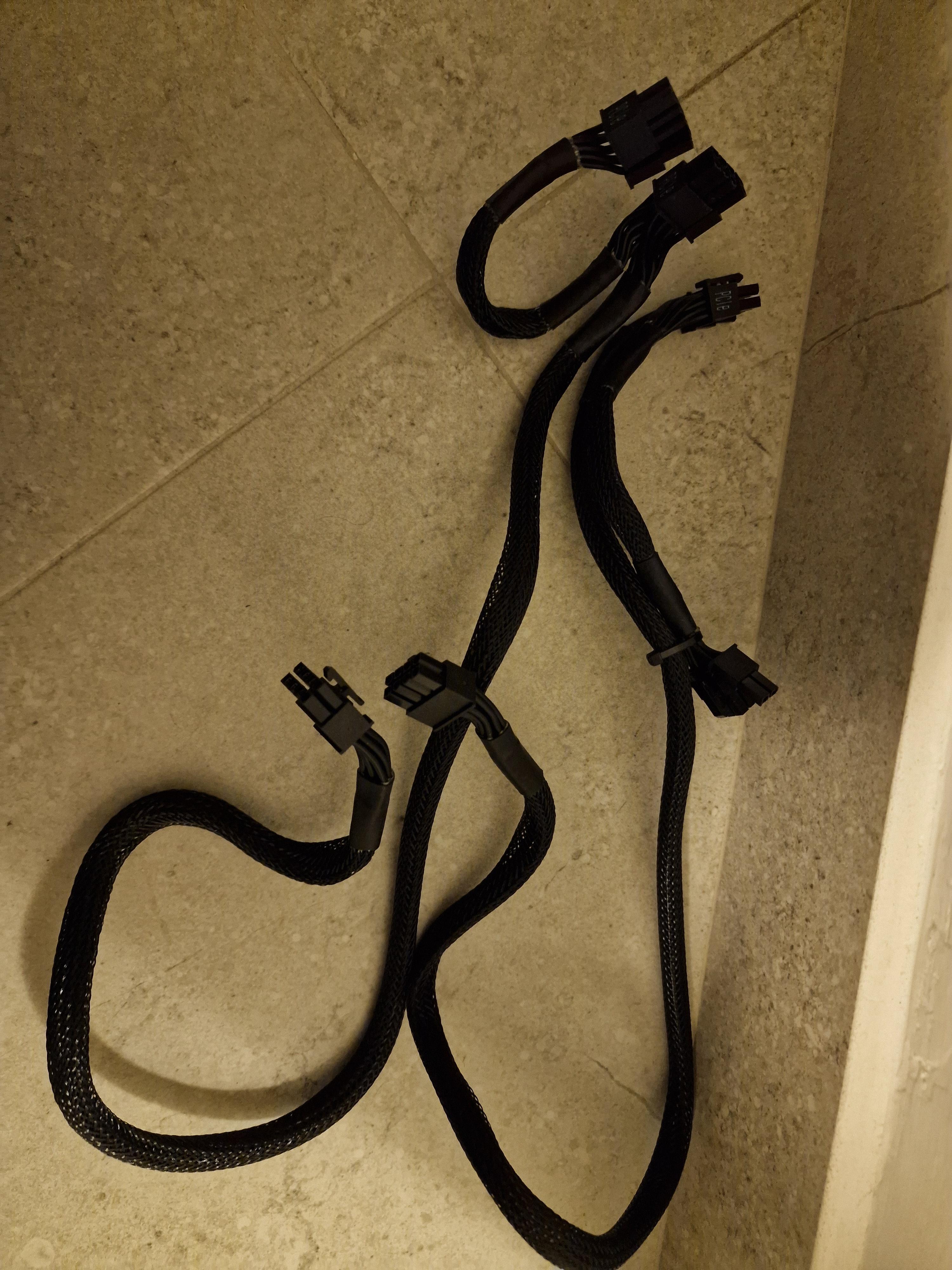

Thanks, I'll give it a try now, I know the top two are going somewhere to the top so I assume CPU, I'll try what you suggested now, or tomorrow when I have more time as it's getting late, fingers crossed!
Edit so i just unplugged everythig and the issue is the 2 cables at top bot say cpu and the other ones that were used for gpu are gpu. As for cables that I have left over heres the pic too
Do i need a new cable or an adapter? For the 12vhpwr one, thats the only thing that makes sense, not sure why its same on both ends. And if I get this cable or adapter, wont it provide enough juice or how would I connect then?
