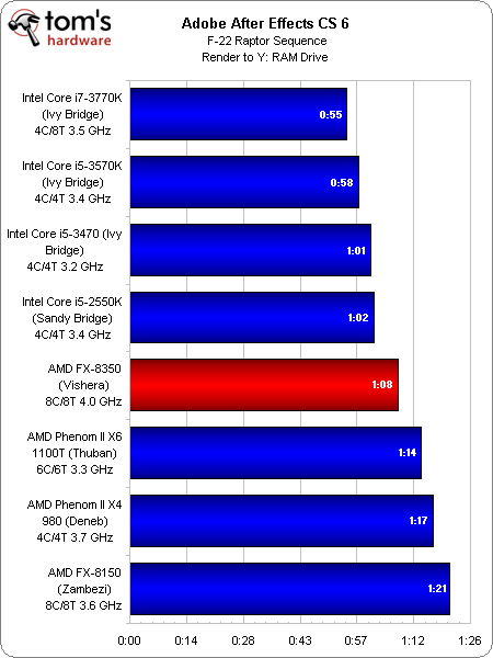

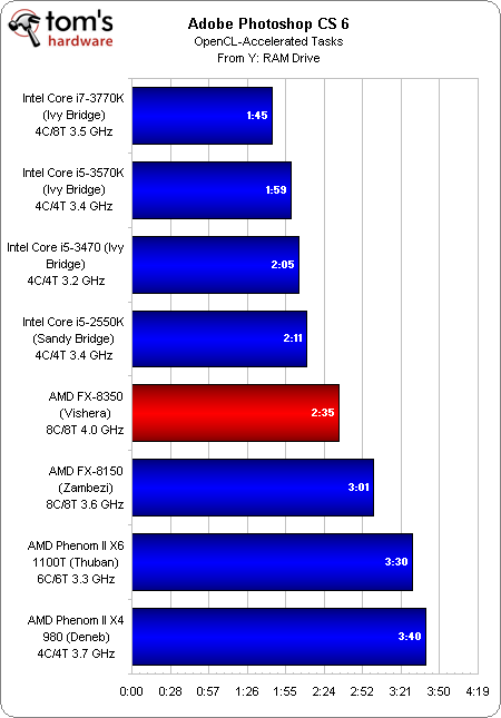

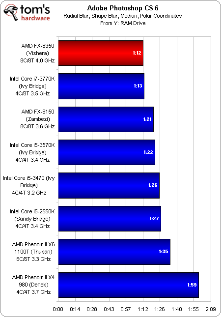

that ^^^ is hyperbole nonsense, modern games and applications they sit between an i5 and an i7.
its only really out of date applications and games like planet side 2 where intel have a significant performance advantage.
