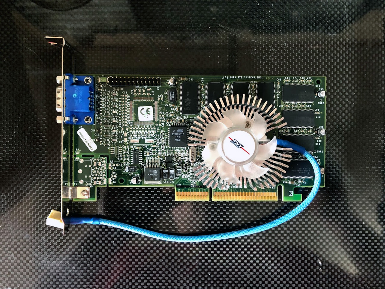

Here's how my V3 looks now:

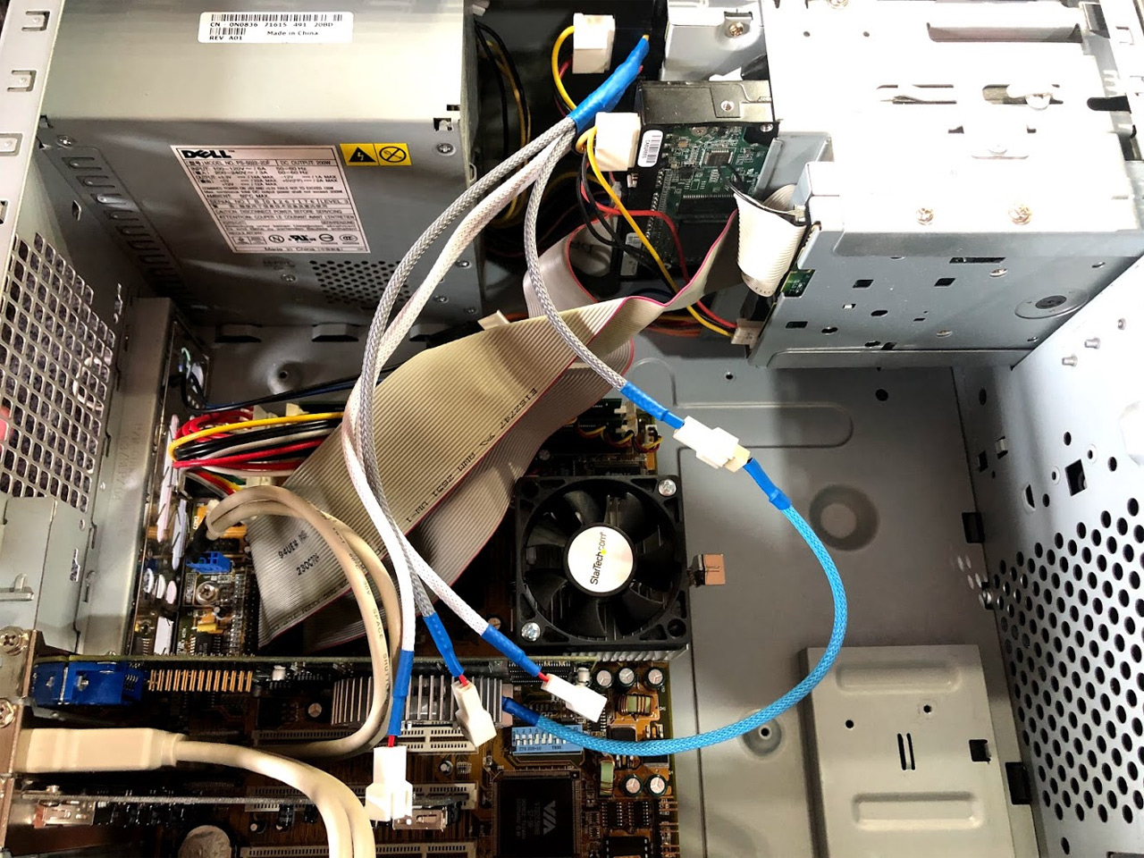

And I've made up (and braided) a 4-way fan to molex adapter, 2x 12v fan leads (the grey braided) and 2x 5v fan leads (white braided). CPU fan is still fast enough on 5v! Voodoo3 is connected to a 12v lead.
That's great, thanks! Will trust you in a bit. Cooler replacement looks decent, can't tell from the pics but did you use the existing mounting holes or thermal epoxy?
Thermal epoxy (but only in the corners), normal Thermal Grizzly hydronaut in the middle (so it’ll not be impossible to remove if I want to fit the original cooler).
I had to remove the mounts from that cooler so there was a slot in the cooler to allow for the crystal. I also had to shave the bottom edge of the cooler so it missed the AGP slot! The GPU is really low/close to the edge connector on the V3.
