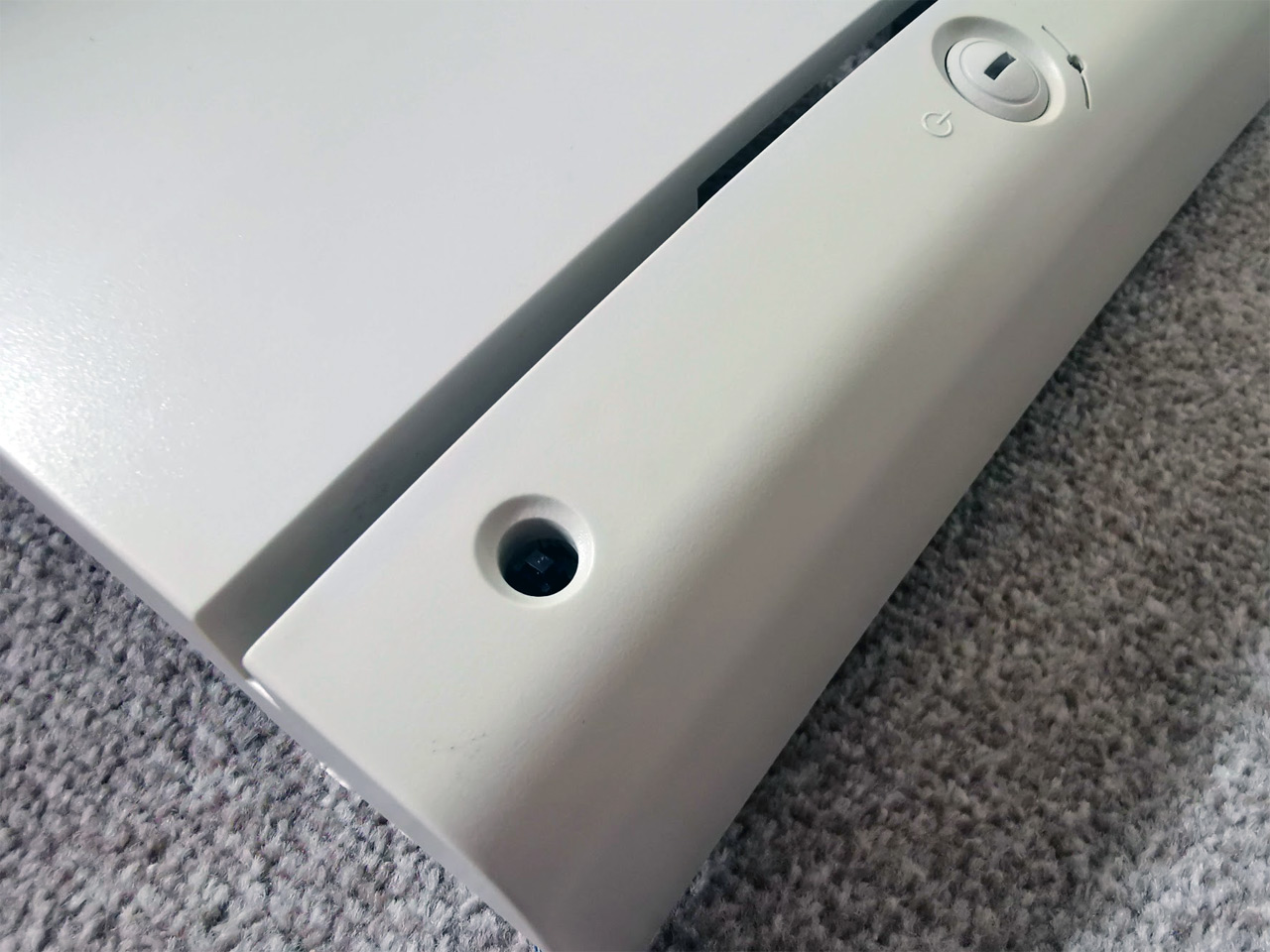

So the Fujitsu case turned up yesterday afternoon, it needs a bit of work, the front door latch is broken so the door slides down on it’s own rather than wait for me to want it to. The reset button is missing a lid (just a bare button at present) so I’ll need to work out a solution to that, and one of the standoffs/mounts for the front panel where it meets the chassis of the case is broken so that’ll need epoxying or plastic welding.
So today will be a deep clean of the case and fixing the bits I can fix. I’ve also ordered some bits and bobs so I can try and retrobrite the incredibly yellowed front panels.
Hopefully tomorrow I can actually attempt a retrobrite (my first ever).

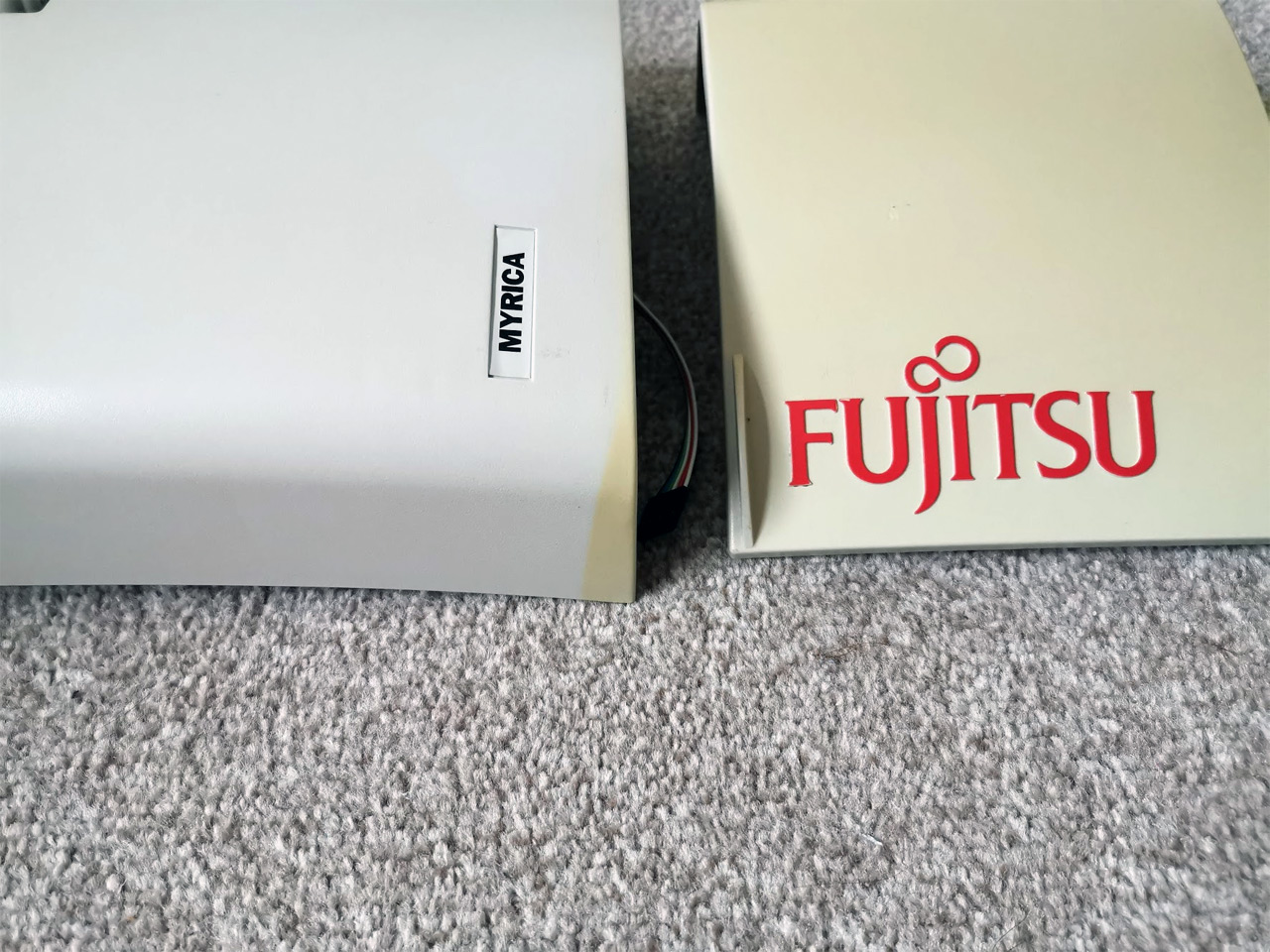

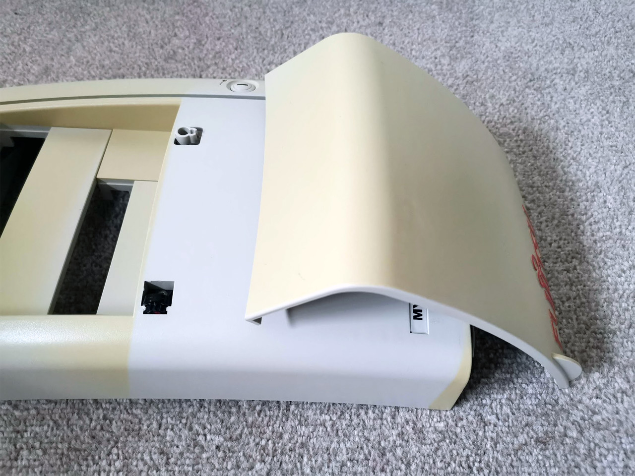

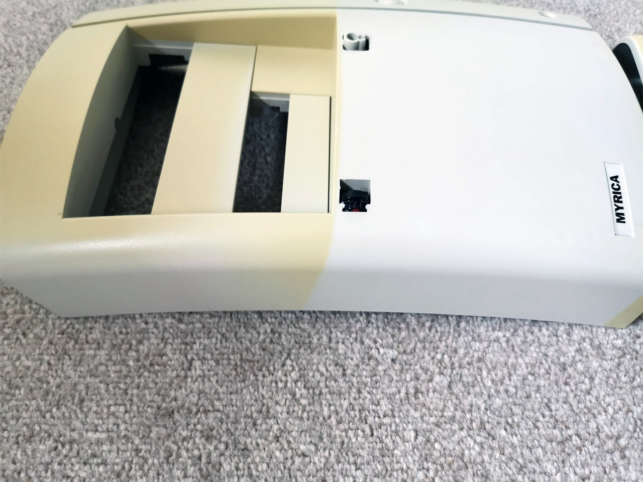

It can't be any more uneven than it currently is. Given the case's inherent sliding design part of it nice bright and light beige and part of it is an almost nicotine yellow.
Here's some before shots that I can hopefully compare with.
