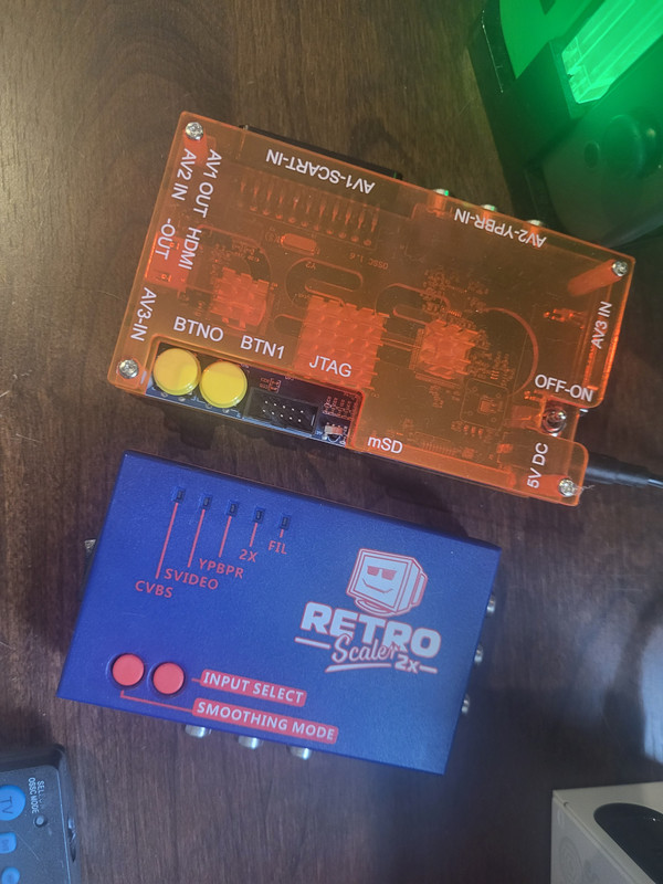

I have an OSSC v1.6 and its great. Current is v1.8 - basically anything 1.6 or above is what you need as this was when they introduced HDMI out.
1.7 has a better case, and power surge protection introduced due to them blowing up when connecting a Neo Geo MVS
1.8 just improves the power distribution a bit more.
Other than that there is retrotink or yes the old CRT route.
Just to add, 1.8 also adds x6 upscaling and lets you use firmware past v1. Older boards can be modded by lifting a resistor and running a bodge cable.
