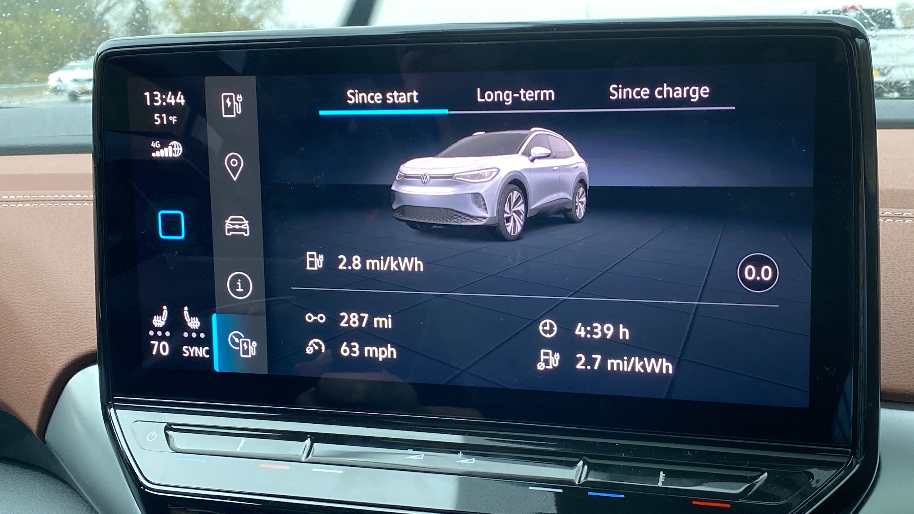

I have seen ID.4 motorway tests in winter at 1.5c in wet weather. Result was ~2.8 mile/kWh which would be over 200 miles for the 77kW versions. We would not get much worse weather here in the UK, so even worst case scenario 190 winter miles is realistic if all you were doing was driving at 70mph on a motorway.

I was about to post that I drove my ID.4 from Quebec to New Jersey in late October and averaged 2.7 miles/kWh with temperatures below freezing at the start of the trip and almost constant rain. Travel assist was set at 70-75 most of the way.

About right, I did 2 x 150 mile trips to Plymouth and back the other week at 3.5C in an ID.3 and got 3.2 m/kWh on the way down, and 2.9m.kw/h on the way back @ 70mph with travel assist on mist if the time, with a car very much full and air on set to 21.. that was effectively 185m of range one way and 170 miles the other..

I don't disagree with you. To get that 216 miles theoretical you would have to literally start out with 100% and run it to zero. It's not surprising that people get in their cars (charged to 80% because that's what the internet says to do) and then they run them down to 10% (because that's about as low as most people want to go) and they're shocked because they've only got 150 miles of driving. So if you left home with 100% you could do 195 miles at 2.8miles per kW consumed. but if you then rapid charged to 80% you'd only het 150 miles on the next leg of the journey. So the honest real-world range of an iD4, as most people would use it, at 70mph is really 150 miles as posted originally. It's not surprising that people are often disappointed by the range of their cars.
