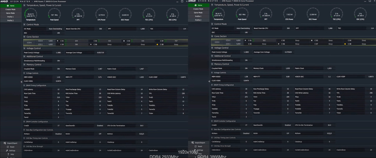

Finally got round to tuning this and settled on 3800mhz, for reference figures seemed to be slower when running 3600mhz with tighter timings, but could I get a sense check on the below please? Do those latency values look OK? Trying to tune for gaming.
1920x1080 2933Mhz(FCLK 1467 Mhz) Vs 3866Mhz (FCLK 1933 Mhz) AMD Ryzen 3800X Same performance its all about the timings​
DDR4 2933 Latency 76ns - DDR4 3866 60ns Timings in video
BF5 and GTAV same performance so lower and higher ram than in your screenshots
