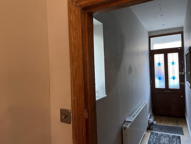

Can see in the hallway there is a large patch that spams from the window. A second, smaller patch futher down, and theres another near the front door.

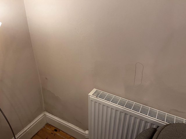

In the foreground - you can see there's a damp patch in the corner of the dining room. This one is most visible when the weather is humid. I had some people look at this a couple of years ago, and they couldn't see any reasson for it. Suspected it might be a cold spot caused by cavity wall ties.
In the corner, the wall gets damp. There are water marks on the wall further up and near the radiator.

and then looking at the edge of the window, where the big damp area is in the hallway

Have you checked if it's still sealed above the window? on your pictures looks like there is a gap.
Yep, it's sealed. I checked when the scaffolding was up for the pointing and it was sealed up. It wouldn't explain the other damage tho even if it was leaking there.

I'd still be checking around that window as there's clearly something to have caused the damp patch there.

Whilst the hall looks the worst, I’m more concerned about the patch in corner of the dining room. The hall looks bad because the paint has a sheen that’s missing at that angle / lighting
Counterpoint, it’s cold near the window so condensation forms there. The window is in the outer course of bricks, the damp on the inner.
There’s more damp than the window, that’s just the most noticeable.

Rotten/missing cavity tray above the window? Might need a new cavity tray and some weep vents.

Negating that option if there is a cavity, as has already been mentioned by @gingergundog I'd be looking at the window and the cavity tray, I had issues in an older house with no cavity trays whereby the window fitter went crazy with expanding foam and bridged the cavities the wrong way leading to similar damp issue which manifested around the window and diagonally out from the window about 12feet into another room.
