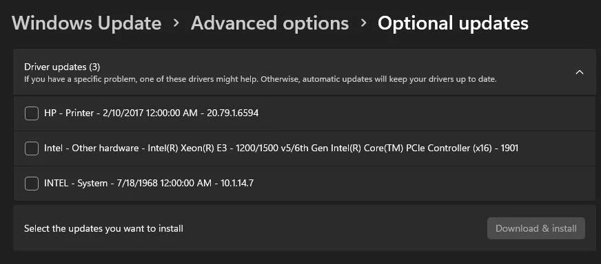

Under optional updates I do have an HP update and 2 x Intel updates waiting but 1 of the Intel updates has a date of the 7/18/1968......
I'm pretty sure I've seen the really old Intel update before and it's a mistake, of course. May be worth trying to install it as it'll fail if it's an older version but it might be that it's holding up the offering of a new version.

Installed both the Intel updates and still no 23H2 but as mentioned, I am in no rush for it.
