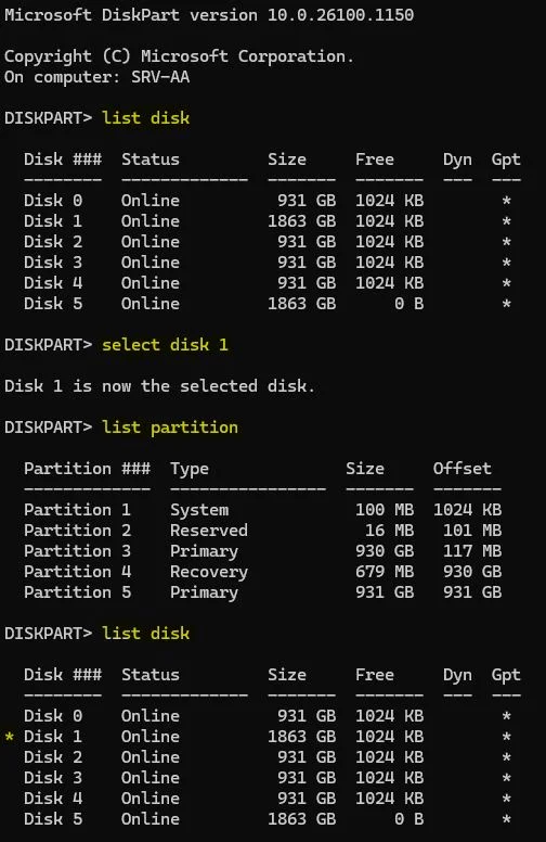

If it's not convenient to disconnect other disks, after DISKPART type LIST DISK and identify the OS disk by size. If you have two or more disks of the same size the select each one, e.g. SELECT DISK 0, SELECT DISK 1, and LIST PARTITION. Your current OS disk will have multiple partitions, System, Windows and Recovery.
Before you run the CLEAN command, always check you have the correct disk selected. Run LIST DISK and look for an asterisk next to the disk.
