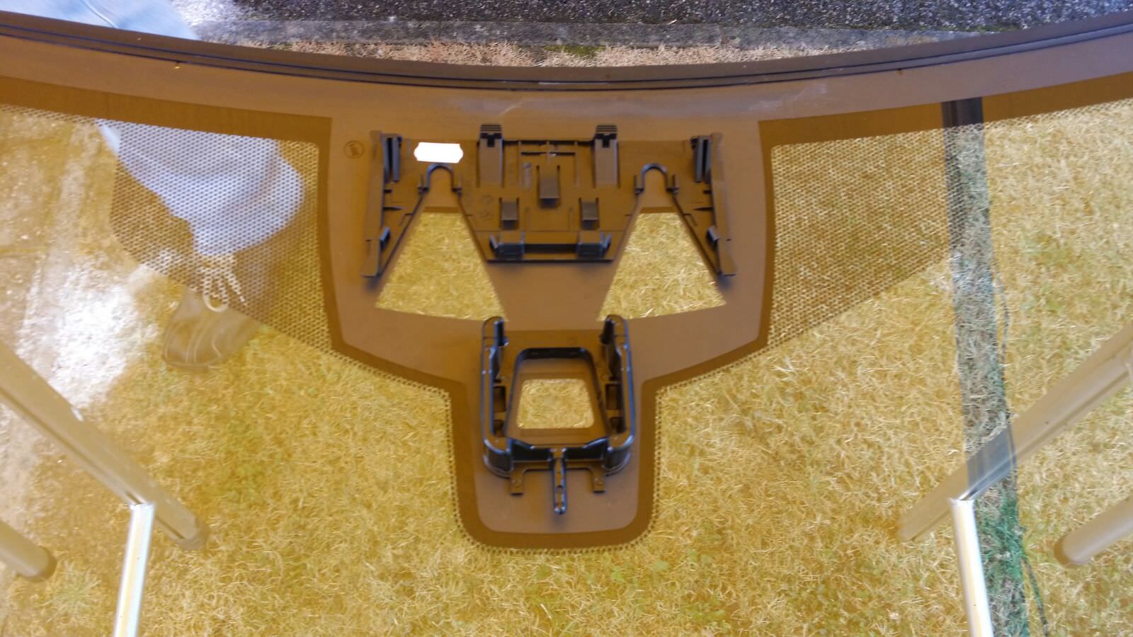

Here's an example from a Jaguar XE. Rain/light sensor clips in on the central trapezoid with the rear view mirror sliding over it onto the bracket, then the camera/radar module clips in along the top edge just above the two triangular cutouts
Why would that need calibration? It is all fitting in place.
It's almost been designed that at the manufacturing line you fit everything and it is ready to go.
In my case, you are right, there may have been clips (I thought you meant it was plugged in some way).
It does but the windscreen is never going to be in exactly the same place.
Half a millimeter difference in the height of the adhesive for example can change the angle that the glass is sat, which results in the camera also being at a slightly different angle. That minor difference could easily be a couple of meters 5 car lengths ahead.
