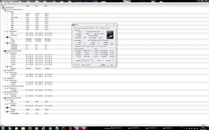

Just a quick update!
So, I thought I'd restart all this overclocking malarky and have another bash.
Downloaded and installed the latest bios, this is where everything started to go incredibly wrong....
It reset everything and I couldn't remember what I'd set my last overclock to.
So did a best guess sort of thing. Don't do a best guess.....it's just going to lead to bad things happening.
After putting my settings in and rebooting I'd inadvertently opened the 7th gate of Hell within my little Silverstone Raven case, this resulted in a BSOD and a wiping of many essential things that required little old Windows to start....mainly it had lost the MBR etc.
No problem a repair should sort that.....Ya thunk? Well no.
After much searching on the internet and many hours at the command prompt entering code configurations that would put the German Enigma to shame I finally got the beast to boot.
This was at 3:30am.....Work at 6am....no that wasn't happening.
Anyway long story short I diddled about some more had a few more crashes resulting in the same code entering scenarios but managed to get he system back up but with a lower overclock of 4gb but the NB is now running at 2800.
The asus sabertooth has lots of settings and though it does some things well, it does others not so well. My main problem was setting my memory to 1600 and thinking it would set the timings itself as per spd for 1600. It doesn't which resulted (I think ) in the crashes.
Whilst dabbling I did manage to get into windows with an overclock of 4.85, can't remember how I did it but I took a screenshot for posterity! didn't do any benchmarking at this but I may try :D
I wasted most of today fiddling as well....in fact....I hate pc's now :(
It is good to see you all had a good discusion though and brought some interesting information to the masses!
So to summarise,
4ghz
Bus speed 200
ht 2000
nb/cpu 2800
cpu voltage 1.425
Think I may have more success upping the bus speed!
Thanks again :D
Well that image was a waste of time :D
