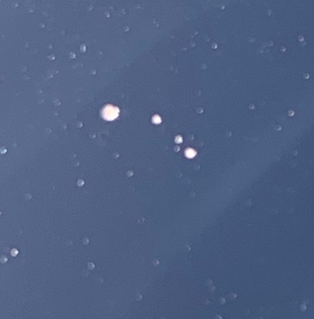

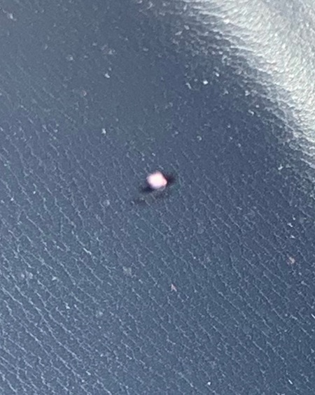

My windscreen hasn't changed since the last MoT a year ago, the 'damage' is one tiny spot and one small area of marks. The spot is in front of me but right at the bottom of my eyeline and the marks are off to the left a bit.
The former is less than 2mm in diameter and the latter is over a 10mm length. These pictures from the outside make them look really visible but they're not.

I would personally, as it would bug me even if it didn't get in my line of sight. Just knowing it was there. I guess it depends on your insurance and how much they'd charge
Is it not repairable? I always thought the consensus was to try and keep the original windscreen for as long as possible.

I described them to the insurance and they said from my description that the small cluster are too close together and that there are too many to repair. I might pop into an Autoglass and see what they recommend.
/edit - I've checked the Autoglass website and it confirms that if there are more than four dinks then it can't be repaired, it has to be replaced.

So long as I didn’t find myself being drawn to look at the marks whilst driving then I’d not replace it, repair via that Rainx stuff if I could be bothered though.

I wouldn't bother - give the above diy repair kit a go, and you may even be able to make the chips disappear enough to not get an advisory next time.
The alternative is to pay your excess (£75/£100 or whatever), potentially get a poor quality replacement/badly fitted, and if you're really unlucky end up with another chip in a few days/weeks time that you genuinely need a replacement for

I am of the view that those pock marks should be fine to repair. Properly done, the repair will create a vacuum and draw any air out of the dent, replacing it with the UV hardening resin. This should restore the structural integrity to the glass. I used to repair windscreens with a proper kit and you would be amazed at what you can safely repair. The problem is when the windscreen flexes, as it is a structural part of the car, a chip can lead to more air being drawn in-between the glass and the underlying plastic layer. This then leads to a further loss of strength. Properly filled and sealed, I don't see why those dents would impact the structural integrity of the windshield...
In fact, the kit I used to use was the same one they use in Lemans and the instructions said it could repair cracks up to 30cm long or something... Though personally at that point I would replace the windshield.
Have those marks even gone through the glass?
They’ve gone through the top layer of the glass but because there are more than four of them, they won’t repair.
