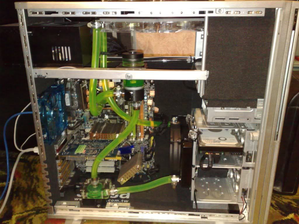

Found one I`d posted elsewhere, sorry it`s not a great pic. Should let you see the level the fan is at though. I had covered the remaining parts of the square mesh with Akasa foam so they weren`t visible.
I see what you mean now about the back panel, it might look a bit strange if it`s left as is, but with the bigger fan there.
I had a 120mm.fan in the front as well, to replace the existing 2x80`s but didn`t bother drilling out any of the front panel.
