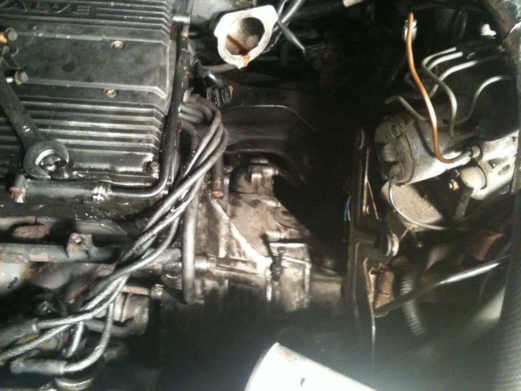

Lots of progress, took pretty much the whole front end apart (you'd be surprised how close to the truth that is!) and got the gearbox off, replaced the clutch, and got it back on.
Now to get the running gear back on, fit the new exhaust and decat, and blow the cobwebs out. Roll on tomorrow. :cool:

Gearbox back on after a clean (was much worse before!)

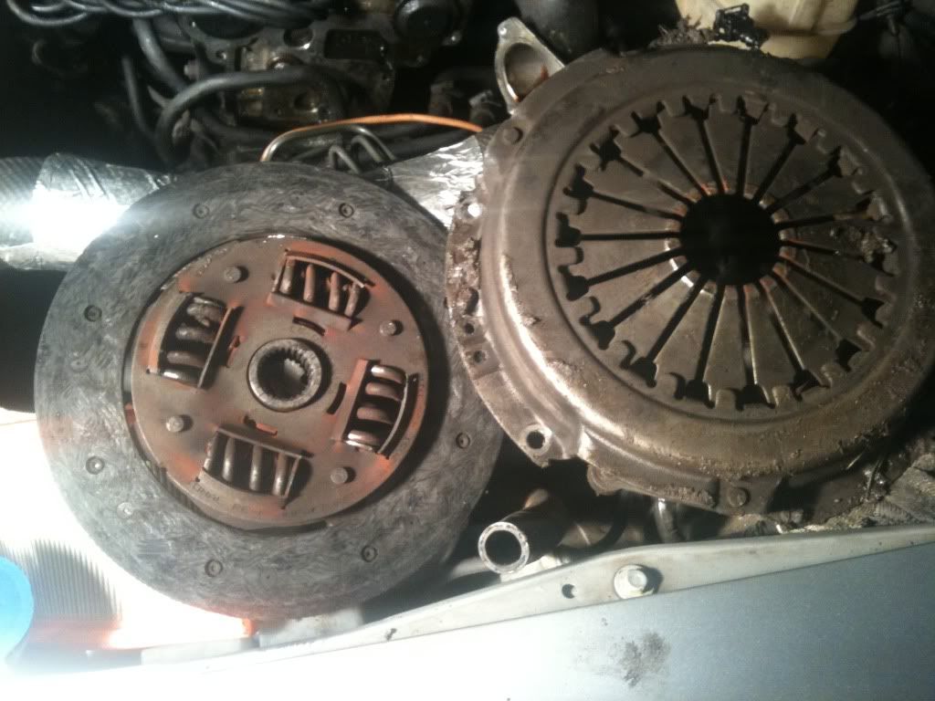

Knackered friction disc:
Wait, what's this?
Cheap, rubbish clutch, that's what. FFFFFFFFUUUUUUUUU
Old clutch and pressure plate.
Going to go outside now (in the rain..) to fit the rest, should be done by later. :)

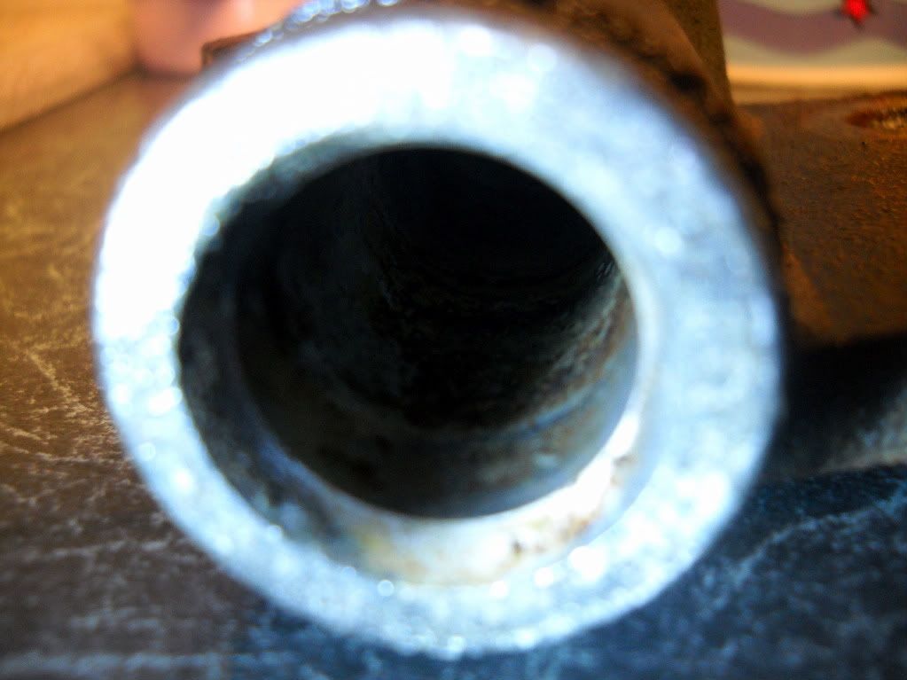

Slave apart:

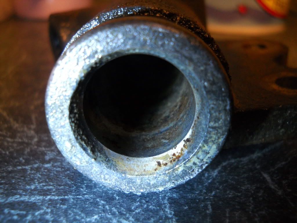

Bore of the slave cylinder itself:
So yeah, that's pretty corroded.

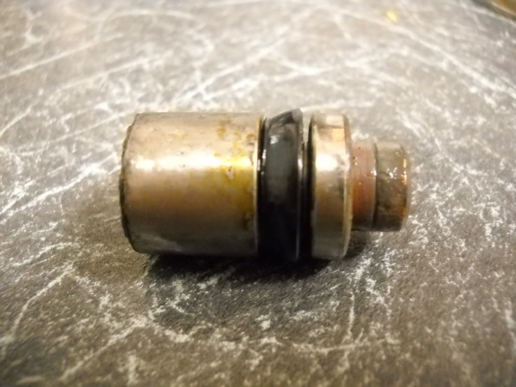

Piston:
As you can see, all a bit old and flakey.
