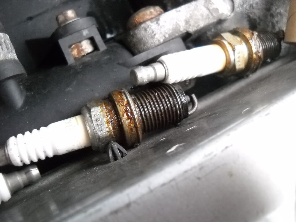

Today's work:
1. Running crap under hard acceleration, so changed the spark plugs as they were black as ****. Cost £4 for a full set of NGKs as they're the cheap as chips BKR6Es, as recommended by most tables for the 620ti.
Old one:
All done:
Running much better! :D

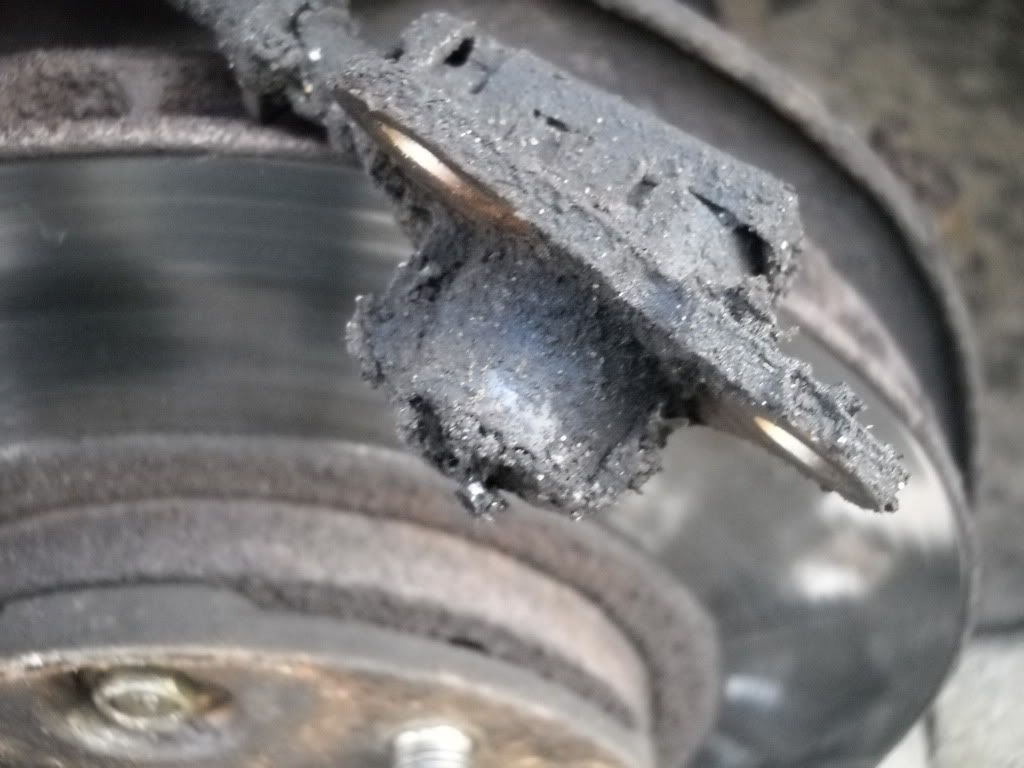

Also, the ABS light was intermittently coming on, so I got a new sensor off eBay and set to work. This would be the cause of the problem... :eek:
All sorted now, light off and have ABS back. :cool:

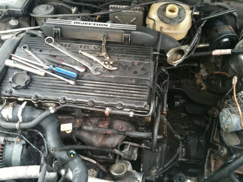

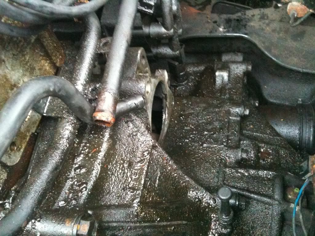

Clutch replacement time.
Updates as promised:
One very knackered coolant rail, got a replacement as I knew this was going:

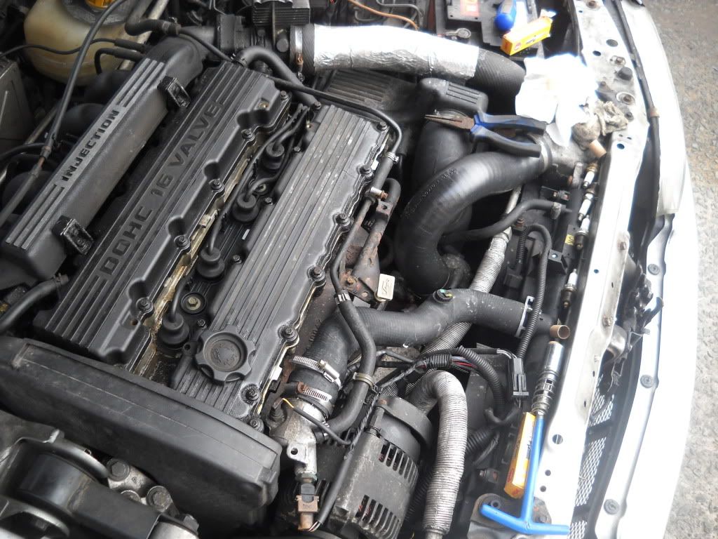

Bits and bobs I've been pulling off:
Gearbox side cleared of ancillaries:
Gearbox, covered in oil (to be cleaned off, oil leak has been sealed up)

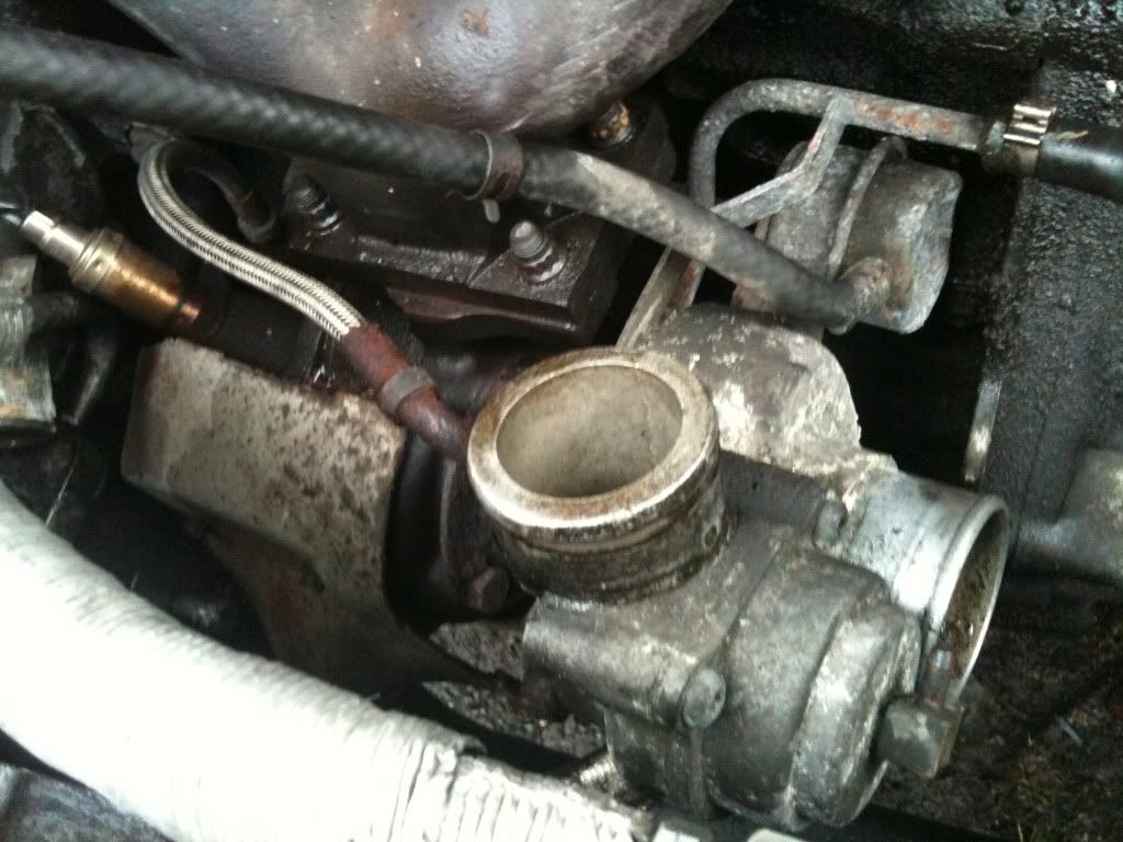

Teeny tiny turbo:

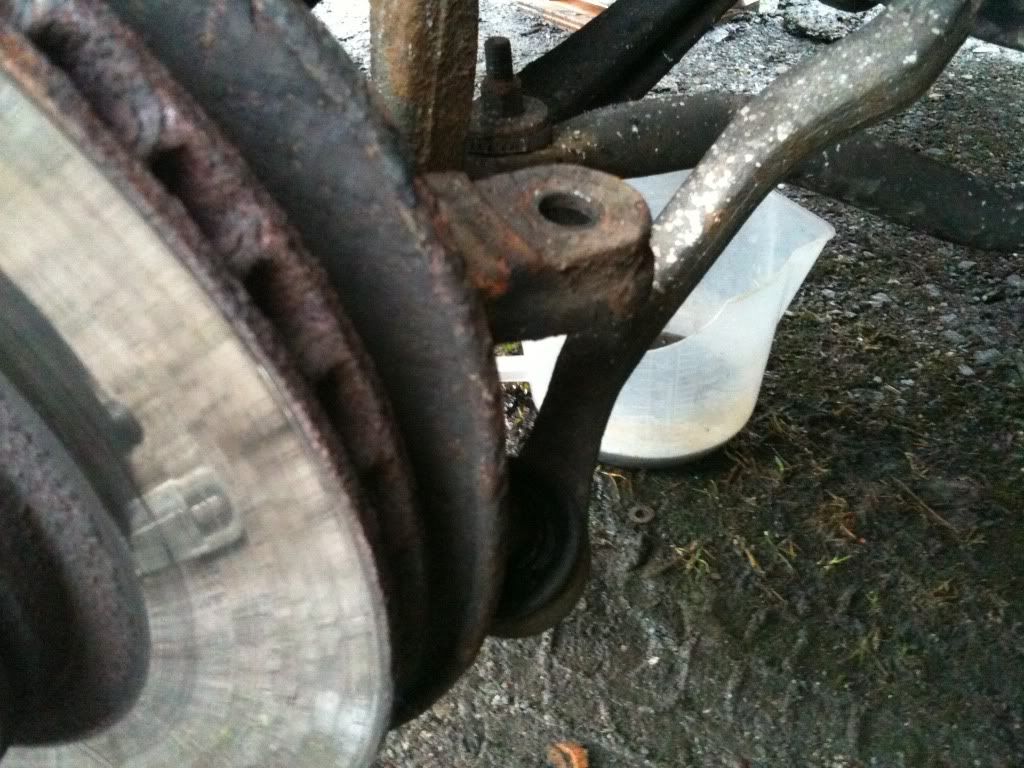

Draining gearbox oil:

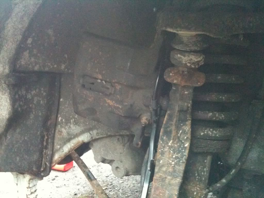

Caliper tied out of the way:
After a furious beating the track rod end finally came out:
I did a lot more but didn't get pictures, was pretty grim weather and iPhones don't like car work. :p

Good job though. Those old plugs look a bit oily on the threads? Did you get the new plugs from eBay? I've been looking for some. £5 posted compared to £12 from Halfords.
Can you not remove the bolts from the tie rod to the lower arm, undo the lower arm to chassis bolt and then pull the shaft out of the gearbox as the hub will be free?
Saves buggering the TRE then.
Not sure on the suspension arrangement on the 600 but that would work on the 200/400.
