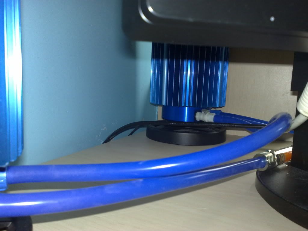

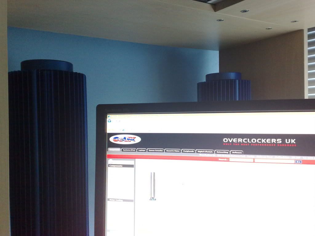

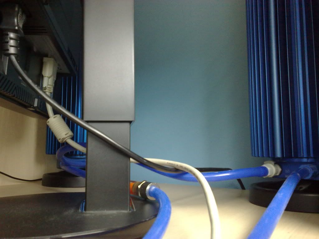

heres some pics of my setup , gonna put some LSX through 1 hole!
And no-one believes how quiet they are. I usually have to check the light to make sure it's switched on.
Looking good with the blue towers too..

done mine, filled the hole up with some lsx and that will harded over the next hour! hopefully il c some improvements lol wow now part of the dual reserator crew! lol
