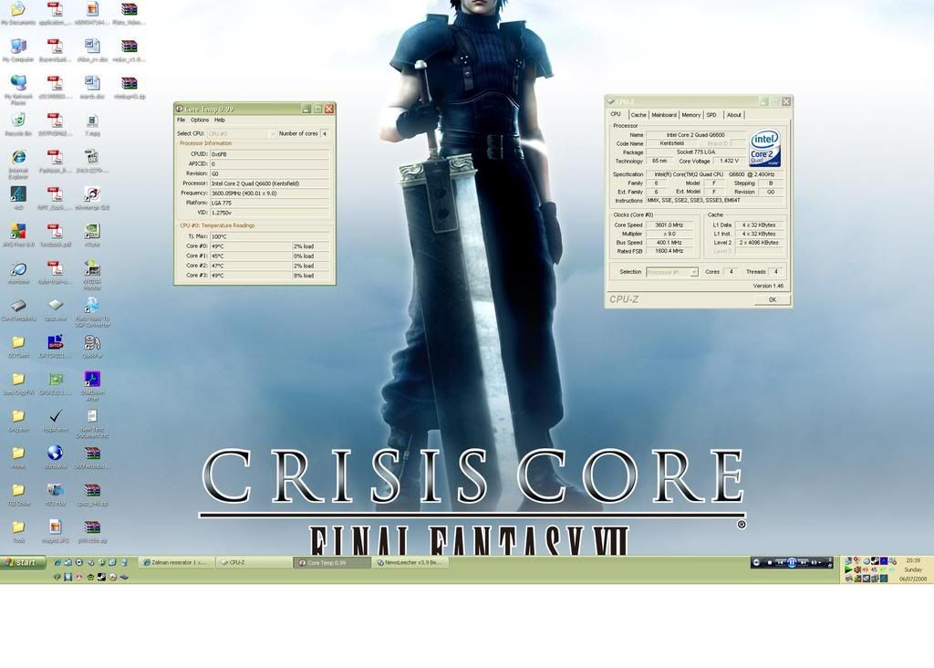

right been testing since my last post, ive got 3.6 stable but temps do rise up to 80 :-( but then the reserators hold the heat and takes some times to get to those temps up and down! im happy with that and im not gonna try to enable intel speedstep so its only at 3.6 when i need it! obv il be running prime95 again to see if thats stable!
