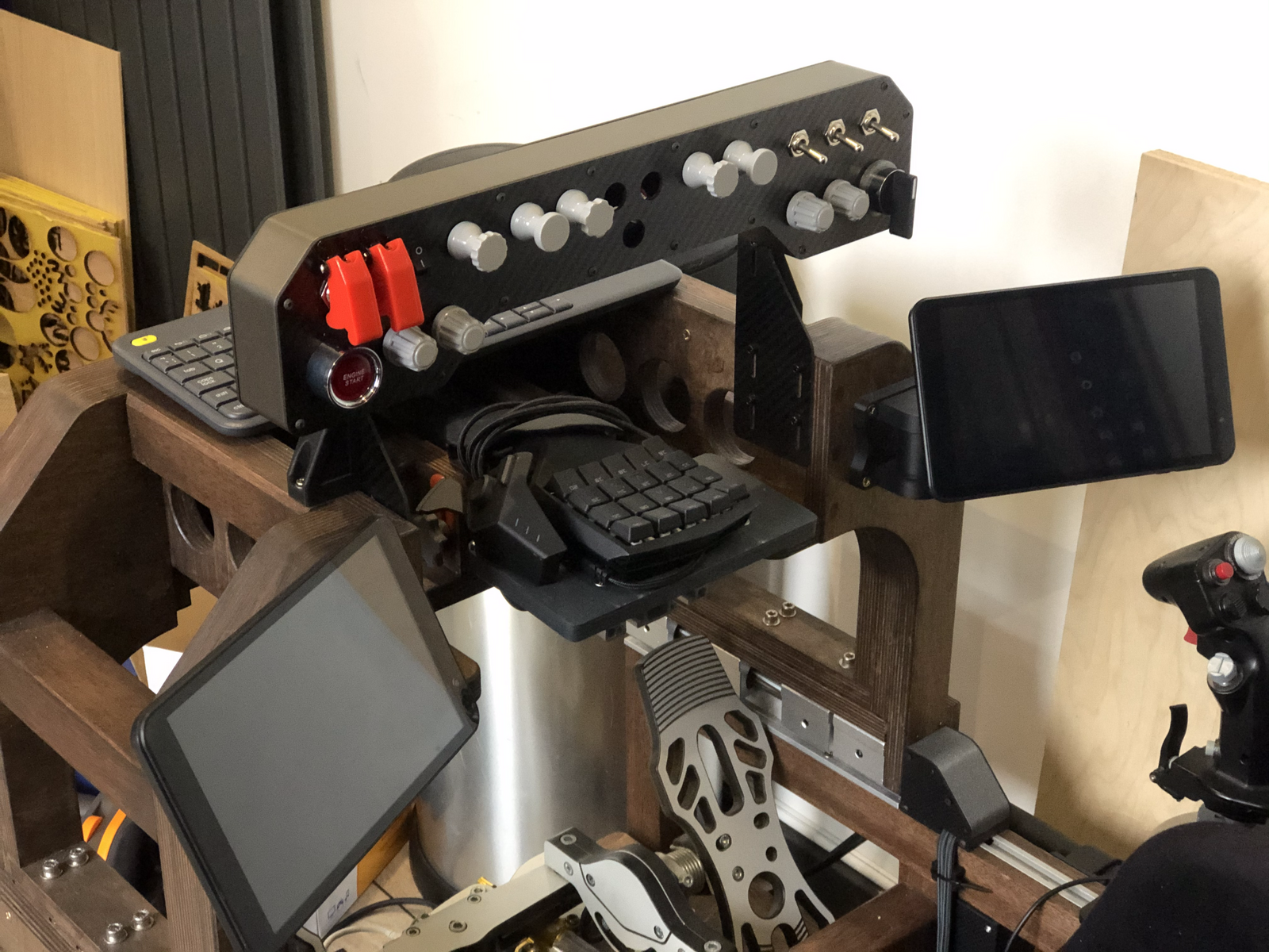

Zee Sim Rig
Thanks!
@koolpc - Quite a difficult question to answer as so much of it is made of scavenged parts and leftovers from other projects, a lot of custom bits are 3d printed and the chair was a gift from a couple of years ago... so short answer is not really got a clue lol. Probably about £250-300 of new stuff to build the thing itself, wood and miscellaneous parts etc... I think the shakers and amp together come to about £500 although the big one (BK4-A) was £270 of that on it's own and again was a gift. The tablets I got for about £60 each in the sales.
Mostly finished the button box now, mostly just waiting on the 3 sqaure buttons for the centre which seem to be stuck in a post office somewhere.

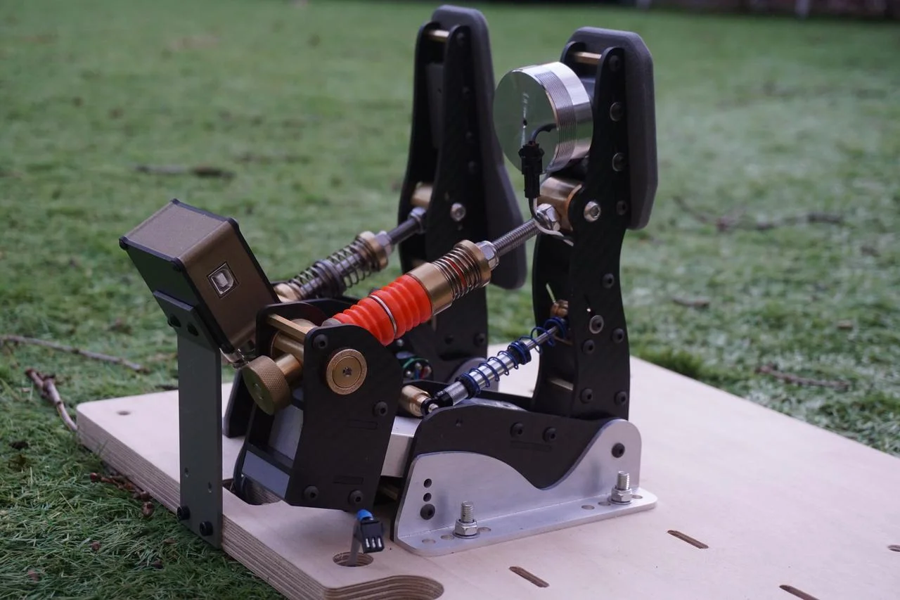

In other news I made a start on my pedals after finalising the design:

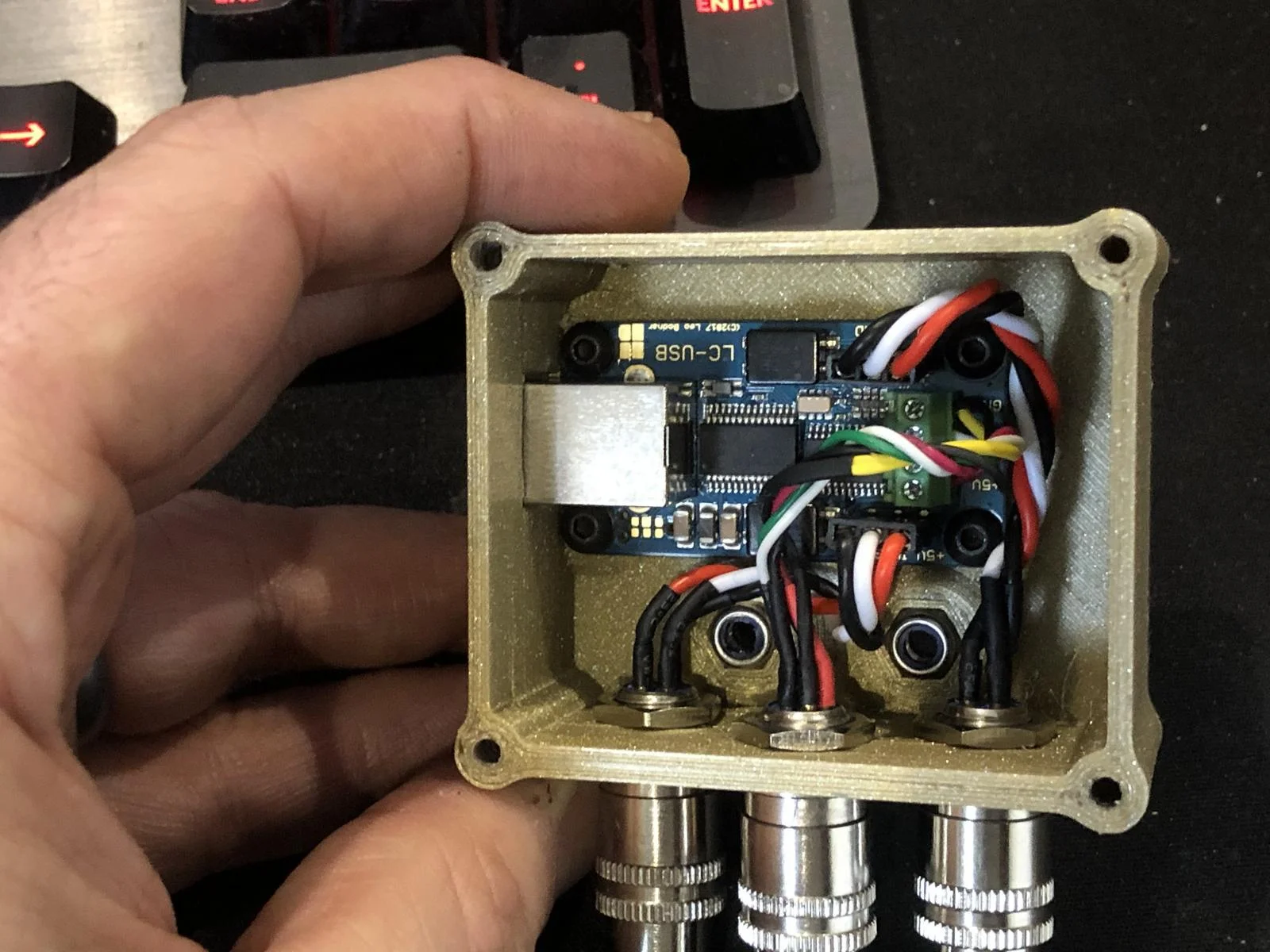

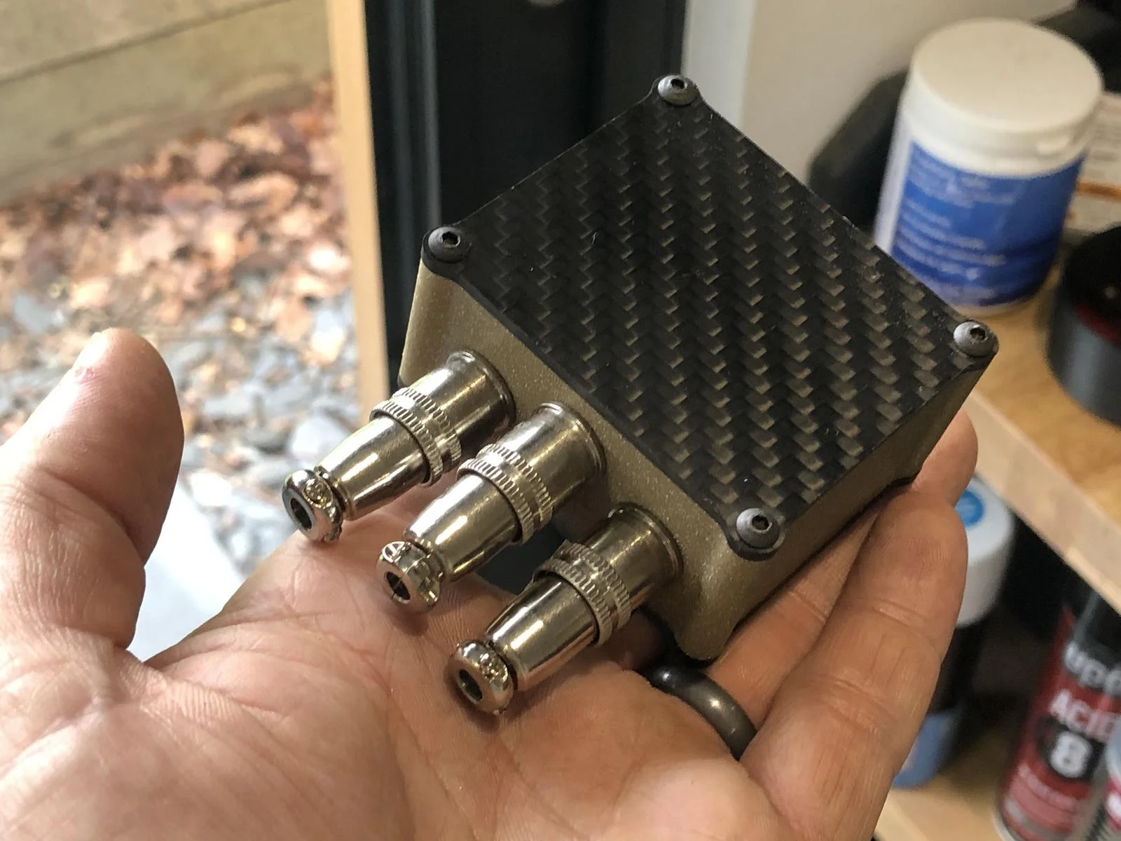

3D printed and CF Electronics box I whipped up housing the Leo bodnar LC-USB

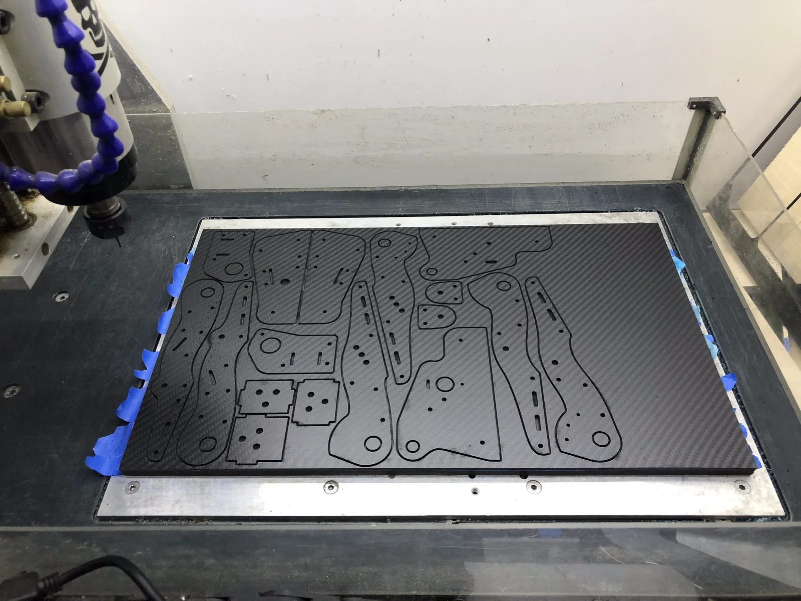

Cutting frames out of chunky 3mm plate
Brake pedal is up first (printed bushings are temporary, waiting for some oilite bushes in the post :

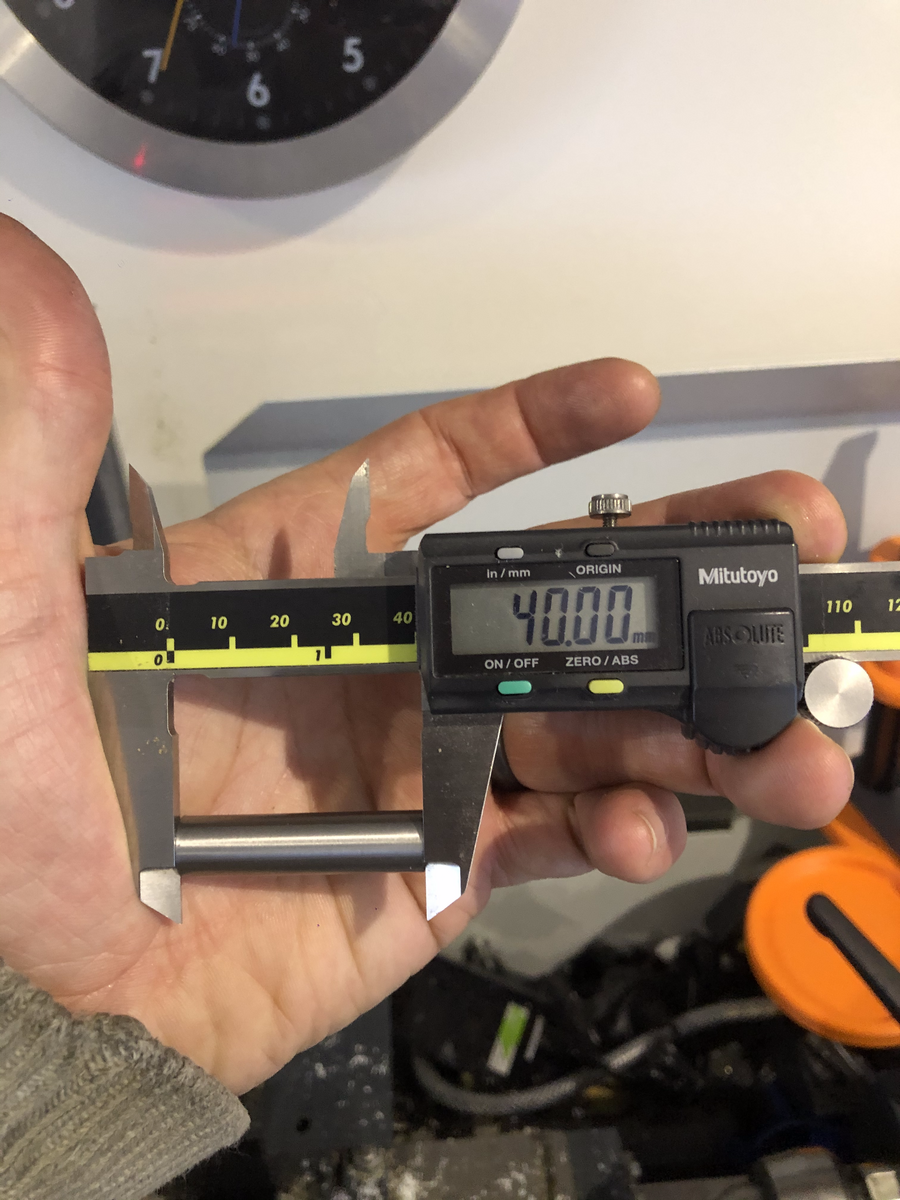

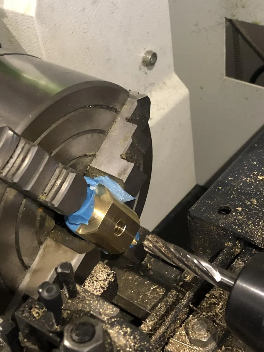

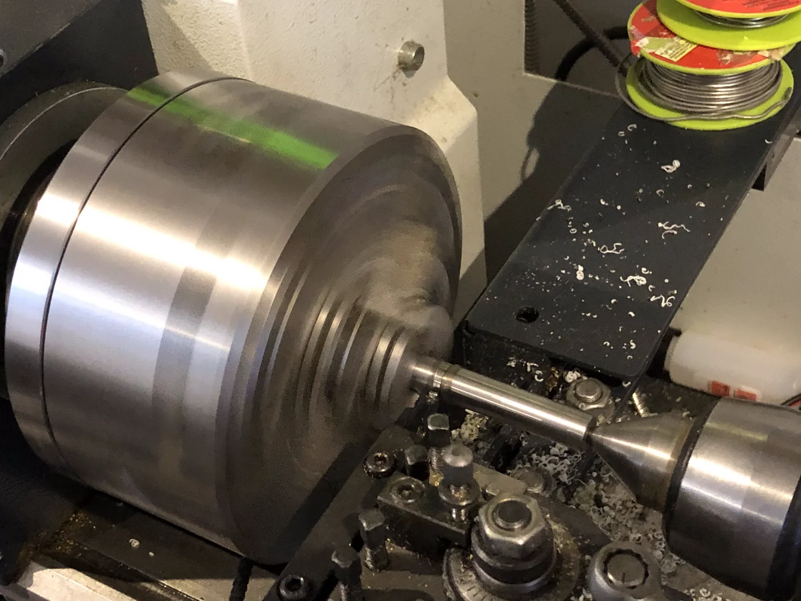

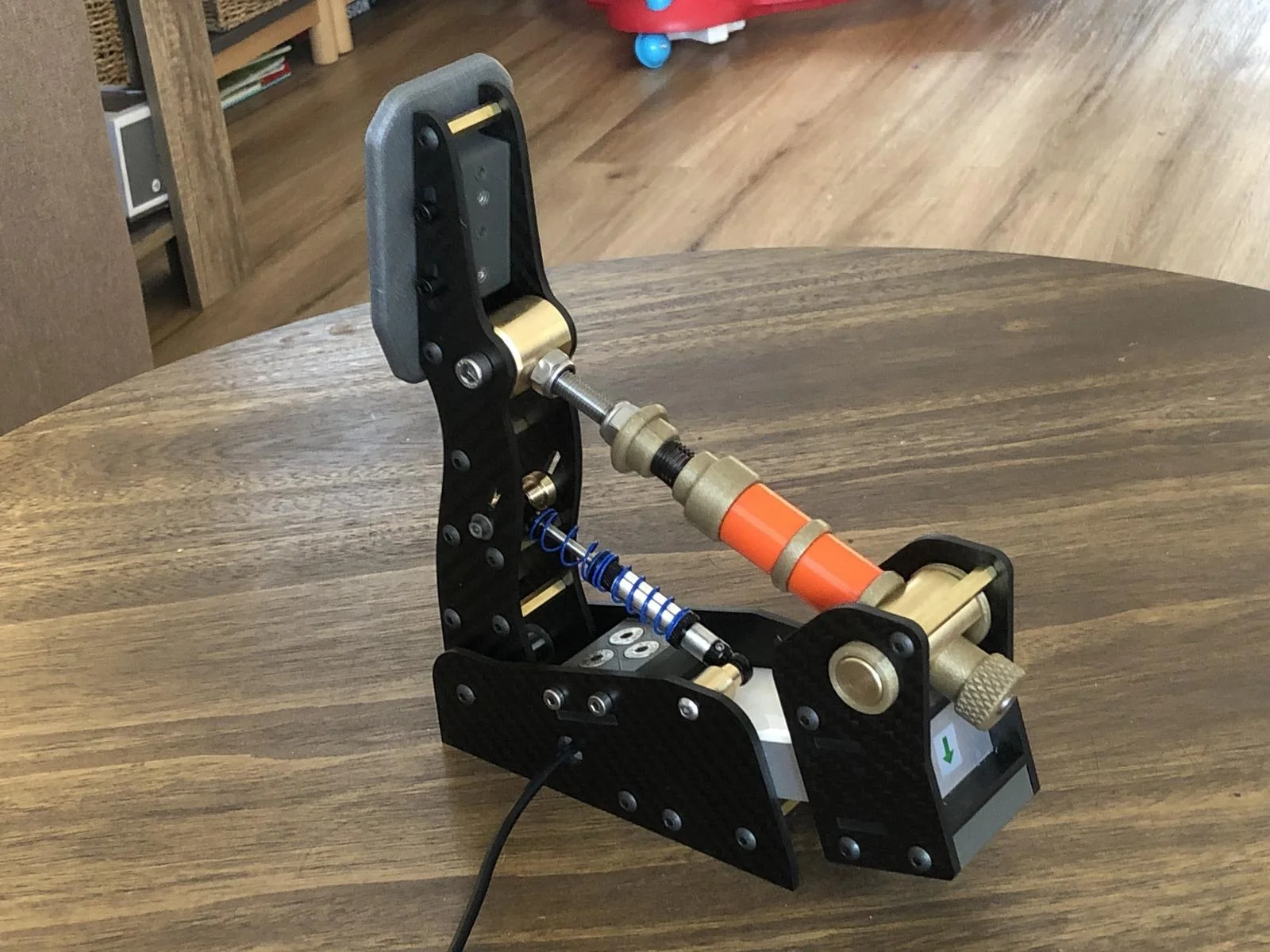

Almost done on the brake prototype, currently a mix of 3d printed components and parts made on the lathe... most of the 3d printed parts will eventually be replaced with milled/lathe parts once I'm happy with the design.

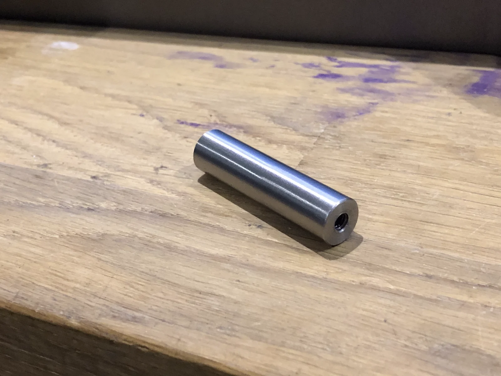

Few shots of parts in the making:

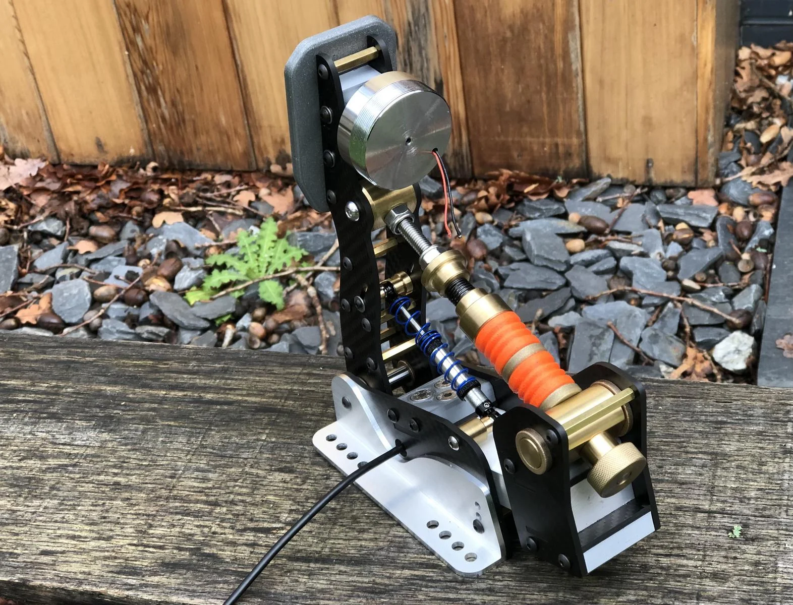

And where I'm currently at with the prototype - I'm waiting on a few parts such as oilite bushes, springs, and a different damper. The small black spring on the main rod is temporary just to see how it works, the final spring will be like in the render where it goes over the guides. The idea is to give an adjustable distance travel before hitting the elastomers to simulate that first lighter bit of travel where you are just pushing the pads onto the disc.
The "elastomers" are also 3d printed from 85A durometer TPU (orange is all I have!)... they are possibly a bit hard so I'm looking into alternatives but can decide that once I've tried it.
Only thing left to do before the brake is functional is to machine the side mounting brackets.

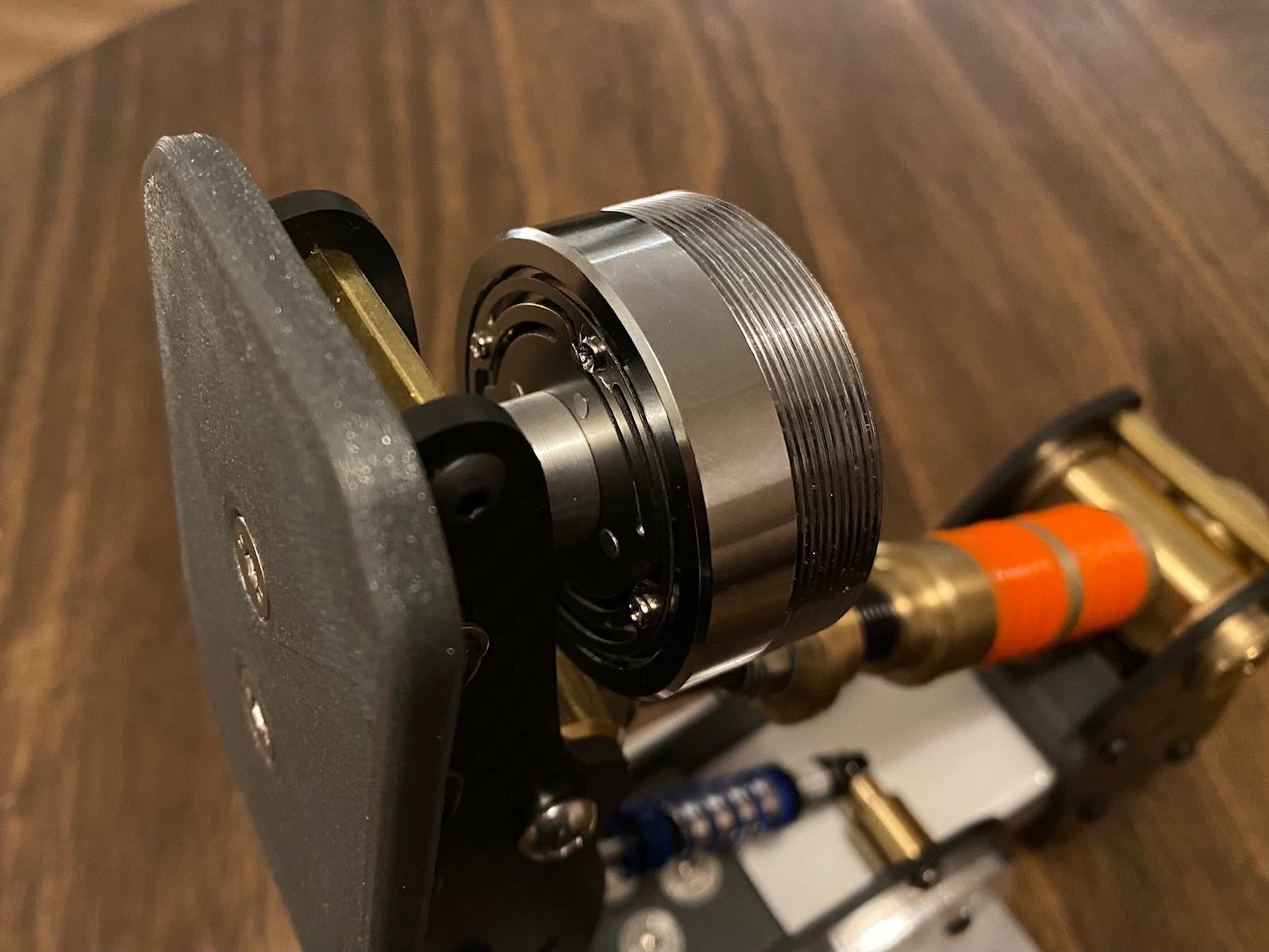

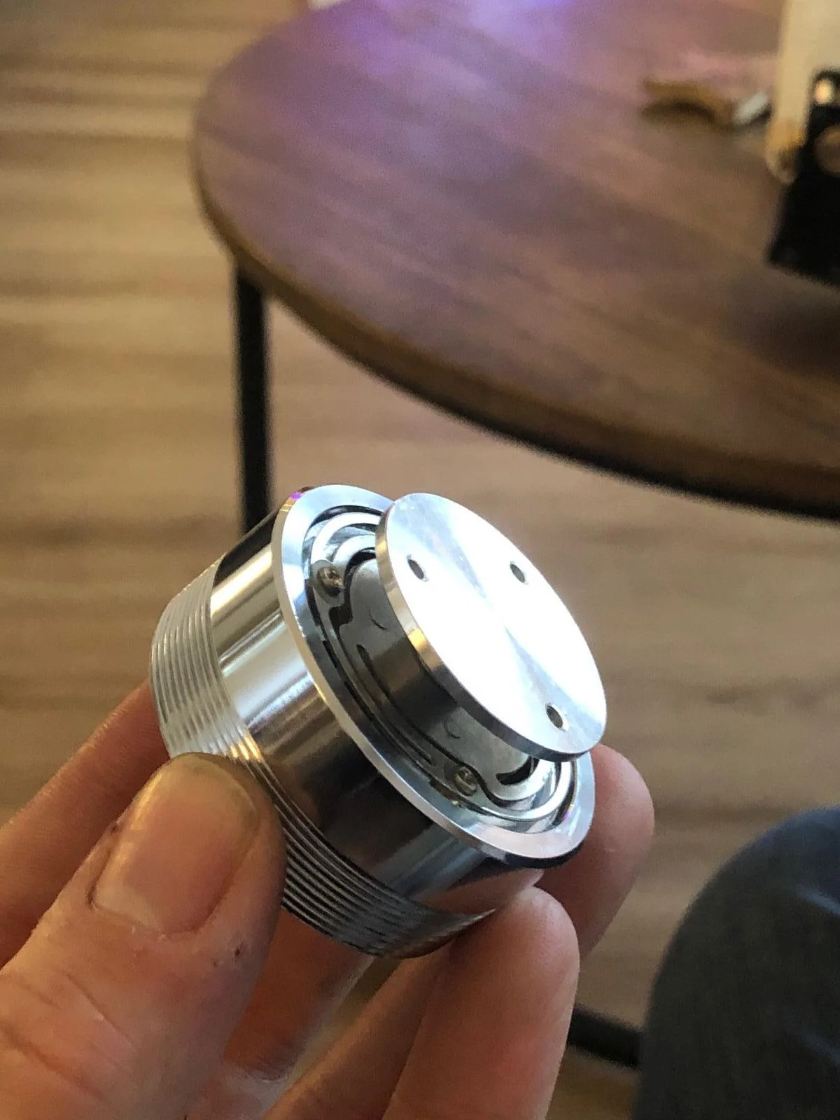

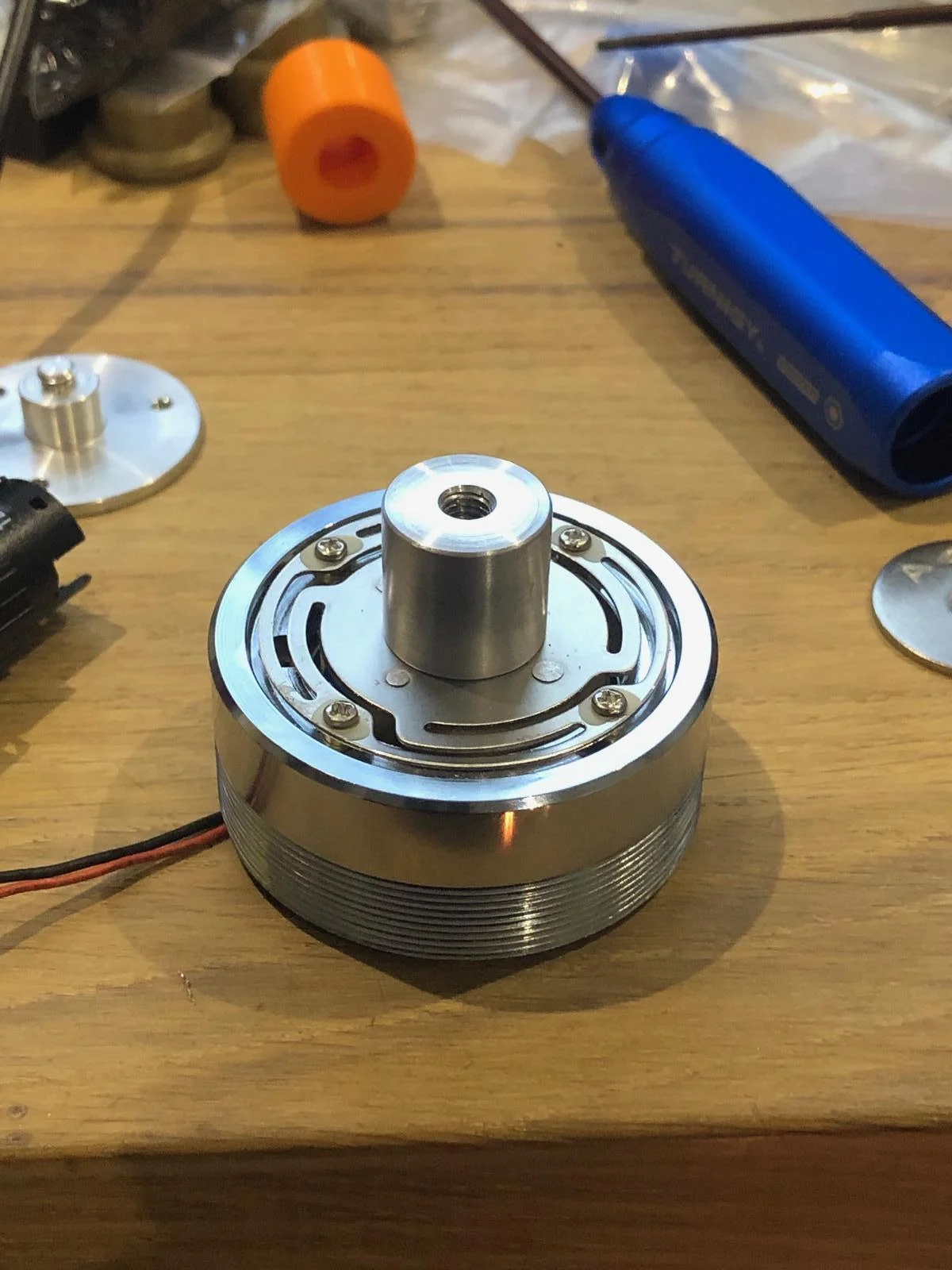

Anyway, resonance speaker arrived, just had to make a little adaptor piece for it
how she comes:
Adaptor nubbin:
And mounted:

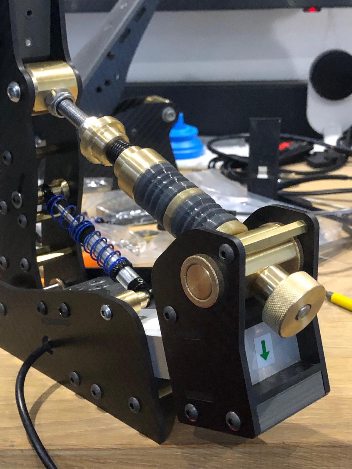

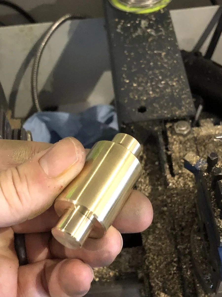

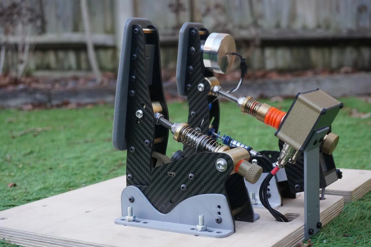

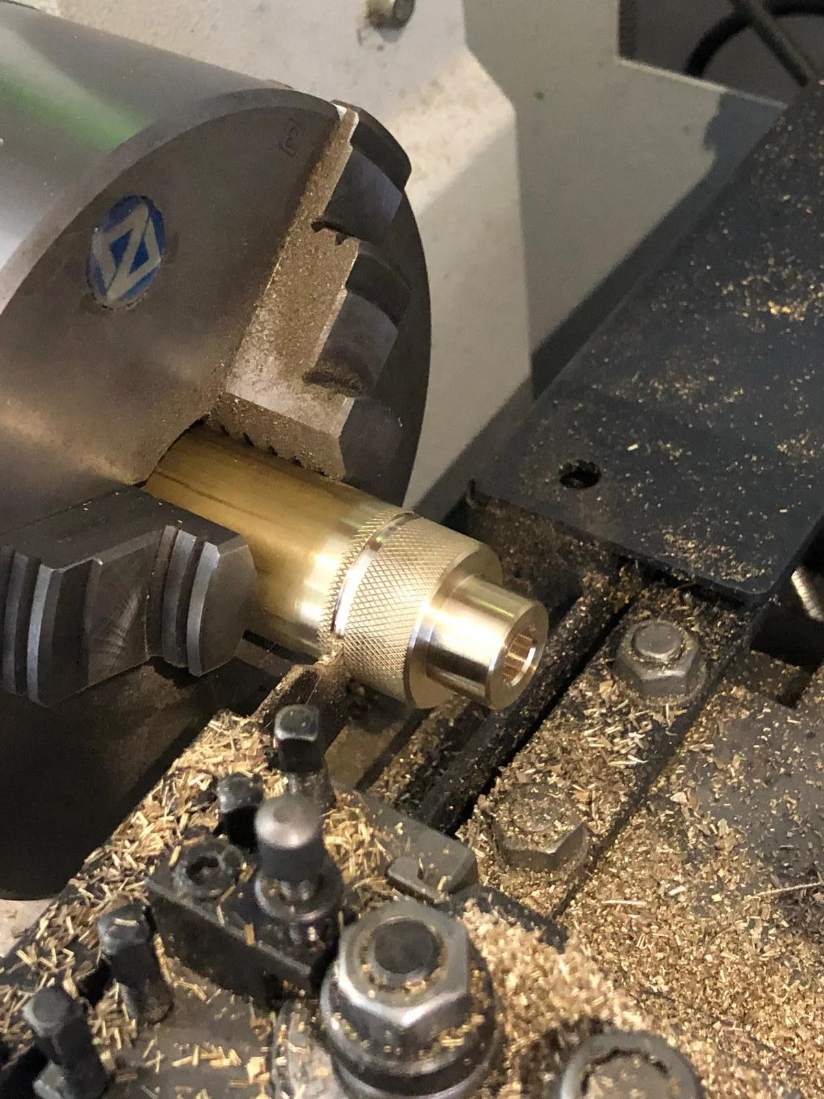

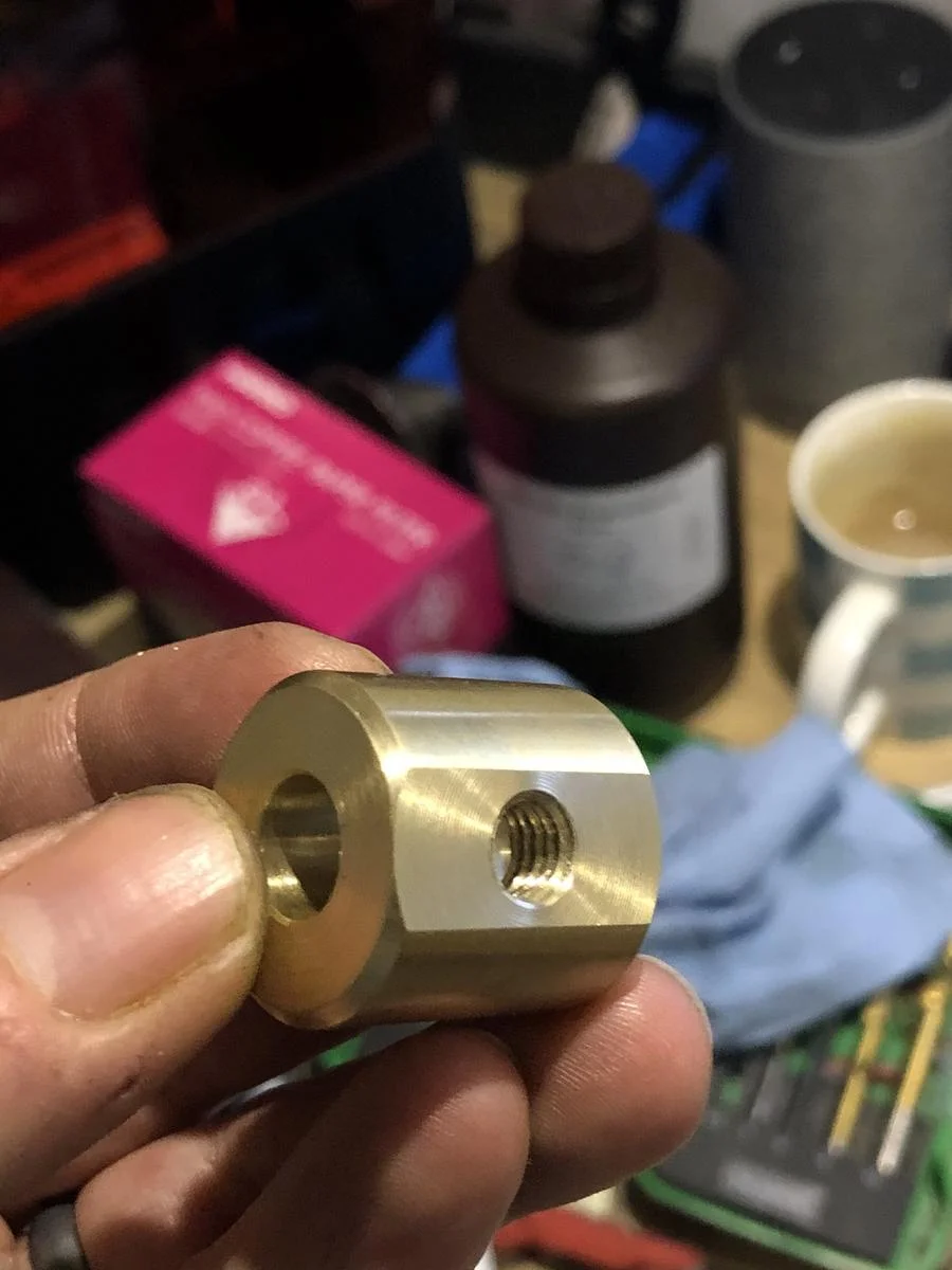

I remade the thumbnut and upper spring guides in brass rather than 3d printed:
You can see there I've also been playing with designs for 3D printed elastomers - those are 95A and just too stiff even with zero infill, but switching to that ribbed design and gyroid infill using 85A ninjaflex works great. Unfortunately I only have orange for now but will be changing that over to something a little less garish. It's quite cool 3D printing them as you can vary the stiffness even in the same material just by varying the infill...

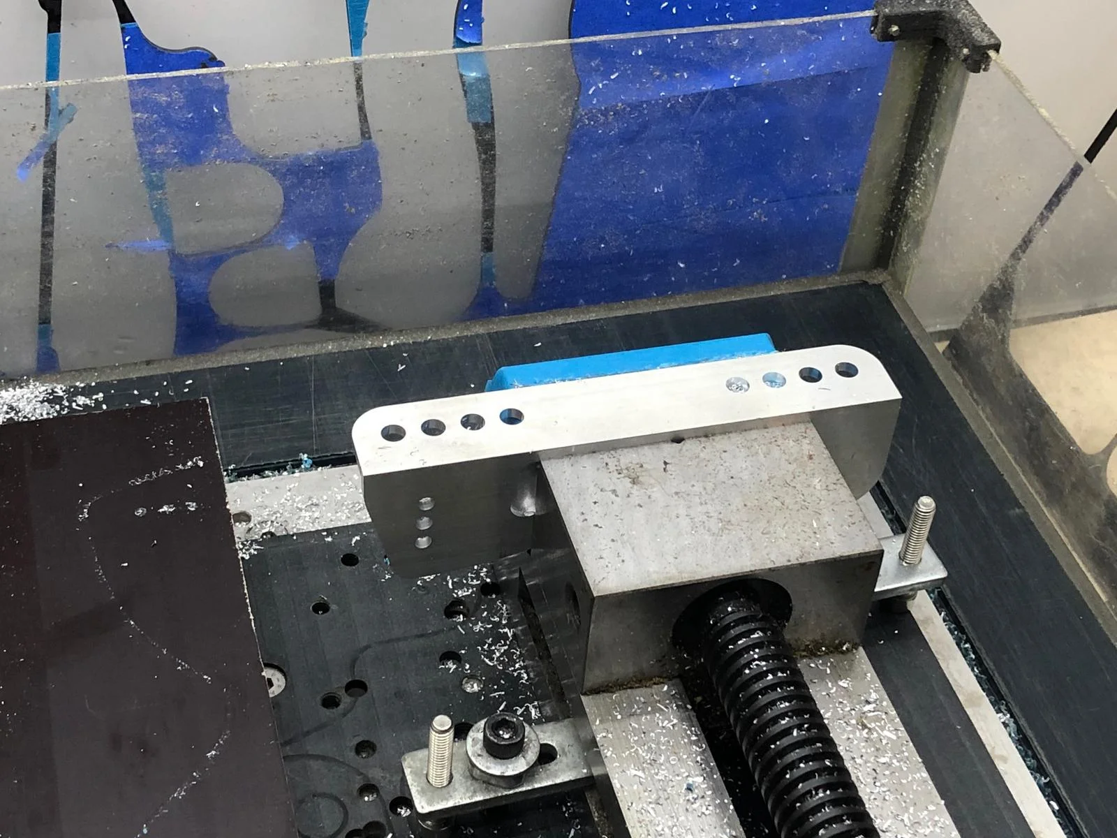

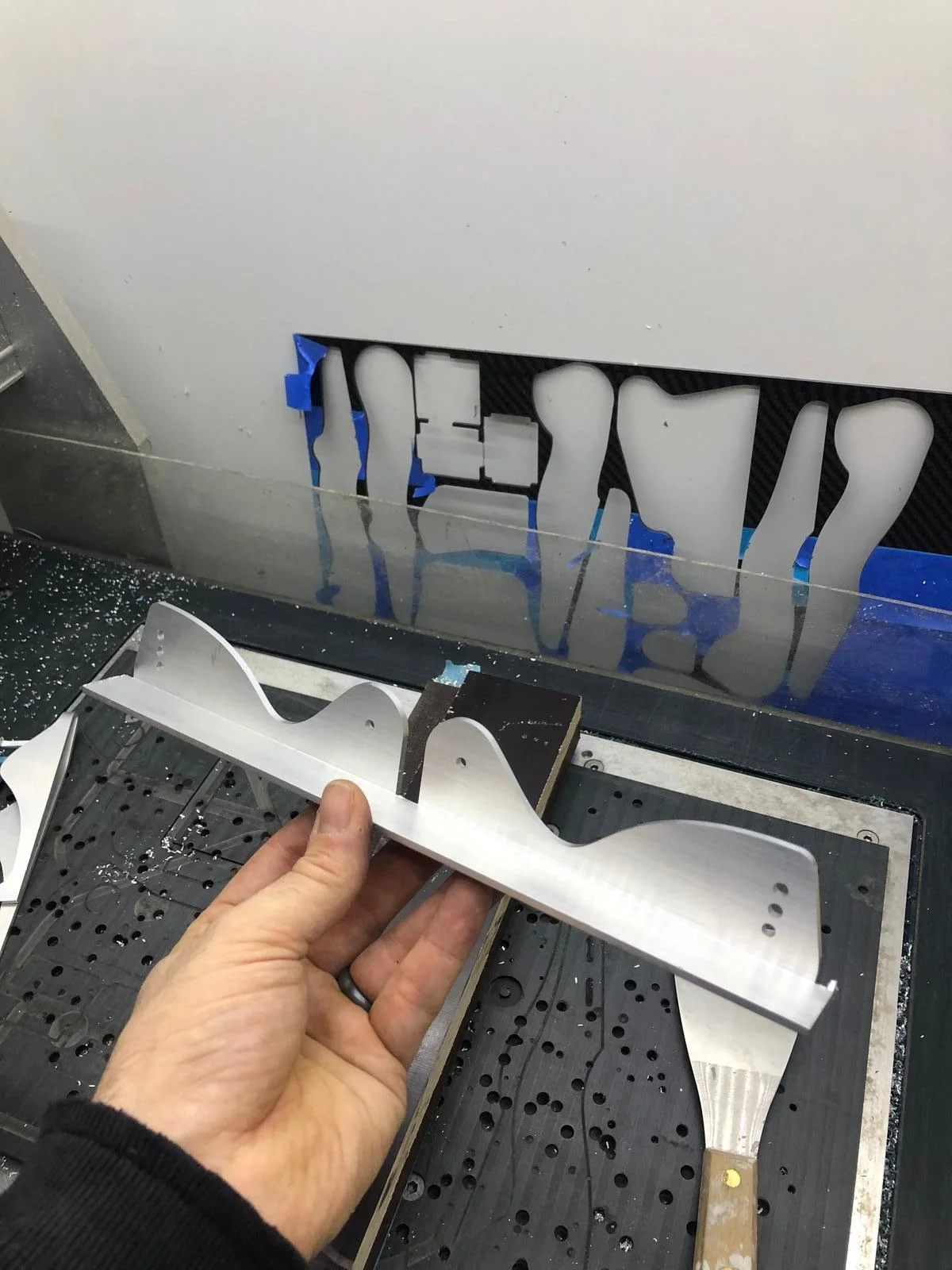

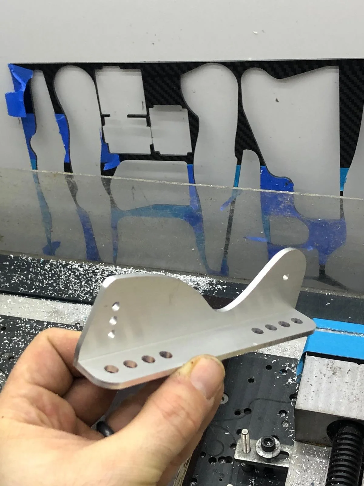

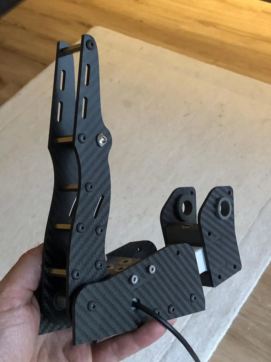

I also got around to machining the side brackets:
Which all takes us to pretty much completion on the brake unit other than machining the few remaining 3d printed parts but there's no rush for that (if I even bother!). I will just need to wait patiently for the proper spring to arrive (the one that fits on the main shaft spring guides), and I need to hook up some wiring for the resonance motor. I also have a better damper/shock arriving at some point too.
Edit - better pics for the last two

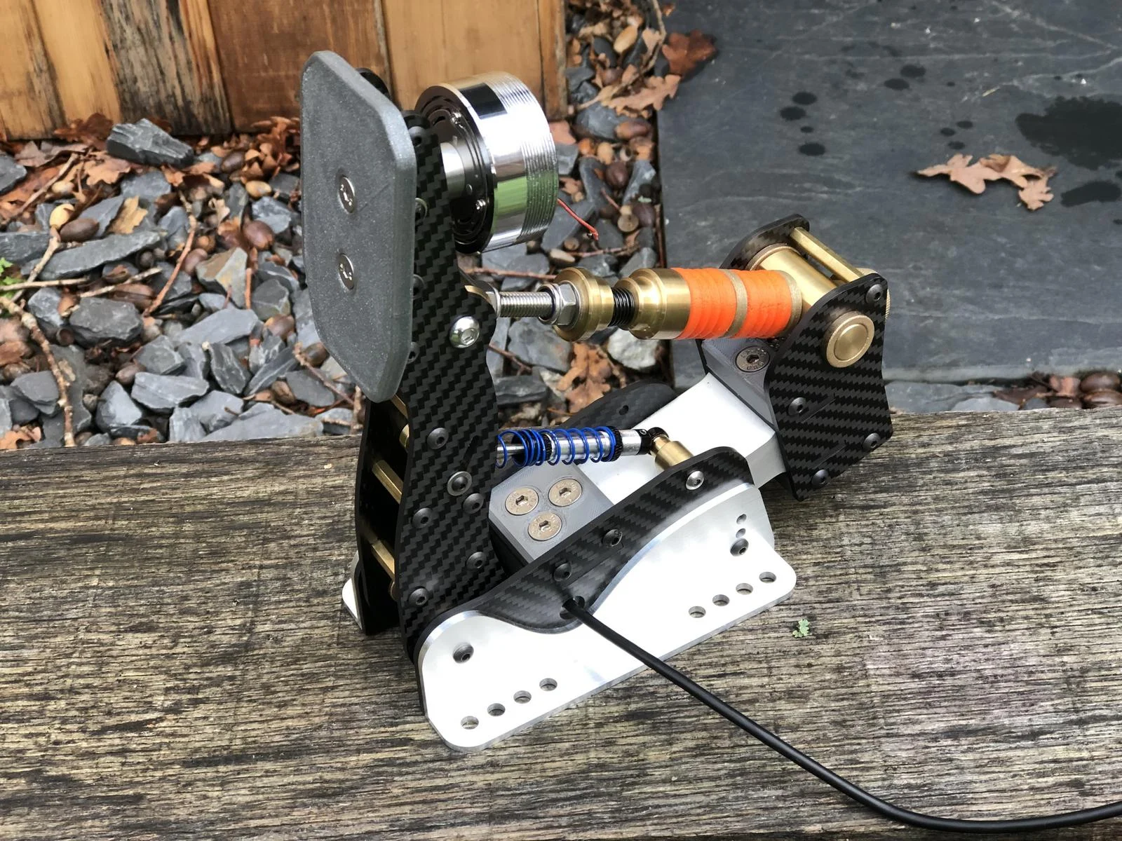

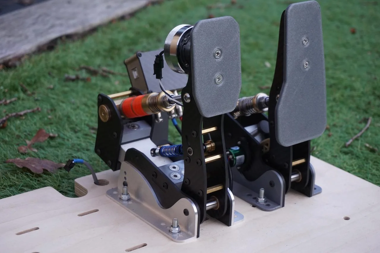

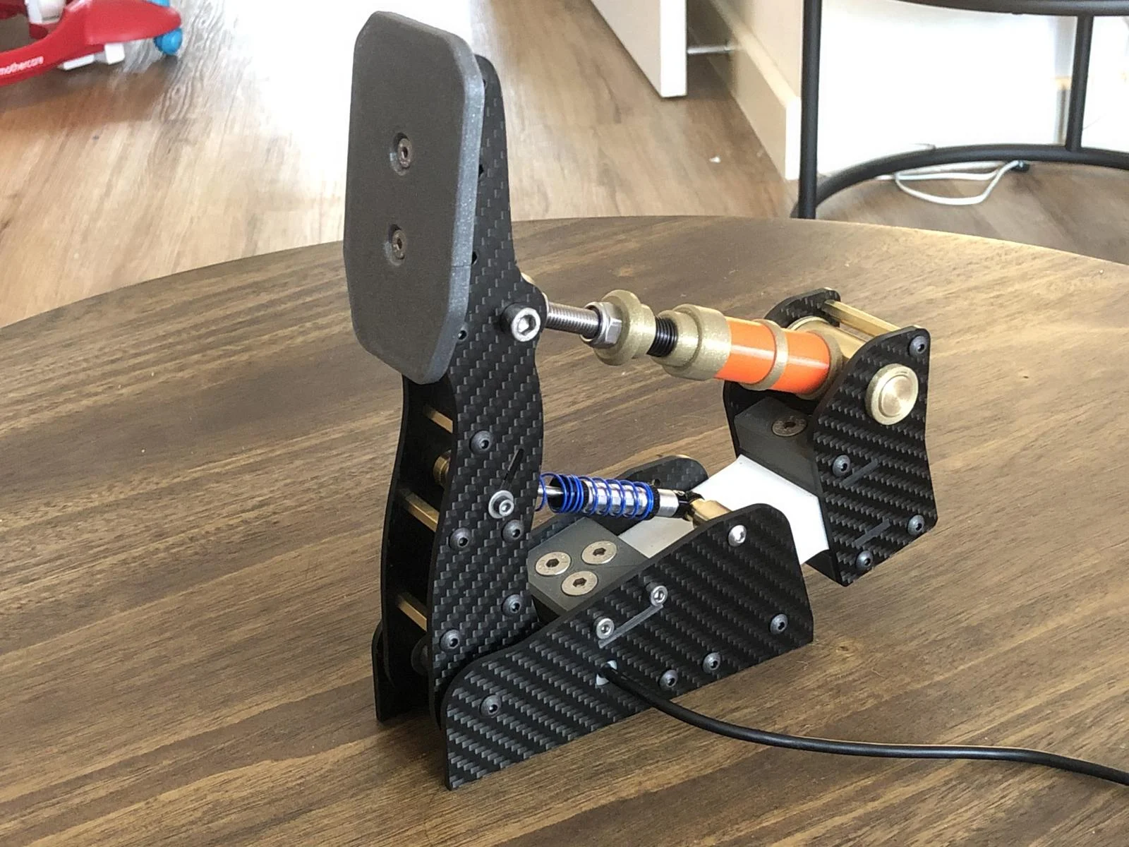

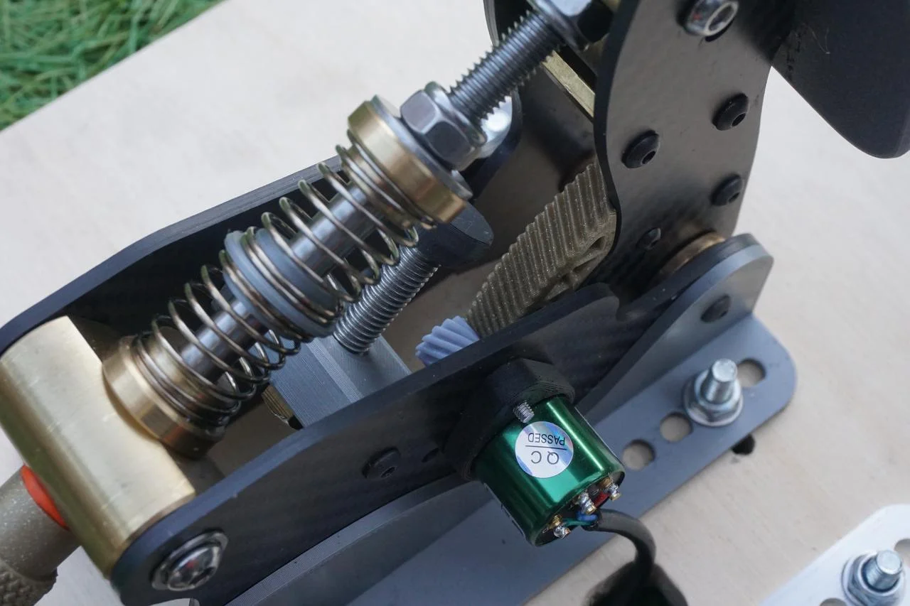

Mostly done on the accelerator pedal now, and I've had it all set up and working, did some racing in ACC and AMS2 and it's all working well. I need some stiffer springs for both the brake and the Accelerator which are on the way but I'm very happy with the compression of the 3d printed elastomers.
Accelerator is still rocking quite a few temporary parts such as 3d printed brackets, thumbscrew etc.

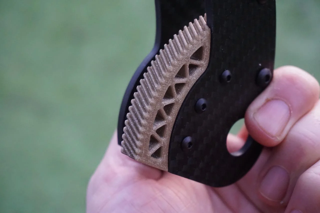

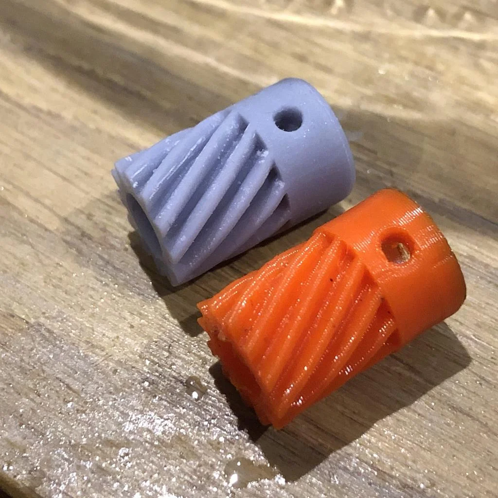

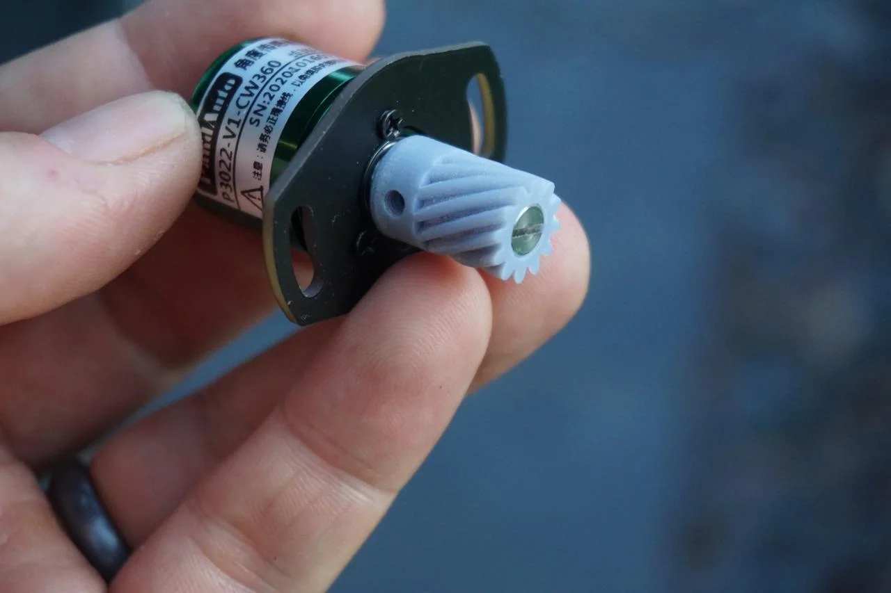

The small pinion gear for the hall effect potentiometer was giving me grief 3d printing it due to the small size and thin walls, so I turned to a resin printer instead. Here you can see the first resin print vs the 5th attempt at FDM printing! (resin in grey, FDM in orange)
and here is the counterpart on the pedal:

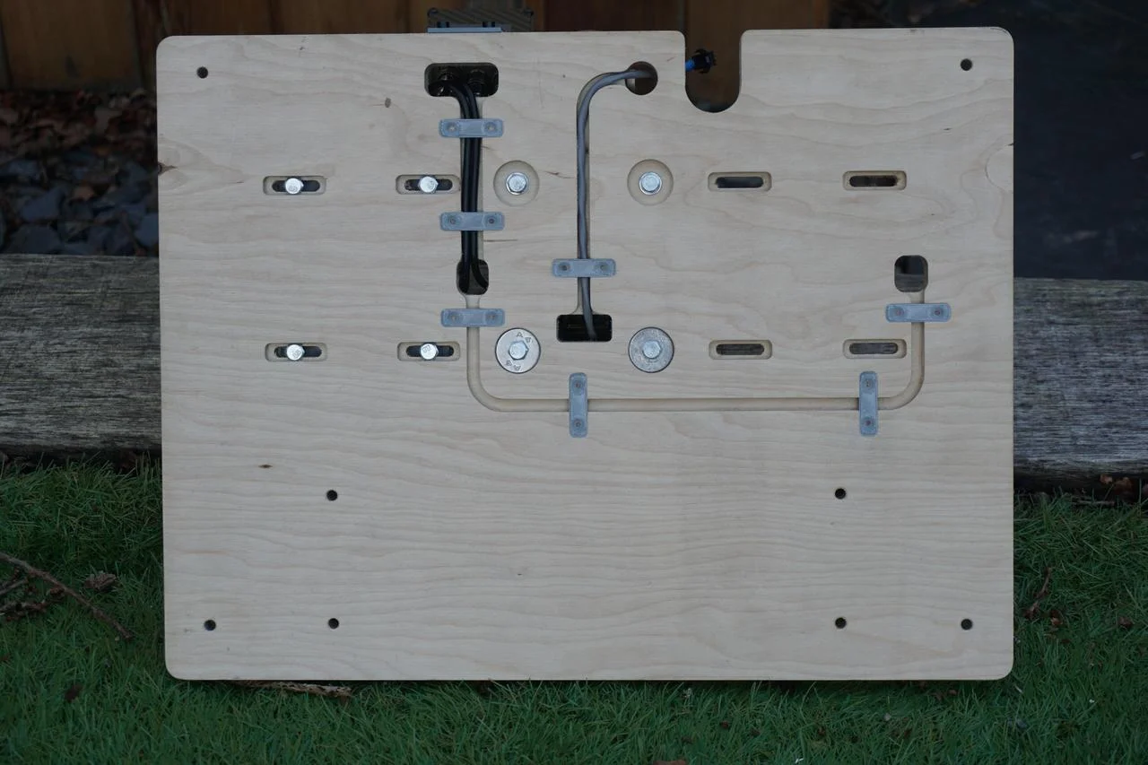

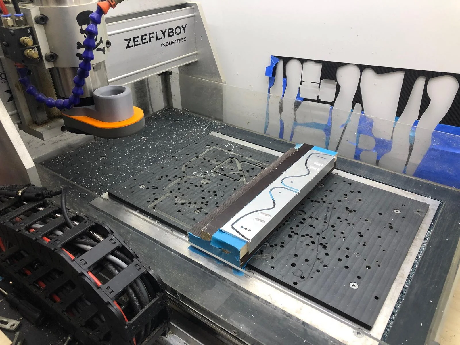

I also got a pedal plate machined out with routing for the wires (including the audio for the resonance motor) to keep everything tidy

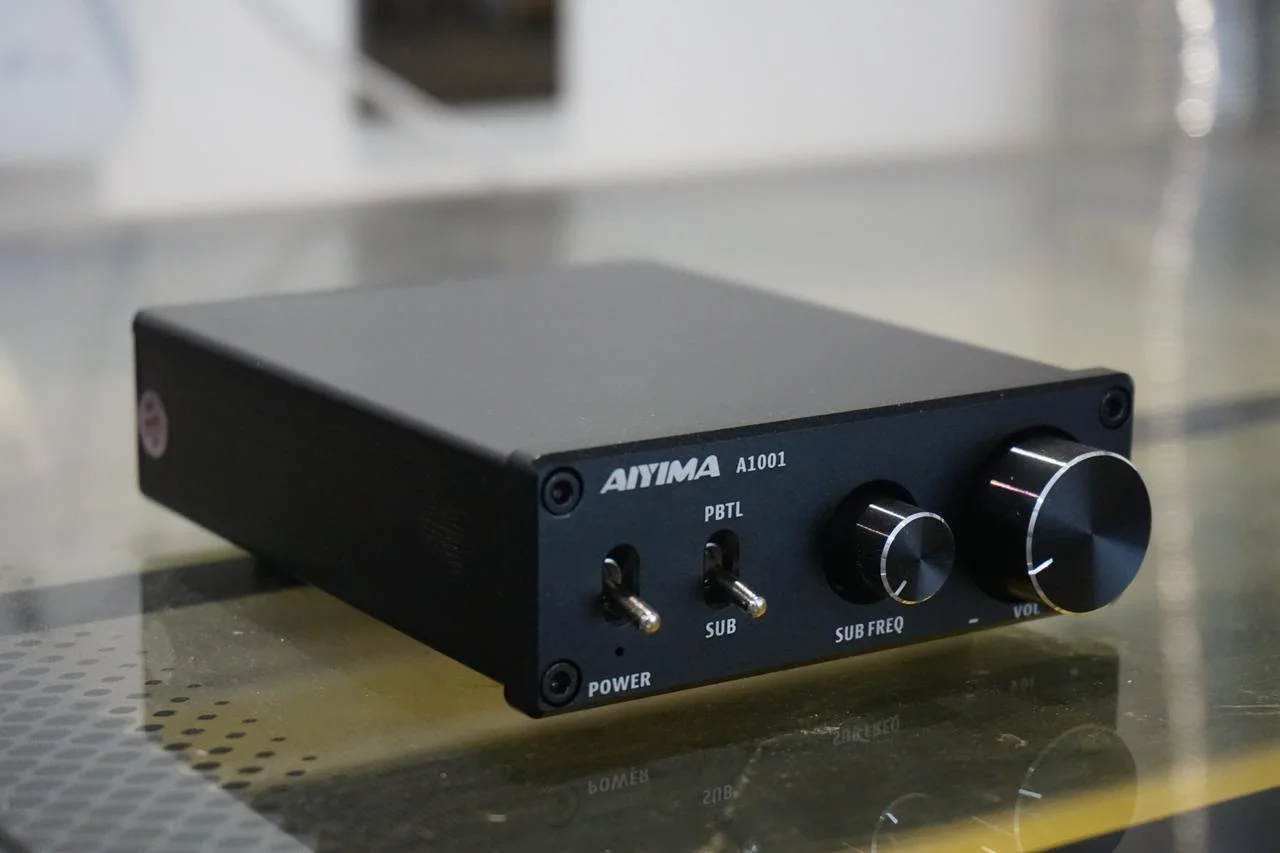

also picked up this little amp which will be powering the brake resonance motor
Most people probably think of what is called an FDM machine when they think of 3D printing where you have a spool of plastic filament being pushed through a heated nozzle... that’s the stereotypical 3D printer you’ll see and by far the most common in DIY.
Resin is another type of 3D printing (of which there are many), which uses photo-sensitive liquid resin instead of filament. There are a few different types but mine has a powerful UV light behind a high resolution LCD screen, under a vat of resin. it effectively displays a picture of each layer on the screen while turning on the UV light which causes the resin to cure where the LCD lets the light through, then the build plate moves up and does the next layer and so on.
It can make incredibly intricate prints, which is why it’s the default printer for guys that are in to their miniatures, but it’s much more of a pain in the arse than an FDM machine.
It's a rabbit hole, have fun!

I really want to add butt kickers at some point, is an amp that size a requirement?
