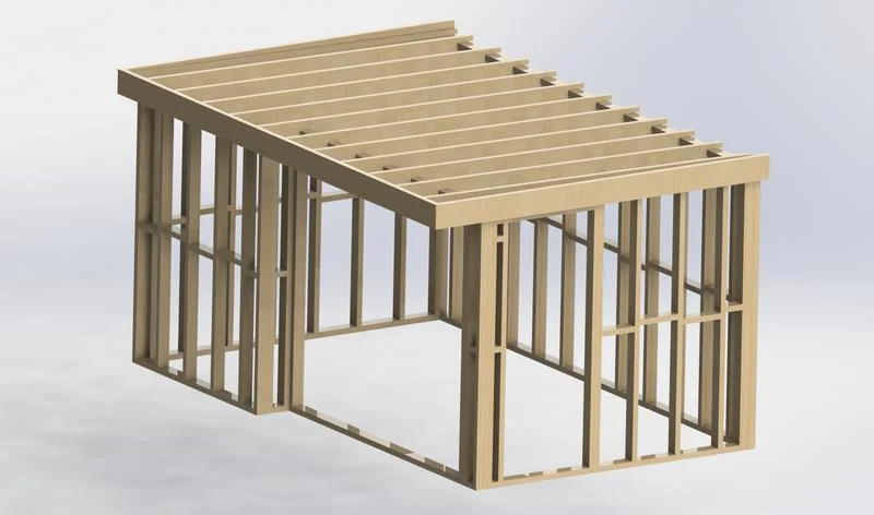

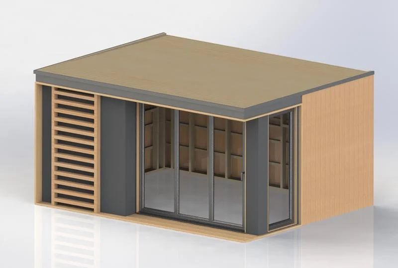

So first things first, I came up with a design. This was the initial design and not a lot changed, just mainly aesthetics around the cladding at the front and I decided to knock 0.5m off the width to preserve my garden - when I laid it out on the ground that 0.5m made quite a big difference to how much it was going to encroach.

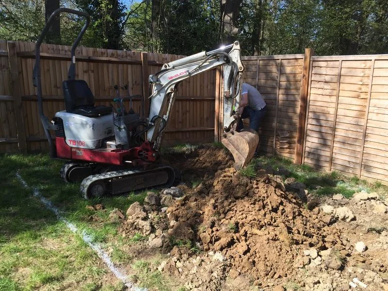

The one who must be obeyed is actually responsible for kicking off this project. She demanded I build the decking out back and so I used that as an excuse for renting a micro digger....

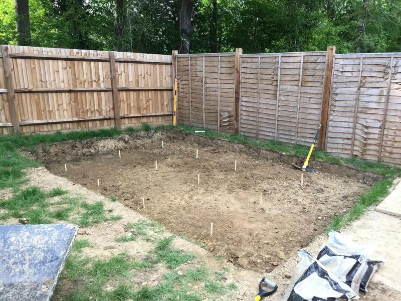

seemed logical to use the digger to start on digging out for the foundations while I had it:
That's a mighty fine hole:

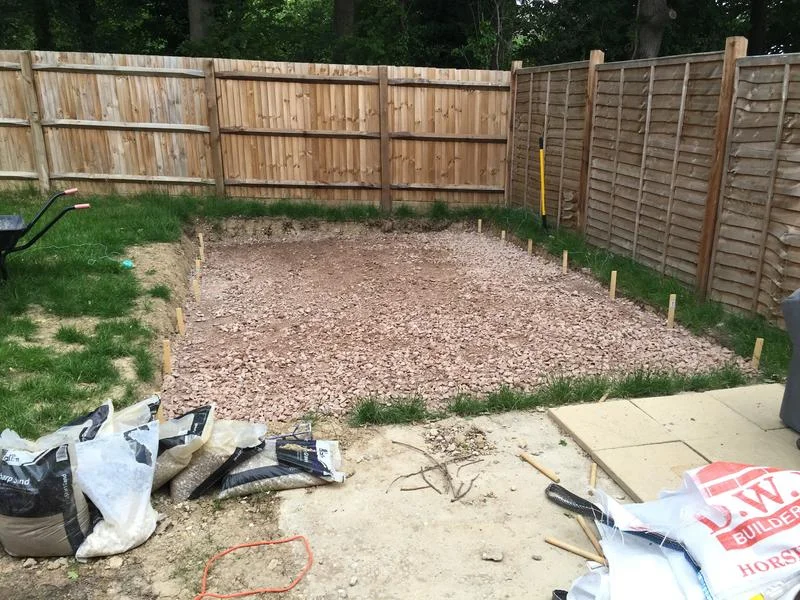

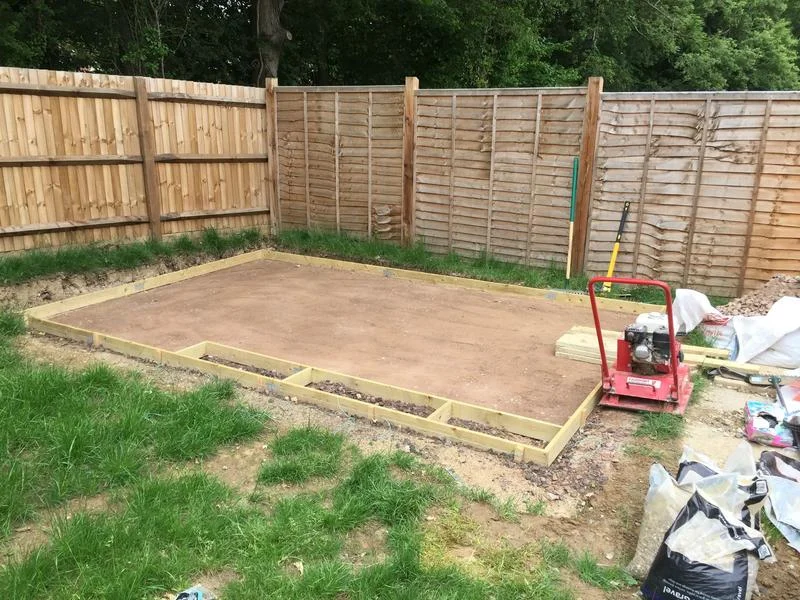

filled with hardcore:
compacted, levelled and build the formers:

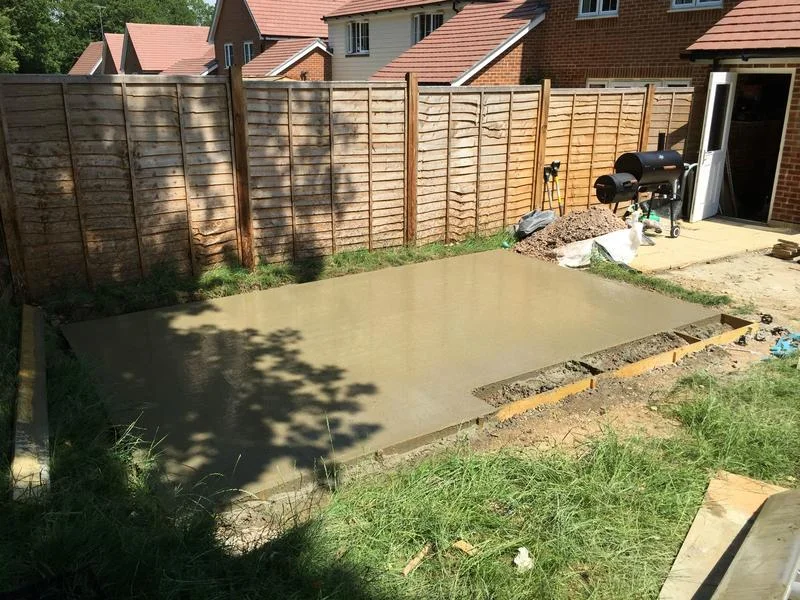

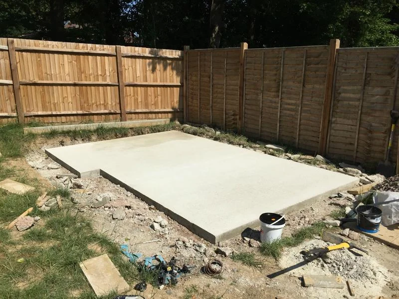

So final bits of preparation before the build could begin - laying the slab!

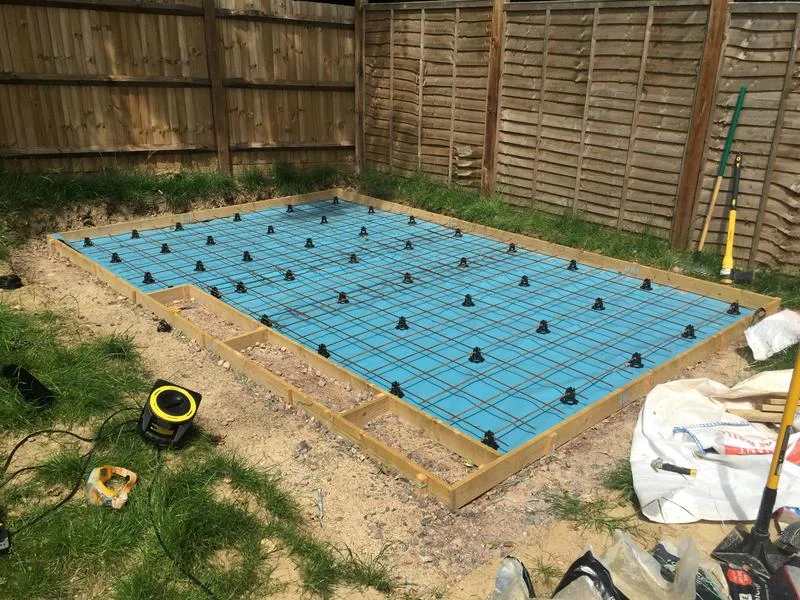

laid a membrane and some reinforcement:
I calculated nearly 4 tonnes of concrete and I decided that I would rather gouge my eyes out with a rusty spoon than haul and mix that much concrete by myself. I found a company with a volumetric truck that quoted me about £250 so went with that... only downside was that it's too small an amount for a concrete pump and there was no access so all near 4 tons of it had to be wheelbarrowed through the garage. That was tiring!

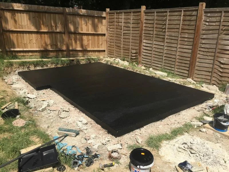

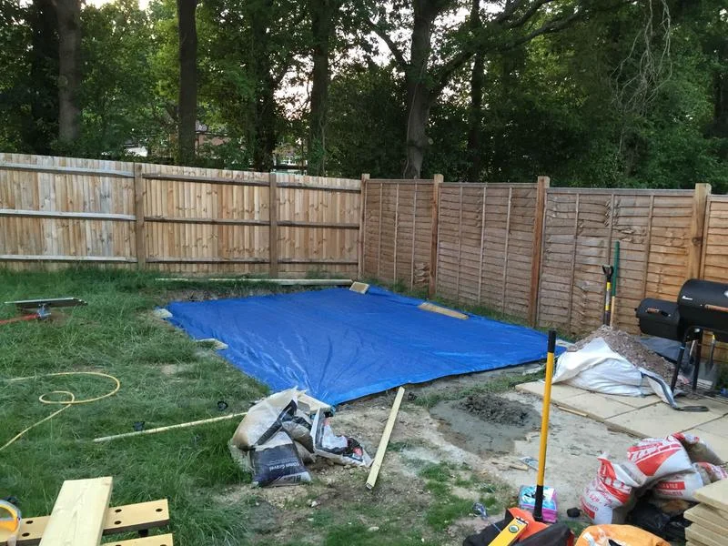

Covered it all up and let it cook off for a week or so
And then removed all the formers and gave it a couple of coats of liquid damp proof membrane:

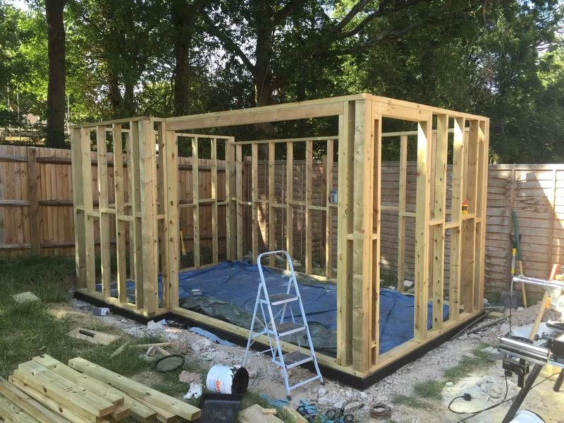

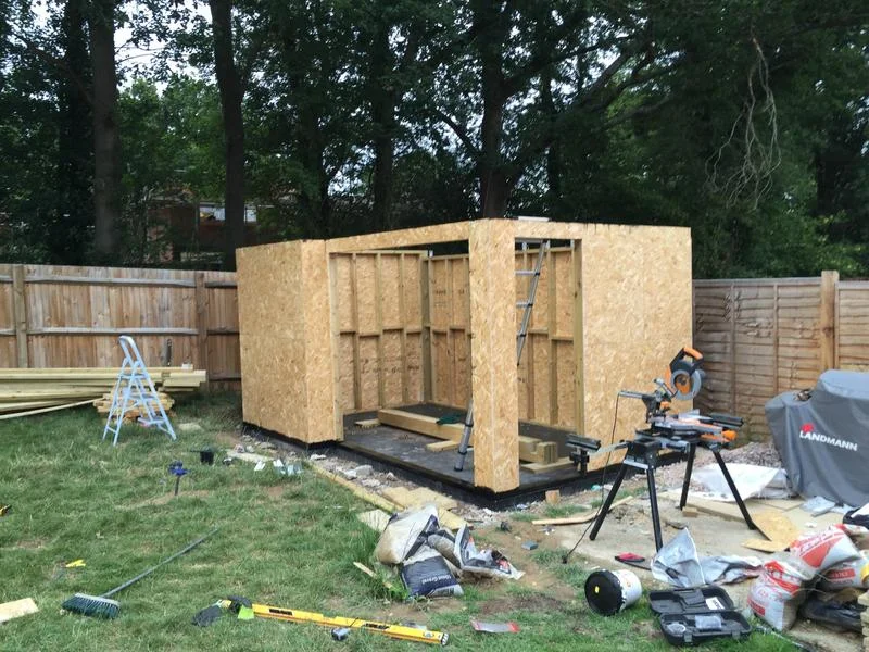

Ordered some treated timber to start building the frame, and I was pleasantly surprised that I managed to build the entire basic structure in about a day and a half.

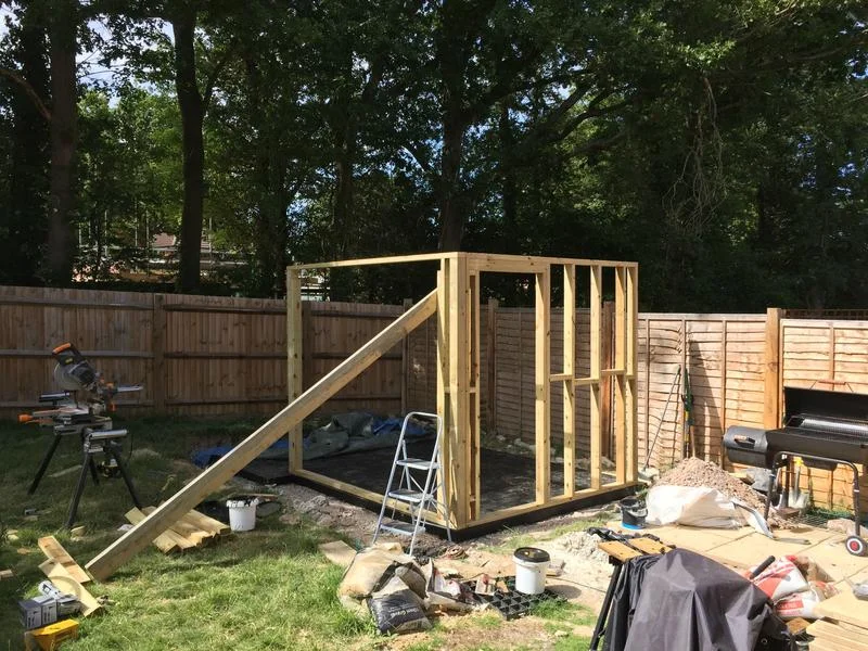

First side wall built:
I had to get a bit creative with supports to hold it up since I only had one pair of hands:

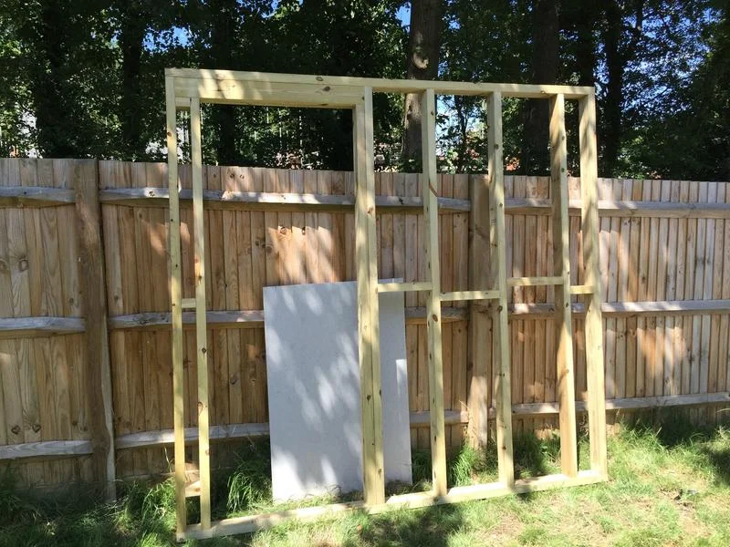

So after just over a day's work of cutting wood to length and screwing it all together I ended up with this:

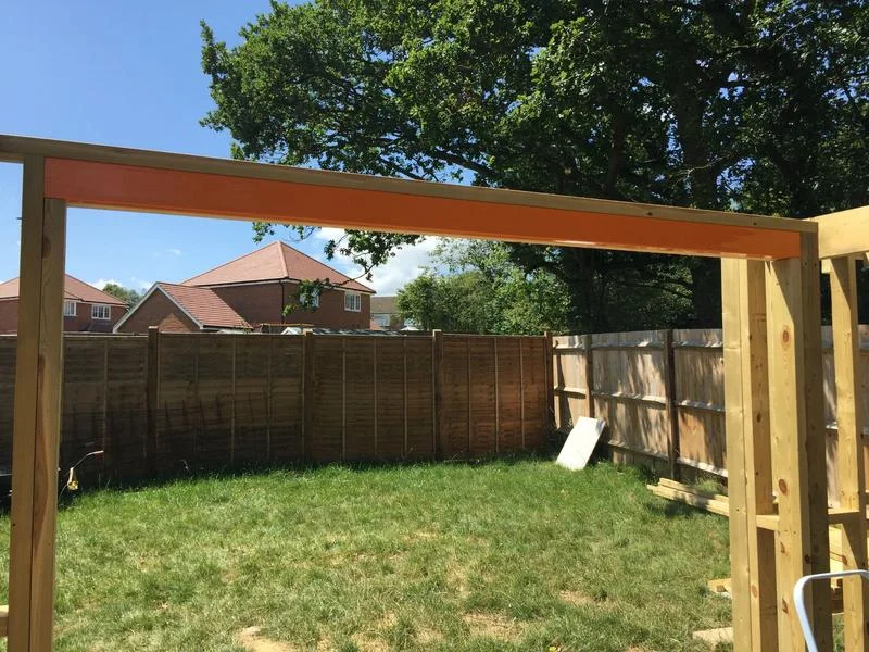

I then put a steel box section across the large span instead of a second piece of wood for extra strength:
Another day's work (in hindsight, get your hands on a nail gun for this. The cramp I had in my arm after hammering these in all day was nasty!)

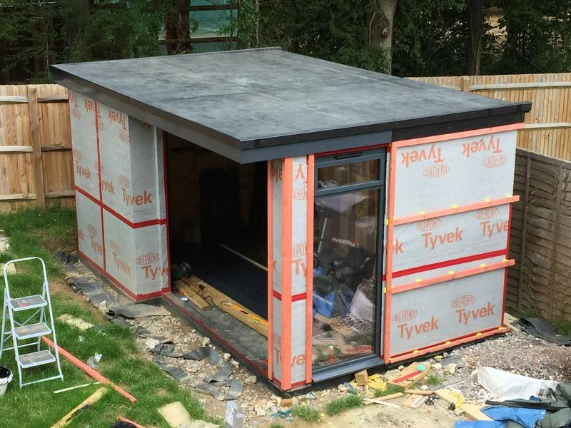

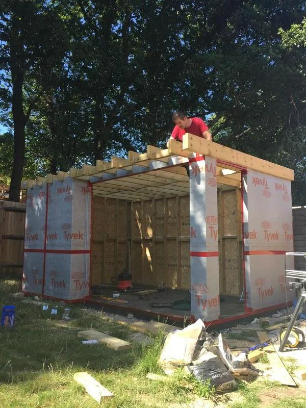

Then covered in tyvek membrane (a breather membrane that stops water getting in but lets the wood structure breath) and put the roof beams on... The other half got home in time to avoid having to help me lift those big roof beams up, and instead took a photo:

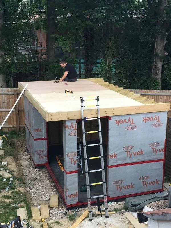

18mm ply for a super strong roof...

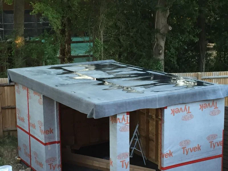

For the roof I decided to go with an EPDM membrane... seemed the most foolproof option and supposed to last 60 years or more.
This wasn't too hard to fit, just be sure you know the process and what you're going to be doing before you start because once you've laid the glue it's too late to be figuring stuff out!
Fitted and a quick sprinkle with a hose to make sure there's no leaks:

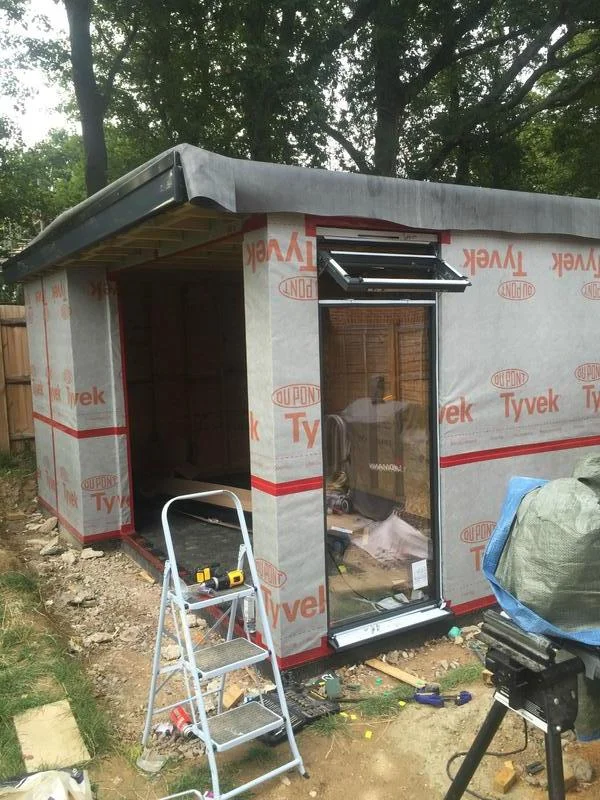

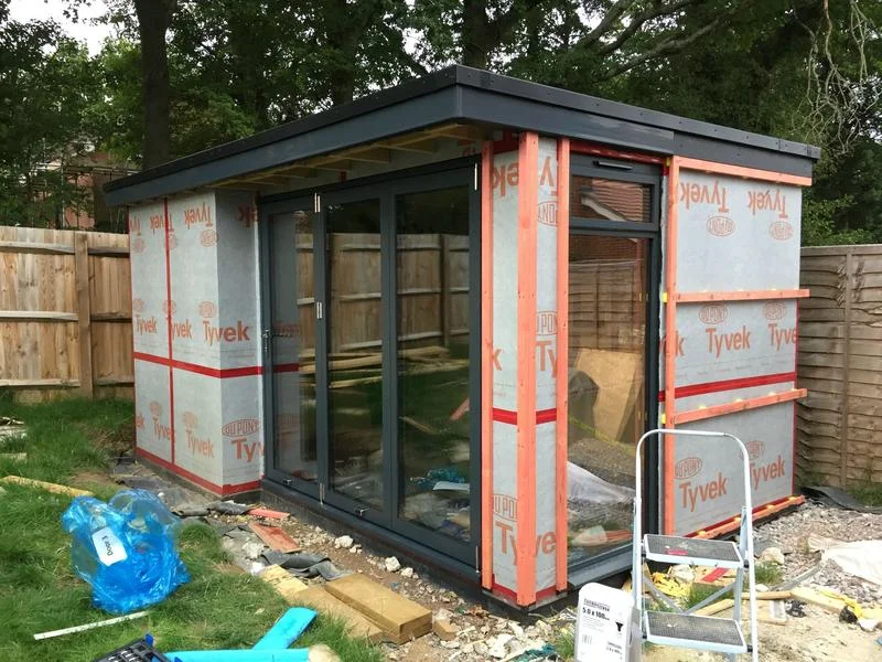

in the mean time my window turned up. I ended up custom ordering this as I couldn't find any stock sizes when I was doing the design... cost about £450 and it's double glazed plus thermally broken aluminium frame. Was quite easy to fit, didn't really know what to expect given that've never installed windows or anything before.

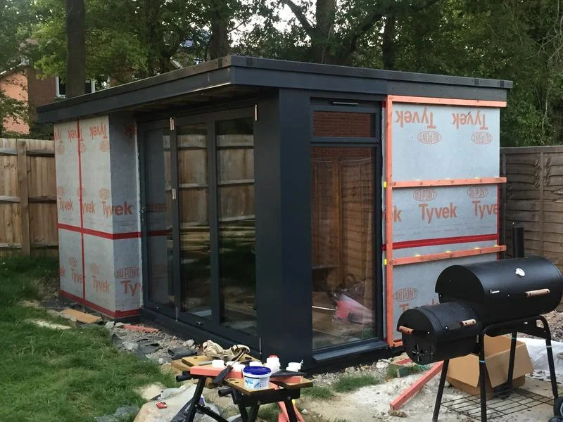

So the window installed and roof edges finished and tidied up, and I also made a start on the battens for the rain screen:
Fun fact for if you decide to do one of these, ideally you should have the battens either running vertically, or spaced away from the membrane so that there is room for air to circulate and so that water won't get trapped against the membrane by a horizontal batten.
I would have liked to just use vertical battens as the spacers for the horizontal, but I needed my cladding to line up with the roof and couldn't find any treated battens the right thickness, so I ended up printing my own special spacers out.

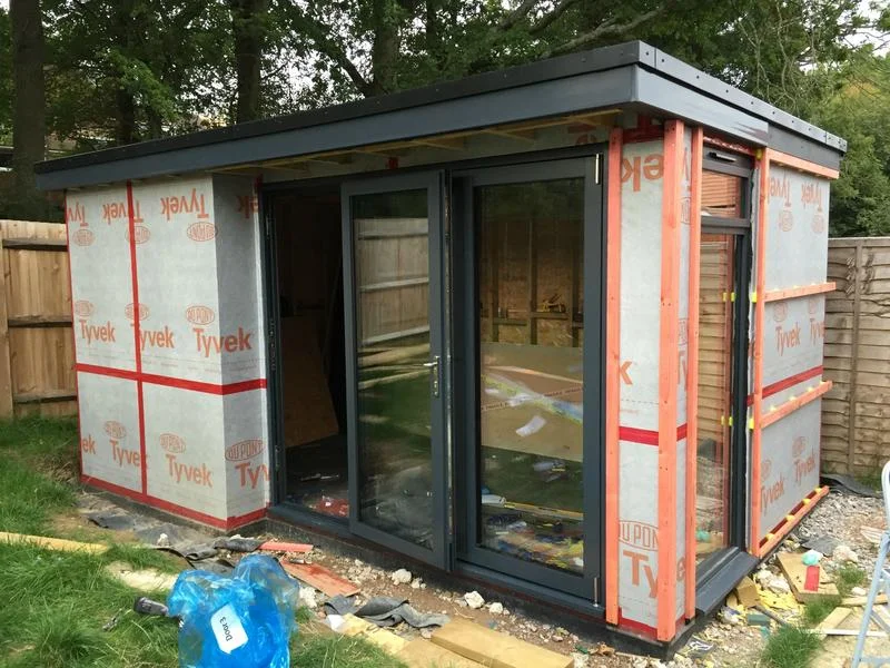

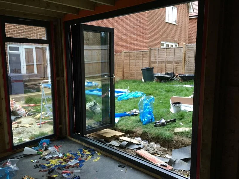

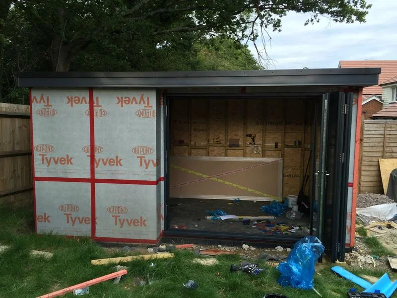

So my big triple glazed bifolding doors turned up and my friend that was supposed to help me with them was unfortunately no longer available.
I was really really stupid and decided to fit them by myself... I came SO close to smashing one as it nearly tipped over during fitting (each door came triple glazed and balanced already, so they were about 70kg each. I can't say this enough - don't try and do this yourself, I got lucky!
Anyway, got it all assembled and they worked without binding which was nice... there's not a lot of tolerance on these things so working accurately when building the wood frame is important.
These were the most expensive thing of the whole build (in fact they account for around 1/3rd of the final cost) but I think they were worth it.

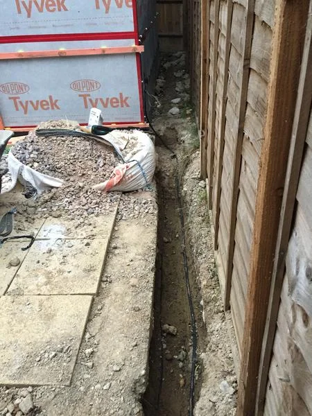

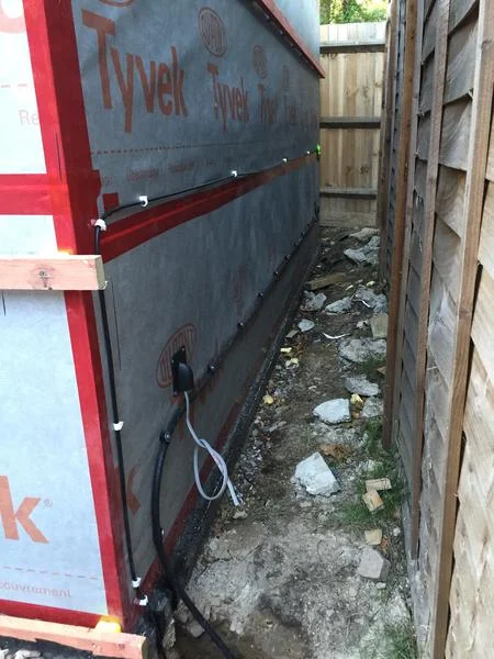

Now the one part I didn't want to do myself is hook up to the mains... I'm happy doing the basic wiring of sockets etc but there's no way I'm messing around in the consumer box. I had a sparky over to put in the armoured cable and a small breaker unit in the shed.
Dug a big old trench:
Cables going in (smaller cable is a cat6 direct burial cable)

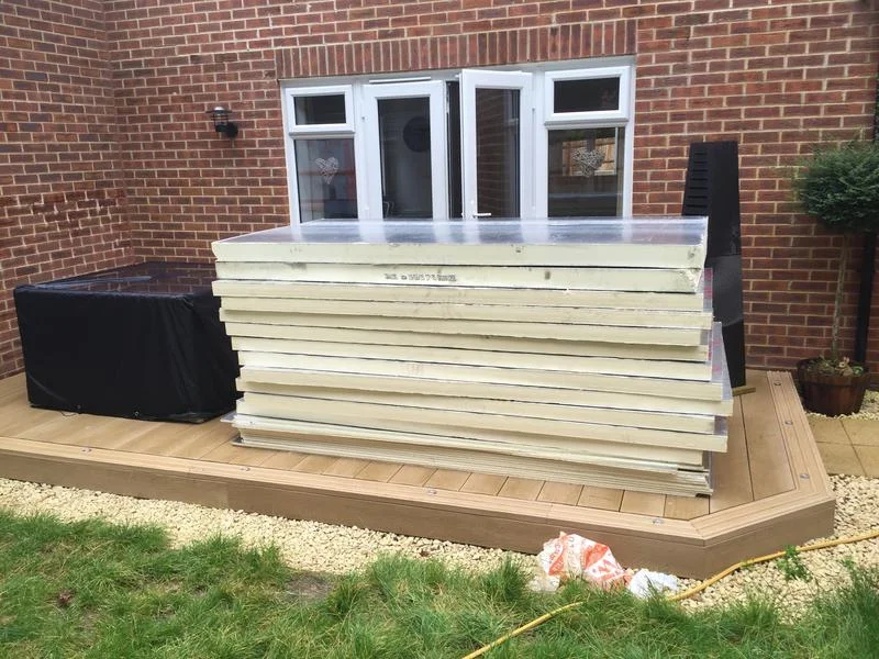

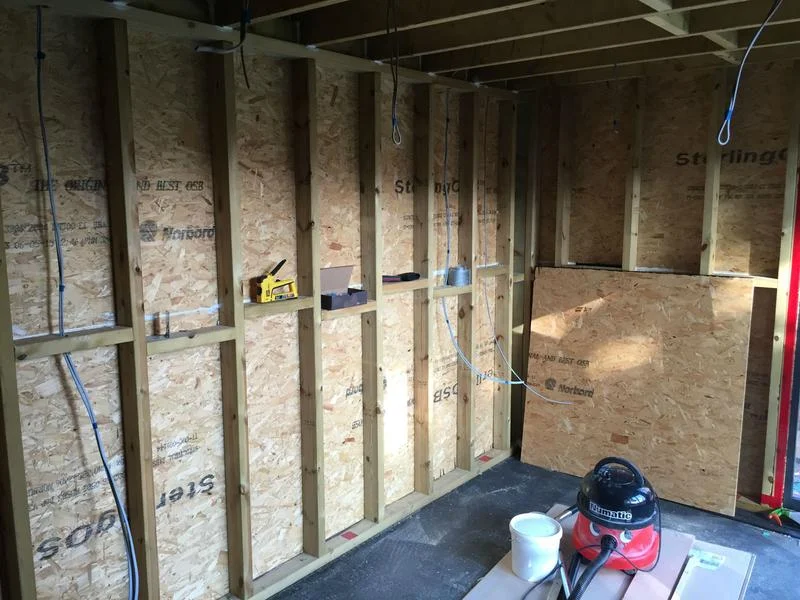

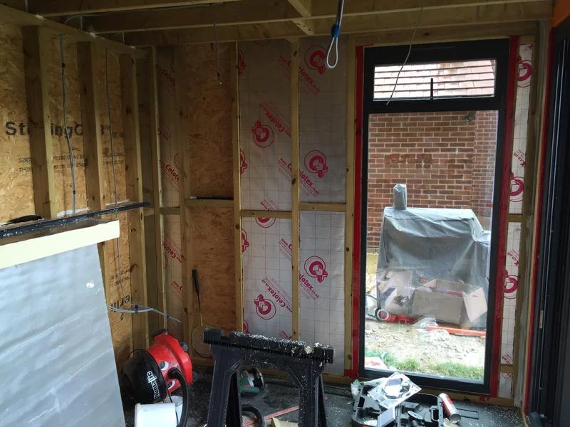

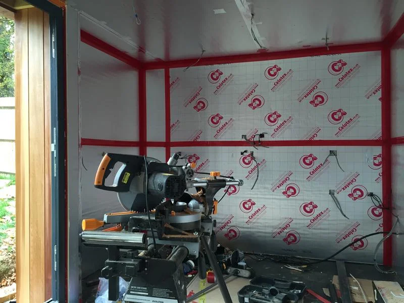

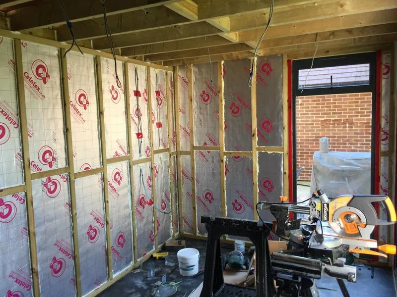

and then the insulation arrived:

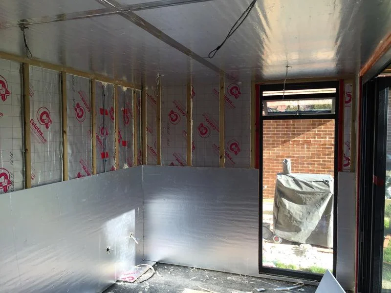

So started insulating...

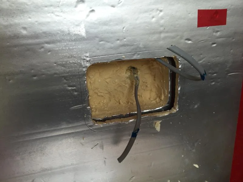

I think in hindsight I may have gone with high density rockwool between the battens and topped with celotex. Less thermal performance but better sound insulation, cheaper and much easier than cutting all that celotex to shape.
I decided on 75mm between the battens (leaving a 25mm air gap) and then a covering coat of 12mm over the battens to reduce cold bridging. For the Roof I went with 100mm between the battens (which leaves a gap below the plywood for ventilation) and again 12mm under the battens to stop cold bridging.

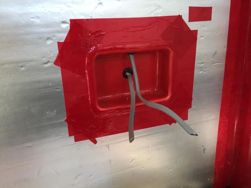

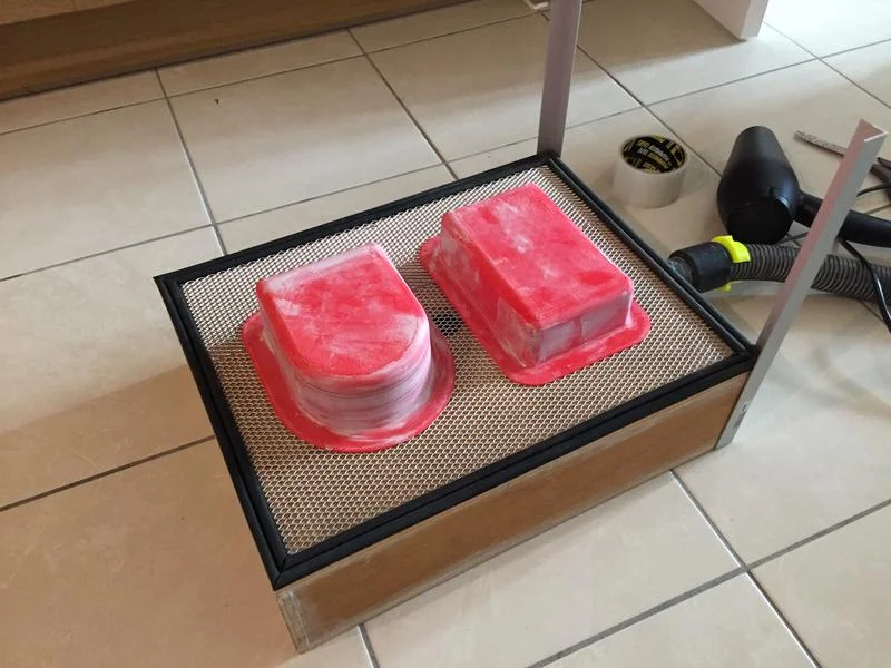

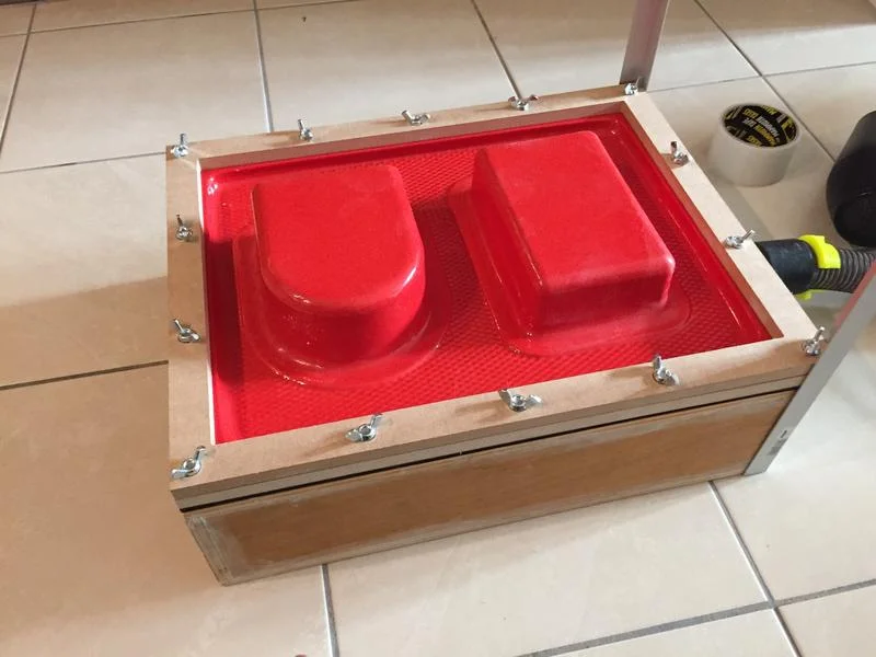

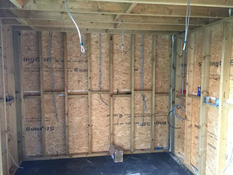

So one thing that I struggled with was figuring out how to keep the vapour barrier intact around sockets etc..
In america its easy to find air tight boxes, but they don't really exist over here.

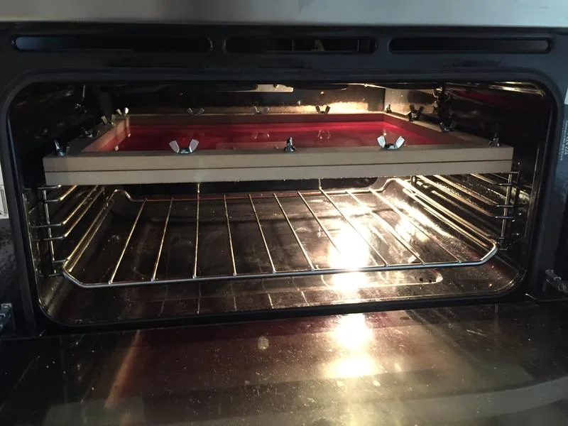

I built a small vacuum former a while ago so I decided to print out some plugs for that and make my own boxes
And this is how they get installed:

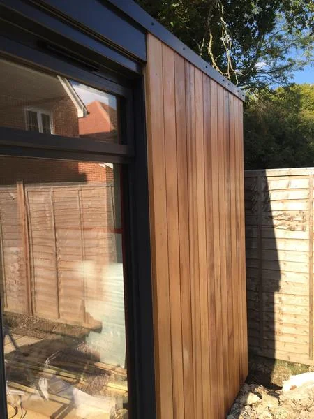

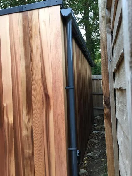

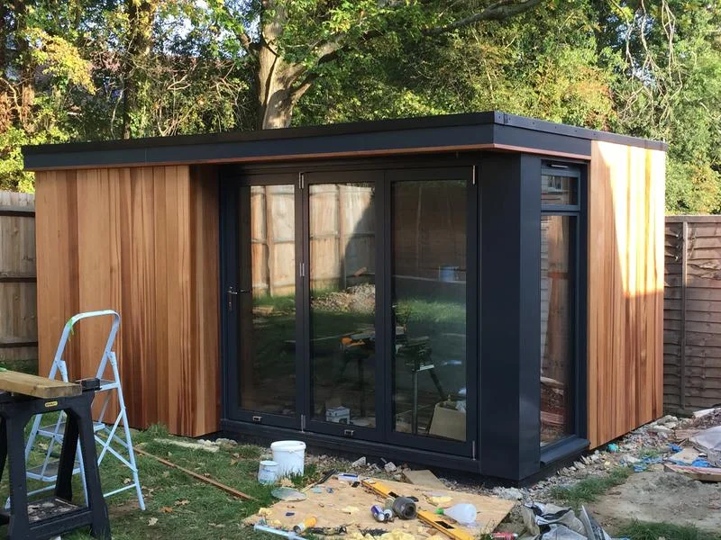

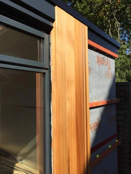

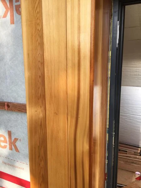

Got busy cladding in western red cedar... another fairly expensive part of the build but given it determines the entire look of the thing I didn't want to cheap out here.
I love the colour of fresh red cedar so I treated with a UV protecting oil by Osmo - should stop it from silvering too much.

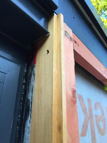

I got a bit creative with a router to make my own corner joints - I didn't like the commercial designs I've seen which just cover the corners with a square edge
And eventually got the cladding finished. I also decided to replace the soffit material I had used with alupanel along the roof line - gave a much cleaner and sharper finish, much happier with the roof edge like that.
And fitted my colour coded guttering... ooooh yeah, bet you didn't know gutters could be sexy.
